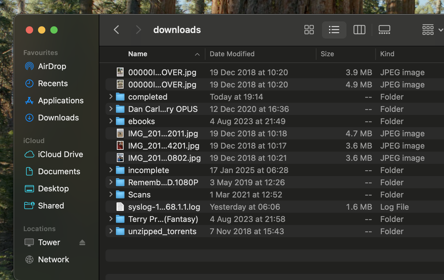

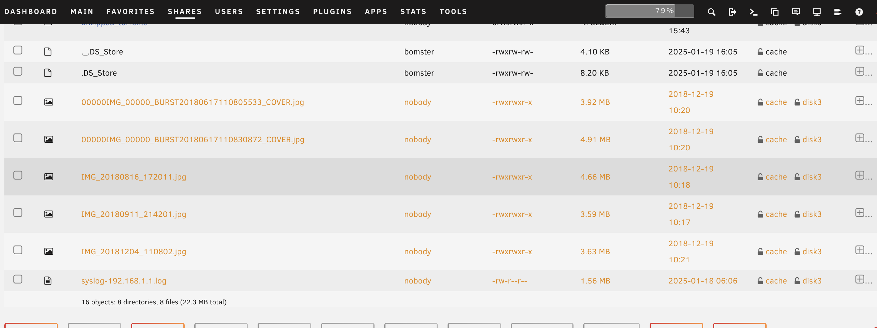

Loads (read: most) of my files are now showing as existing on both the array and the cache? Examples shows in screenshots.
Am I safe to stop the array and reformat my cache drive?
and

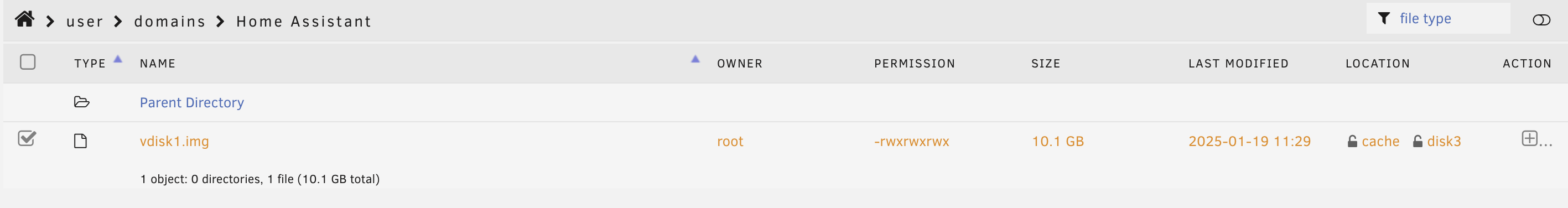

Hey thanks for the help. Docker and VM Manager have both been disabled all day whilst I've been troubleshooting.

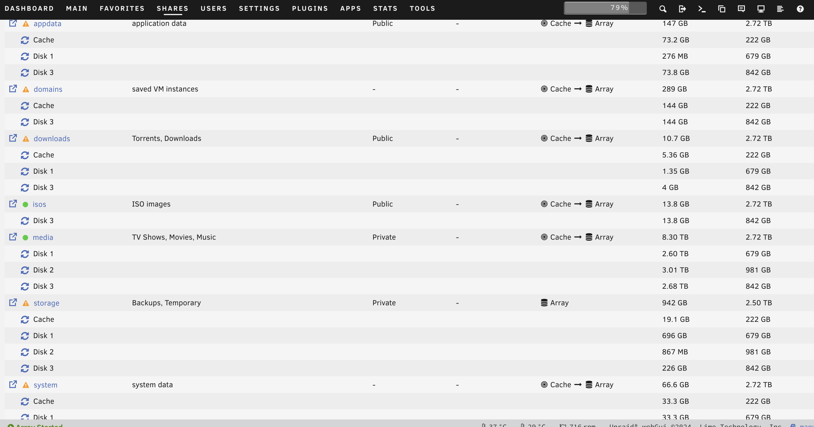

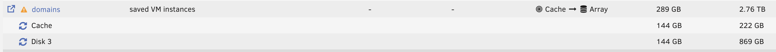

Some more example screenshots attached, as I realise now screenshotting the VM folder and Docker img was a bit a bad of example!
Look how the file size on the cache more or less perfectly matches up with the file size on the disks.

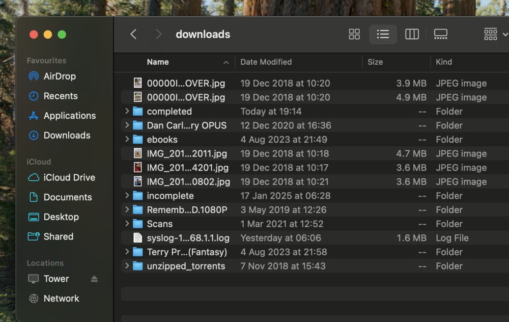

Well I assume it's related to my (potentially) corrupt BTRFS cache disk. And again, they are not really duplicated, case in point:

None of your screenshots are letting us see the duplicates.
Instead of looking at the User Shares, browse to disk3 and to the cache pool, and find the user share on each.

So in the example I've been using for Downloads, I find the same file paths and files in both cache and disk3.
So what can I do next? I believe my cache drive is corrupted, so I've tried to move all the files off it so I can reformat.. now mover is complete and I have duplicates of virtually every file that was on my Cache.
I am no expert, but I guess this is because my cache is corrupt so there is some type of error for Mover, like it's moving the file successfully onto the array as I've asked, and then when it's finished moving its failing to remove/delete the file off the cache (like it's in a read-only state). Therefore I end up with the file existing on the array, and also still on the cache.

If you are satisfied that all the files you want to keep are on the array, then you can proceed. Make sure you check appdata, domains, system shares in each.
