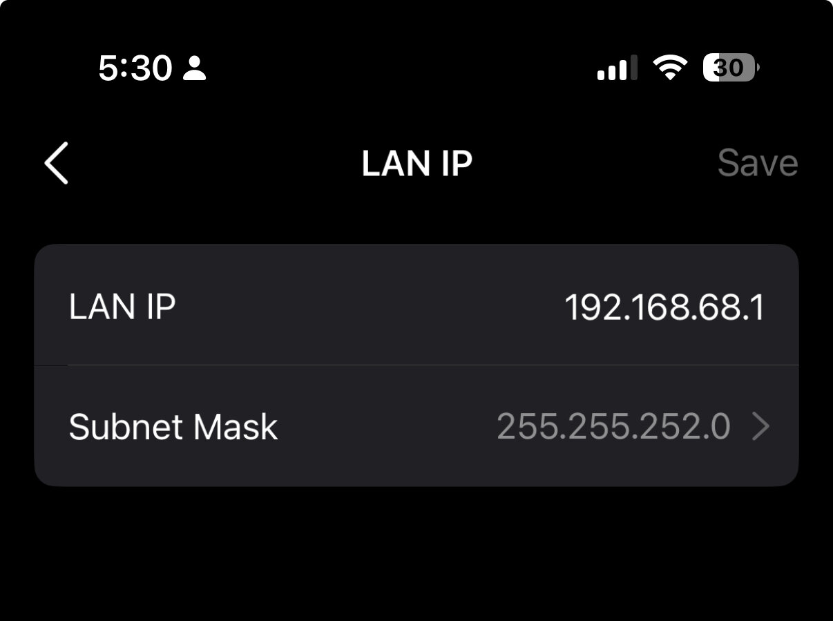

I keep getting ips on the 169 range which I can't access. Deco doesn't even see a wired device on the network. I can confirm subnet is 255.255.252.0 in my deco settings. it should be anything fancy of a network, its fios ethernet plugged right into the DECO.in my deco router settings IPTV/VLAN is set to disabled, lan IP is the one im using for gateway, and subnet confirmed 255.255.252.0

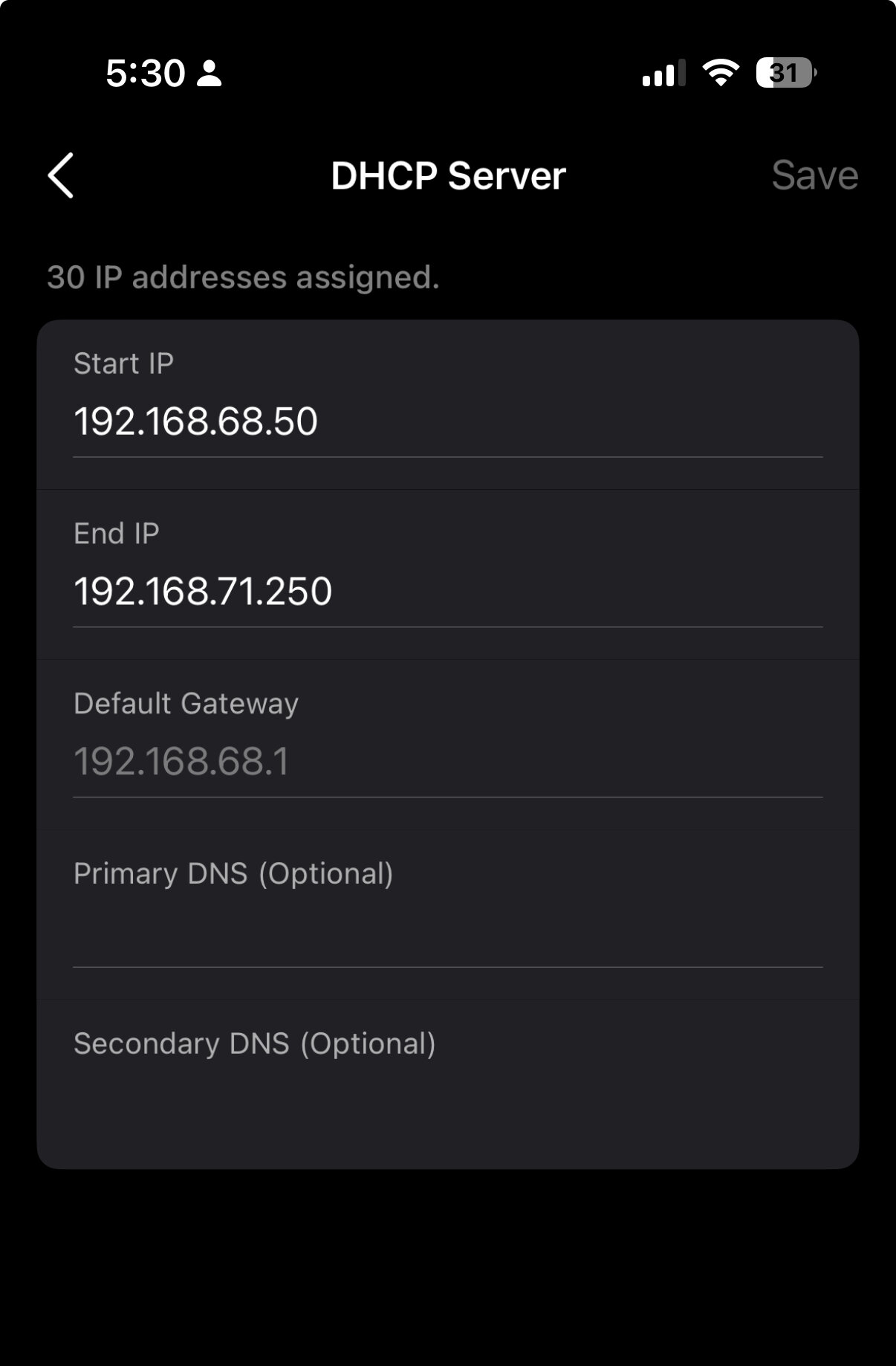

Looking close at the dhcp image above... I see start IP 192.168.68.5 and end IP 192.168.71.250   That 3rd octet don't match.
Yep, I see it now.  NM that part.
Edited by Veah
