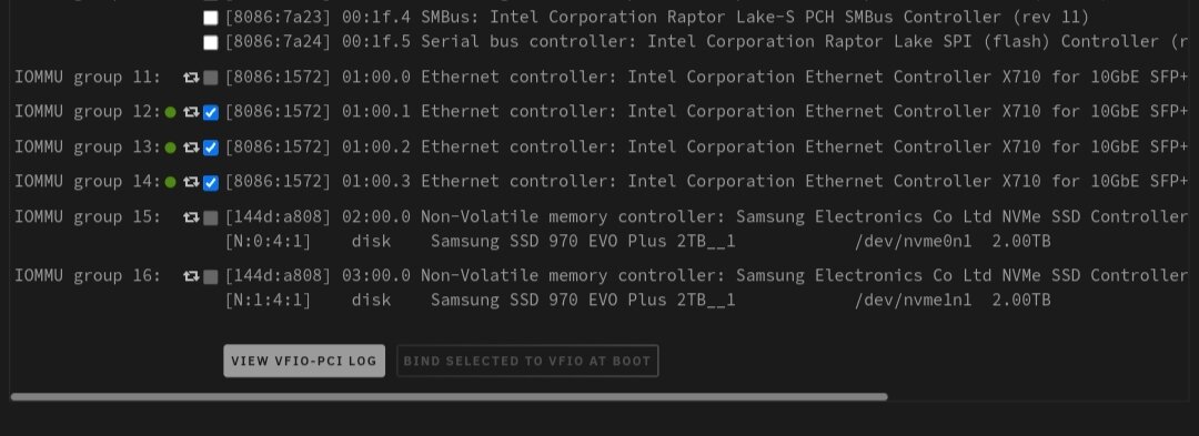

Tools > System Devices
Checking a box and hitting the bind button is where you pass through devices that you could use for VMs.  It requires a restart to make active.
Mine looks like the attached where the 3 checked nics do not show up under my network settings, only the greyed out one does.IMG_20250124_060218.thumb.jpg.03e1680007d9d93d3c129541ebf022a3.jpg
@Veah - You are my hero - That did the trick. Thanks a mill - Now my 10G Nics are Eth 0 and 1
