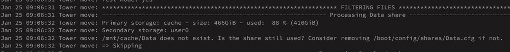

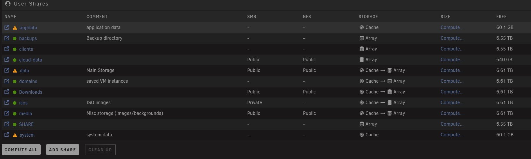

hey everyone! been loving unraid over the year and was excited to see the public release of unraid 7. Been having an issue since though that my cache drive never clears now.  Mainly my data folder. I did notice that it skips my data folder but it capitalizes the "D" so not sure if that has something to do with it (all the main folders are labled lower case and in the logs they are capital)

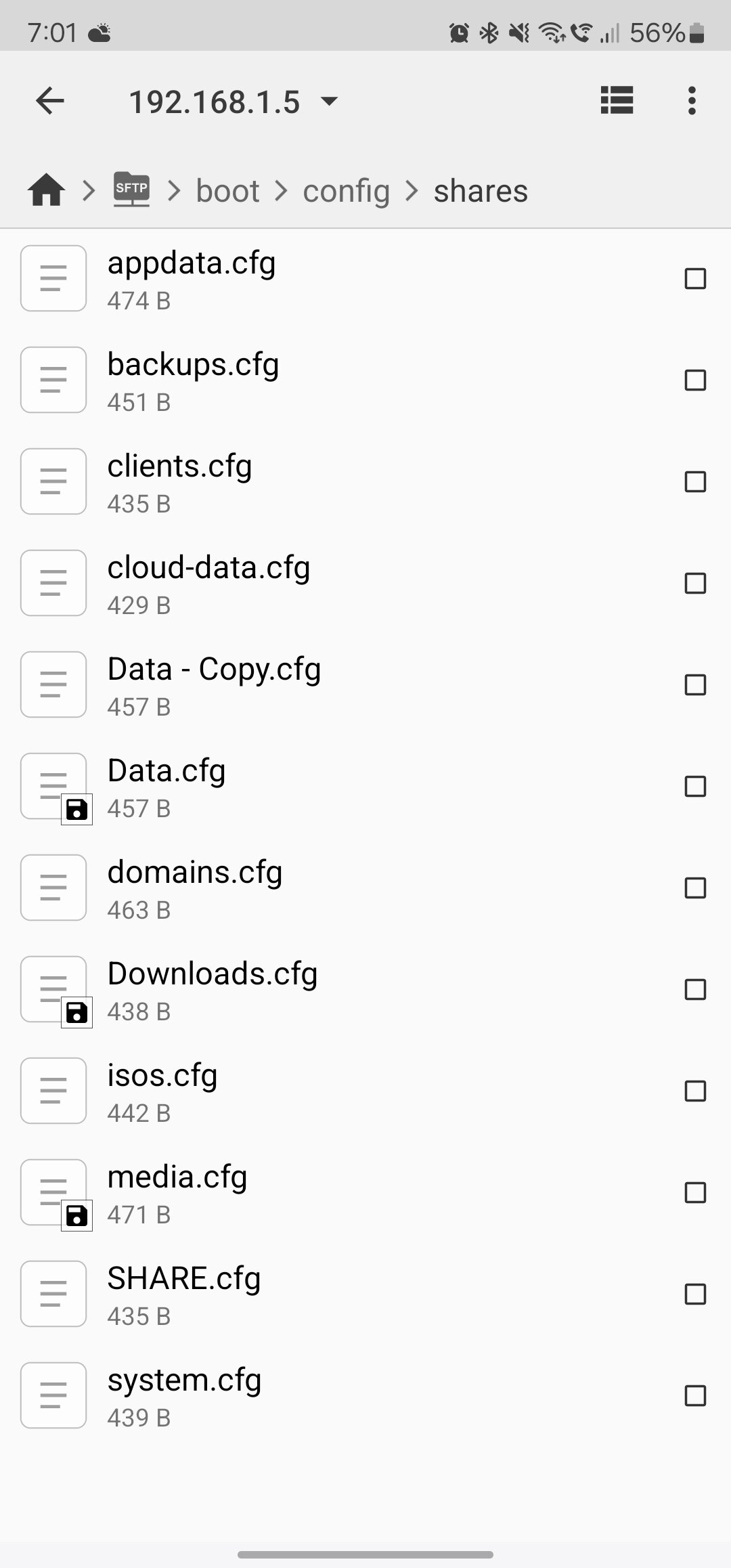

What about the data folder too? In the share folder I have a Data.cfg but in unraid it's all in lower case? I was going to test shortly and see what happens haha

You do not want to touch the data folder on your drives.
Do you not have both a 'Data.cfg' and a 'data,cfg' file in the shares folder on the flash drive (which is what the diagnostics suggest)?   To avoid potential problems you want only a share configuration file that uses exactly the same capitalisation as the data folder.    In the worst case if you accidentally delete a sharename.cfg type file that corresponds to the name of a top level folder on you drives then Unraid will recreated the configuration file with default settings.
If you have two data folders on your data drives with the same name but different capitalisation then this a different issue and you should ask for advice.

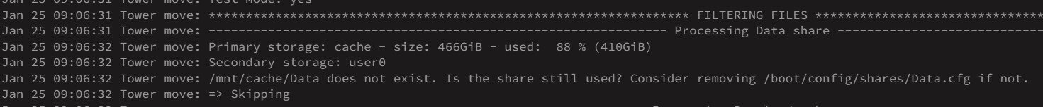

as per the screenshot from my phone above, i sshed into unraid and what you see in the /boot/config/shares folder is present. I dont have a data.cfg but have a Data.cfg file. i created a copy of the Data.cfg, was going to stop the array and change the Data.cfg to data.cfg and see what happens. In one of the original screenshot from the top when i had mover tuner installed it said the same thing: "/mnt/cache/Data doesn't exist" Really confusing

Data.cfg
Delete this one from the flash drive, then re-apply the setting for the data share, and a data.cfg will be created.

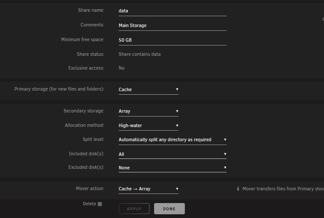

Thank you all for your help! Managed to get it working again. Did what you said: created an smb share to the flash drive, deleted the data.cfg file, went into the share within unraid and applied settings. It did default settings meaning it was only storing it on the array so just changed the primary to cache and secondary to array. working without the tuner too :)
