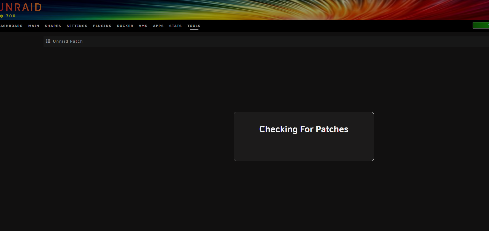

February 1, 20251 yr This screen never updates or goes away. I also have the mover pluggin, so maybe this is why?
