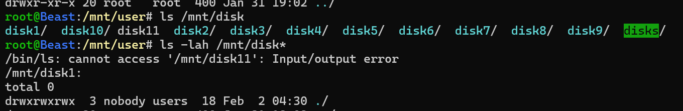

A hard drive failed on Friday and the replacements will arrive on Monday.

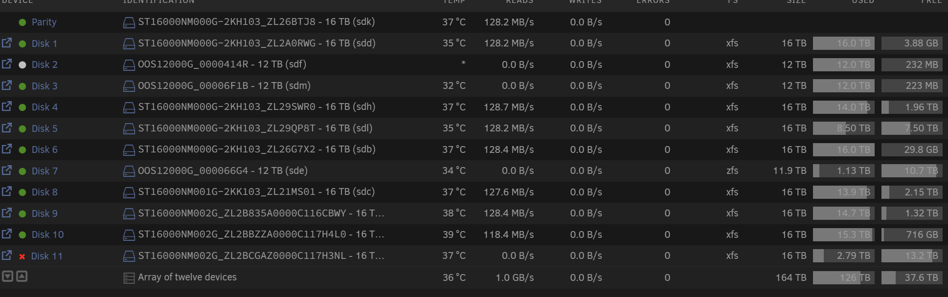

There were a couple shares set to using only the drive that failed.
These shares were readable Friday/Saturday, but do not exist today Sunday.

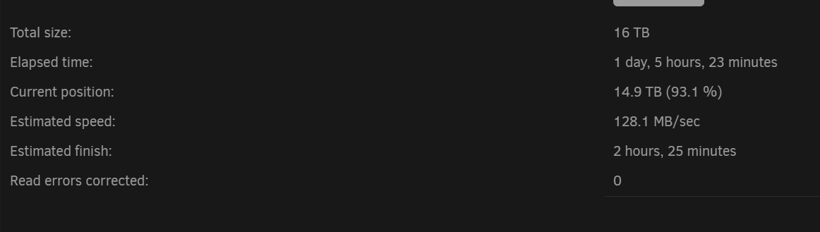

Early Saturday a Read-Check started, which is still running and has not shown any read errors corrected.
The failed drive is in an expected I/O error state
UnRaid sees an expected amount of data on this drive and the Parity disk is still OK.  (I remember about 2.8TB data used)
Will I still be OK to replace the failed drive in this state?
Any help would be much appreciated, Thank you!
