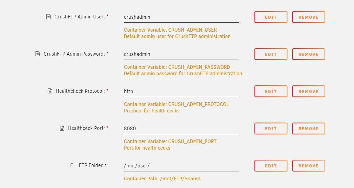

CrushFTP works well on UNRAID, but it is a bit too much for that pupose.

As I said: look at CrushFTP. Its a server where the scanner can send his files too (after it has been configured proper
Any guidance on that?
Dunno what you need. Simply you set up a User, give him access to share(s) and thats it. CrushFTP just can do so many more things that might confuse you at first. But if you keep it simple, there should not be a big problem.

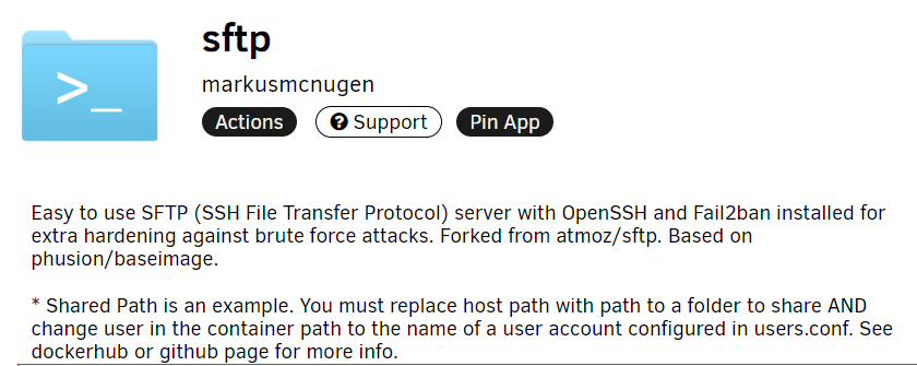

I run and recomend:
Base: phusion/baseimage:master-amd64
Application: https://www.openssh.com/
Application Version: Latest when docker was built on 03/22/2021
Docker Hub: https://hub.docker.com/r/markusmcnugen/sftp/
Github: https://github.com/MarkusMcNugen/docker-sftp

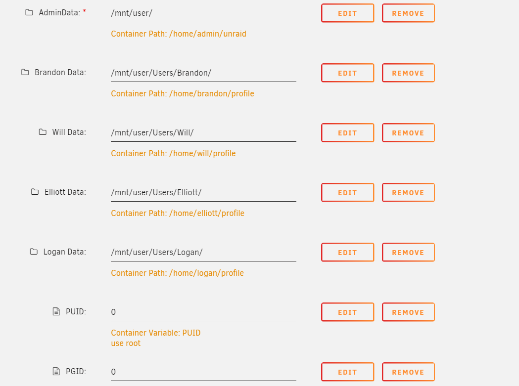

Runnign that docker,
I add this aditional data to the docker template..
admin user as seen here is the default user and has full acceess...
note other "ftp/secure ssh sftp users"
Using this methiod Logan only has access to the path set to profile.
If I want another path for logan to login to use i would add a path for
/home/logan/data
so when filezilla / sftp access logan will see profile and data and can only access that data...

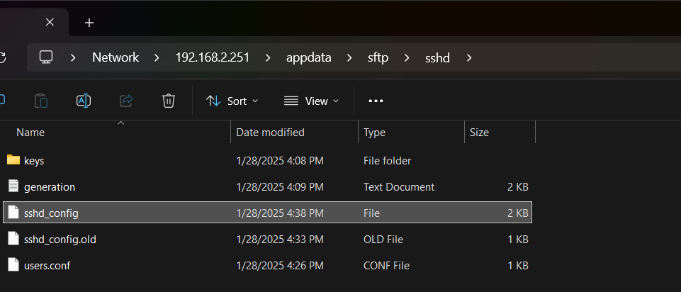

Run docker once to generate files go into the appdata sshd folder and make the above files for you ftp users...

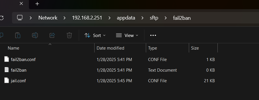

as this also comes prepackaged with fail2ban and a jails.conf
to help limit ssh/ftp attacks...
edit the jails.conf and adjust times...
see more: https://manpages.debian.org/experimental/fail2ban/jail.conf.5.en.html
# "bantime" is the number of seconds that a host is banned.
bantime  = 86400
# A host is banned if it has generated "maxretry" during the last "findtime"
# seconds.
findtime  = 3600
# "maxretry" is the number of failures before a host get banned.
maxretry = 2
hour locks 24hour ban if failure.
you can console to the docker and run a simple comand to unban...
list banned IPs (to confirm the ban):
fail2ban-client status <jail-name>
fail2ban-client set <jail-name> unbanip <IP-address>

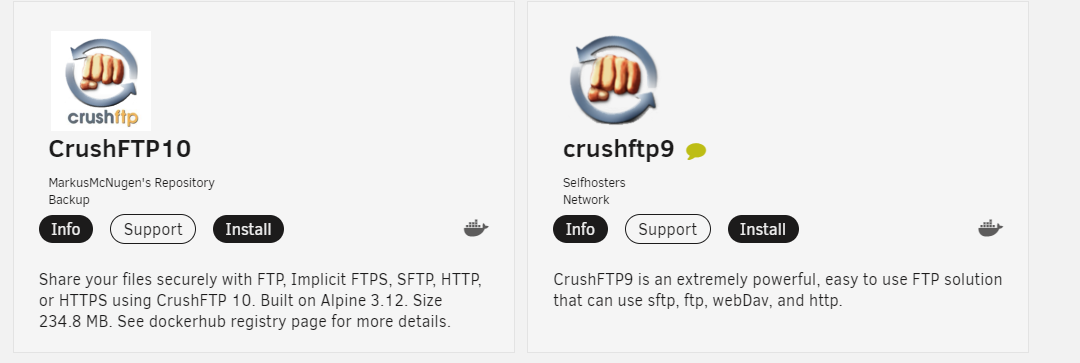

simlar to sftp, crush ftp is a docker install for ftp (port 21)
here like filezilla, you can use a web http page to configure your ftp server:
Edited by bmartino1

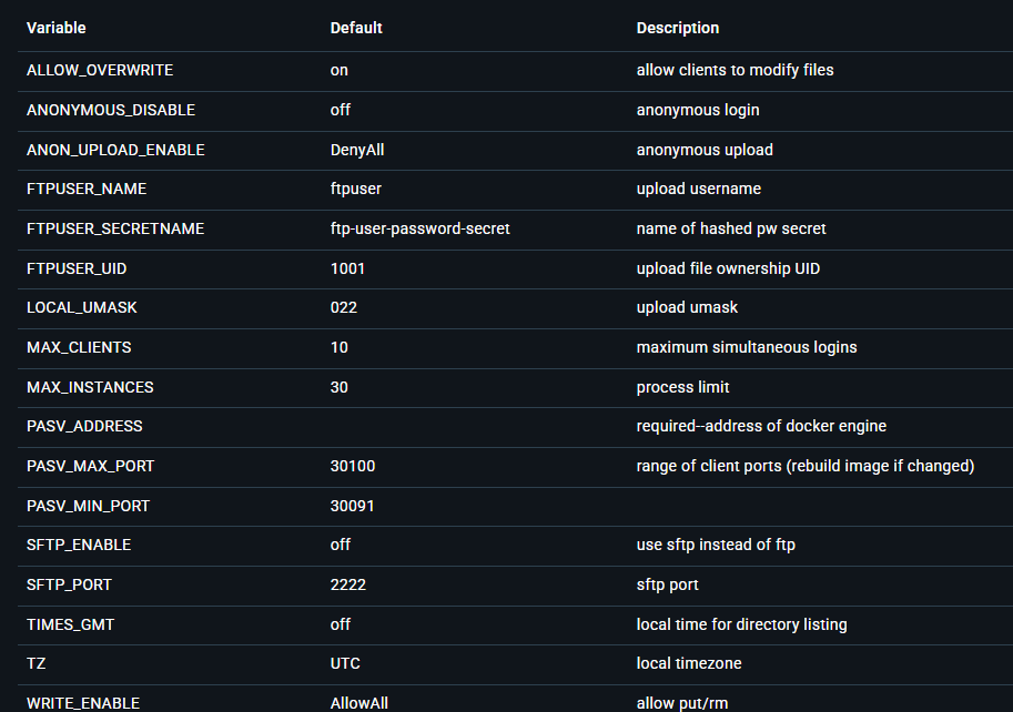

https://hub.docker.com/r/instantlinux/proftpd
and make a custom unriad template with docker variables:
