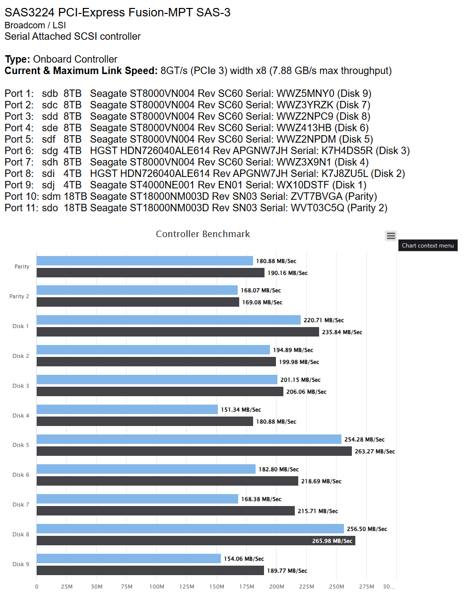

Parity check began recently but its going way slower than usual.  averaging around 15MB/s rather than the 150+MB/s it has done in the past.  I see no errors in the logs, VM Service is turned off.  I checked the disk controller, its attached at x8 and all the drives seem to be capable of a decent speed.  Diags attached.

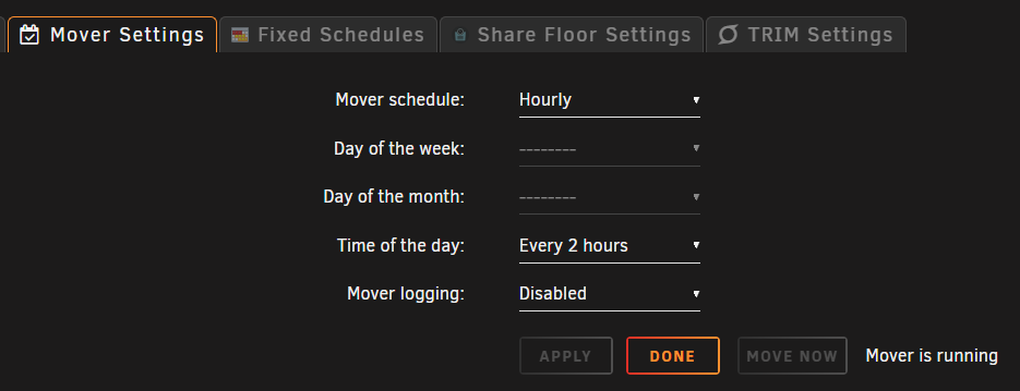

How do you have Mover scheduled?
I thought Mover was disabled during parity checks, but it appears to be running for some reason.
ok, after manually stopping mover and turning off docker and vm.  it appears to be running at a normal speed of 200MB/s now.  thanks all!
