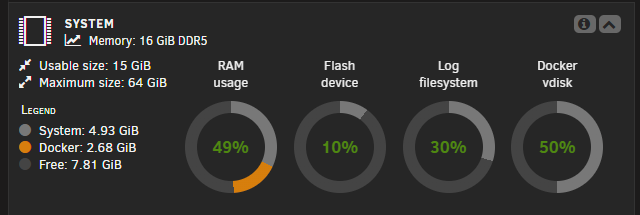

is this level of system Ram Usage normal at 49%?
Ram Usage:  7.59GiB
Flash device: 670MiB
Log File: 37.7MiB
Docker Vdisk: 19.4GiB

Viewing my system again this morning the system ram has increased by a further 2gb, while the docker usage has remained unchanged.
Is there any way of knowing what from the system is consuming so much Ram
System now shows 7GiB

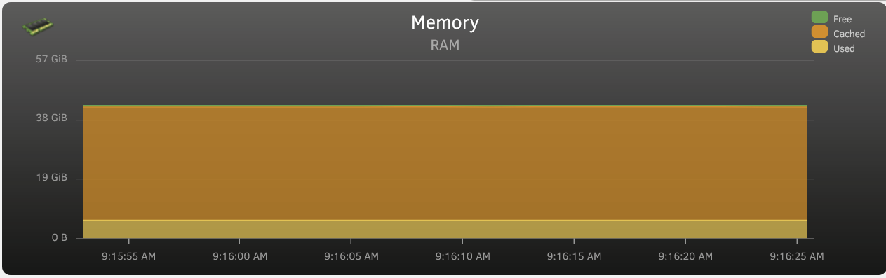

I would hold off on adding any more RAM for now. As you may know RAM isn't just consumed by processes that need it, but is also used for caching (which will be released when needed), from the OS's point of view, "unused RAM is useless RAM" it's just a matter of how it's allocated. Here is a graph from my 64 GB system:
As you can see about 40 of 64 GB of the RAM is in use but the vast majority is cache. If you want to see a graph like this on your system, install the "Dynamix System Statistics" plugin.

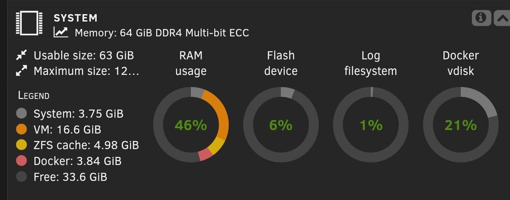

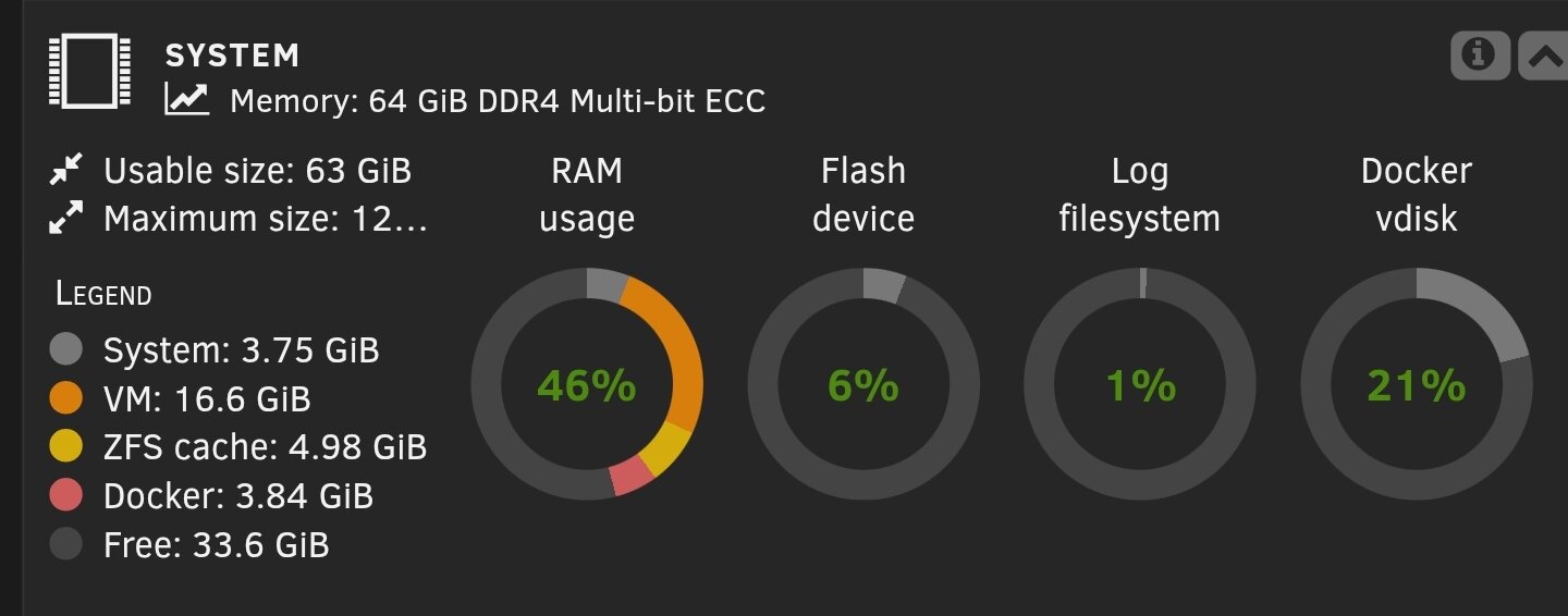

Your use is normal.
I have all this running with lots leftover.

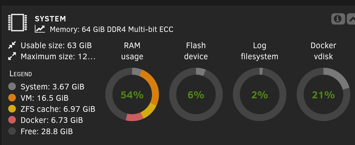

hi @Paul_Ber
with all that running your System ram shows 3.67GiB, yet as you see from my above post my System usage increased to over 7GiB (hitting 10GiB before shutting down SSH)

I do not know what else to say as I have always had systems with 32GB RAM.   Now I have 64GB RAM.
