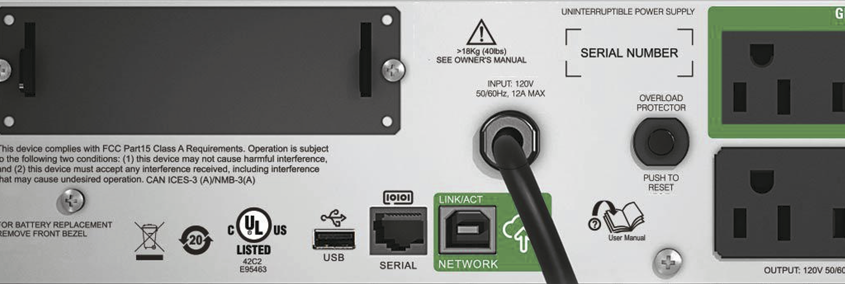

  3. I'm aware of that. My current UPS uses that cable and it is carrying a USB signal. However, the documentation for the UPS mentioned here clearly states it's a serial interface with a separate port for USB. If the UPS doesn't match that Port layout then that's another story. But the documentation is very clear.
  4. If this is accurate to what the back of your unit looks like: then @Vr2Io is right and what you want is the USB port, hopefully the cable is included because they are doing a VERY non-standard thing by putting a USB-A plug at both ends. The RJ45 connector is clearly labeled as serial so you don't want to use that (if, as you describe the cable is RJ45 at one end and USB on the other, it most likely contains a serial-to-USB converter and is not what you want to use).

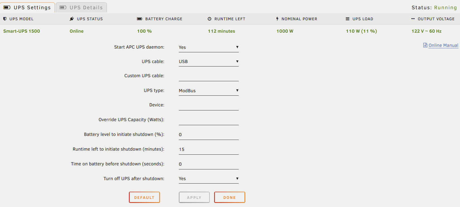

  5. If it helps at all, this is what my settings page looks like: Yours should look very similar, would you mind posting a screenshot?
  6. Do you mean that the settings in unraid, after you save them, aren't overwriting the previous settings? Also, you're using a USB cable I assume, if the new UPS came with one use that one rather the the old one (it shouldn't matter but I've had issues with cables)
  7. Not sure I understand your issue, but I'm going to assume you are connecting the USB cable like you had before with the 1000 and it's not reading anything from the UPS? If that is the case, go into the menu on the APC UPS and go to the configuration menu, there you will find an option called "Menu Type", if that is set to "Standard", change it to "Advanced". Now you will have additional options in the configuration menu. One of the new options on the configuration menu will be an item to enable ModBus, this is a protocol that is used over the USB connection from the UPS. Once that is enabled, in UnRaid, go to the UPS settings and set the "UPS cable" to "USB" and the "UPS type" to "ModBus". See if that helps. You may notice that among other things, once the menu is set to advanced you can also modify the voltages that the UPS will switch at, in case you need it.
