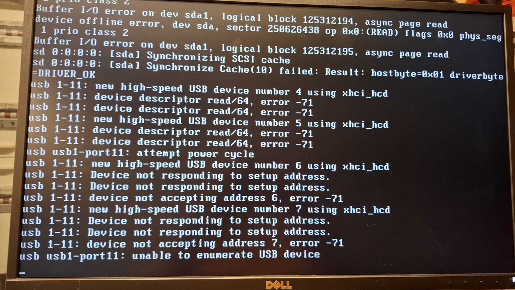

Today i turned on my machine but it didnt come up.
I connected a monitor and i could see the error attached.
If i plug the usb stick into my computer i can read it, but it doesnt boot somehow.
Is it broken?
Thx
Try recreating the flash drive first, if it still doesn't work, replace it.

If you can read the flash drive from another computer, you can try to copy it
the config folder from flash is all you need to get going again with your configuration on a new install, whether to the same flash drive or a replacement.
If you have to do a replacement, you will have to do a license transfer.

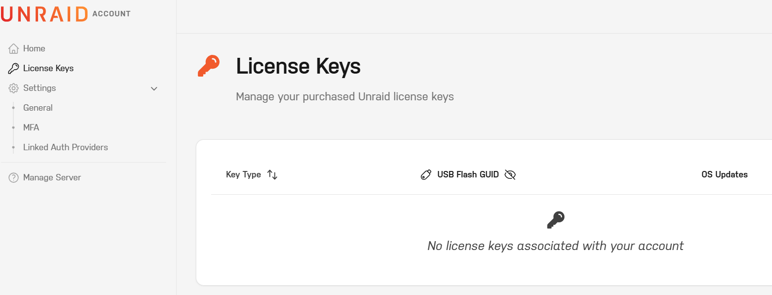

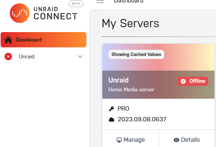

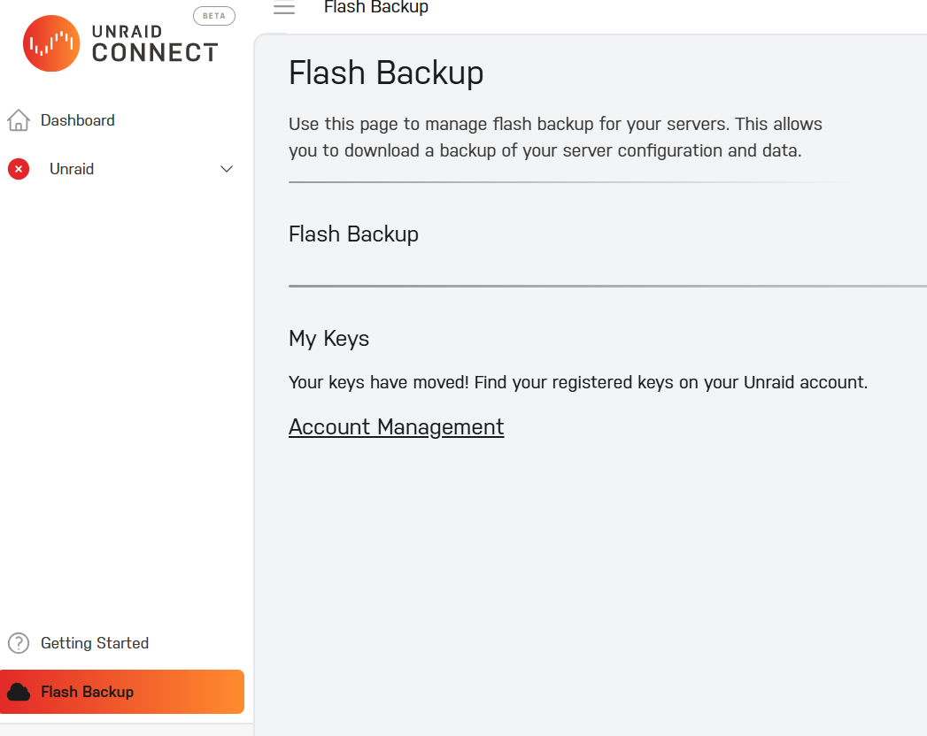

i just went to unraid connect again, again thats from ages ago
It doesnt look so good though, see attached files

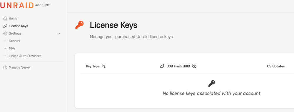

There are no backups there, i think i did that once though
Also no keys are registered????
Your license .key file is one of the things in that config folder I mentioned which has all of your configuration (all settings from the webUI).

I will look to create backup again
Also how do i get the key into that portal?
Yes license key is now in the portal, it seems backup of flash is disabled, will look into that further.
Thx for the help here
Settings - Management Access - Unraid Connect
