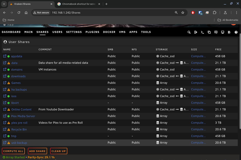

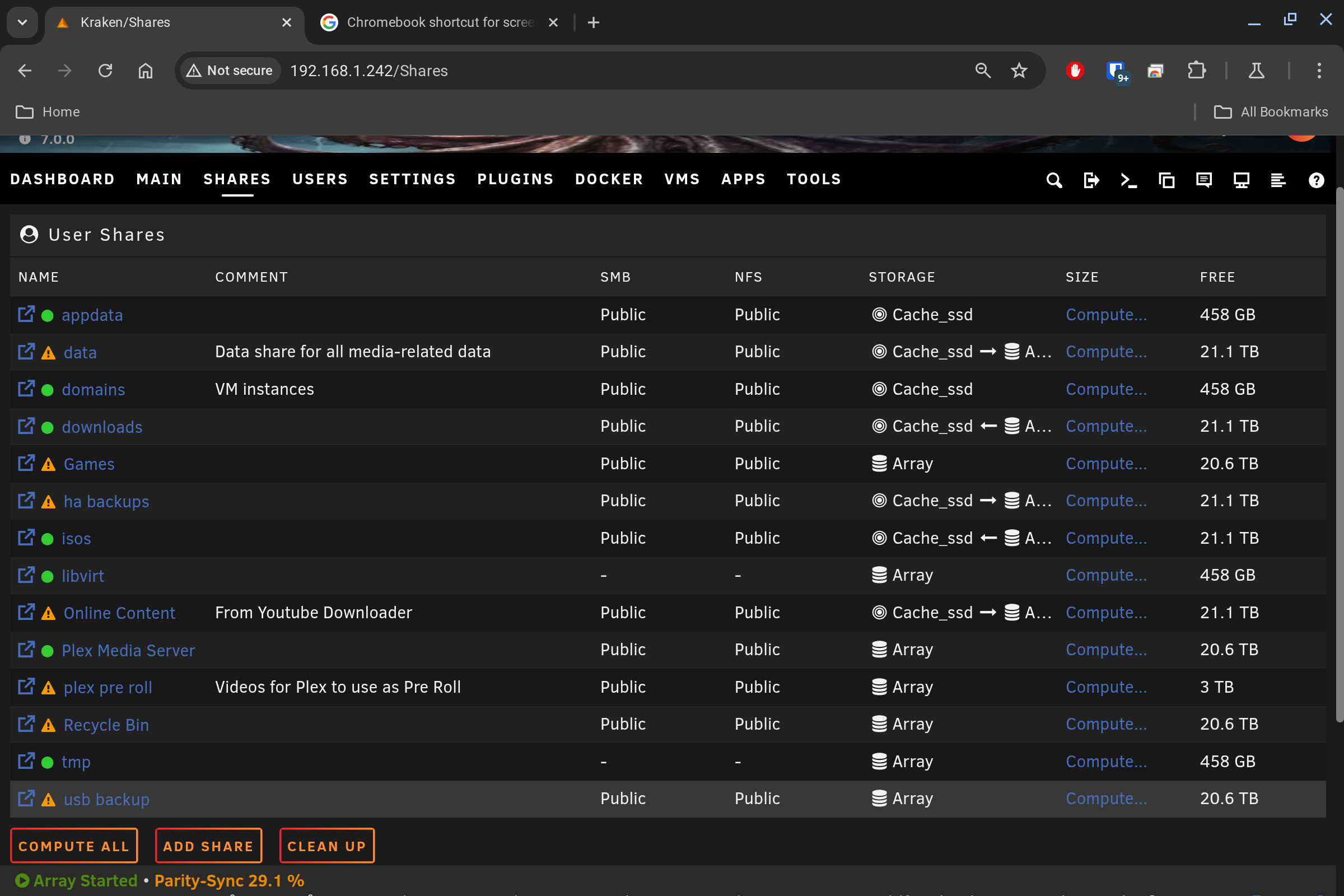

I'm getting continuous errors in the log during rebuild. I found that my shares were missing so I rebooted. When it came back online the shares were there but warned that files may be unprotected. I looked at the disks next and I had one parity and one array disk in error. So I stopped the array then started without the disks and repeated adding the disks back again.

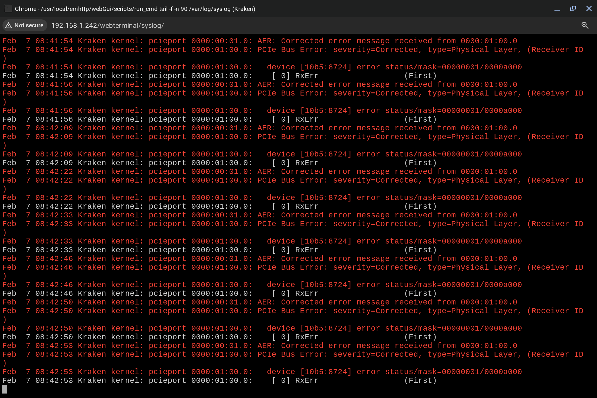

 I am now getting this continuously in the logs:
{Feb  7 09:19:32 Kraken kernel: pcieport 0000:00:01.0: AER: Corrected error message received from 0000:01:00.0
Feb  7 09:19:32 Kraken kernel: pcieport 0000:01:00.0: PCIe Bus Error: severity=Corrected, type=Physical Layer, (Receiver ID)
Feb  7 09:19:32 Kraken kernel: pcieport 0000:01:00.0:   device [10b5:8724] error status/mask=00000001/0000a000}
I don't know what the error is. Also the array seems to be running the parity okay. What should I do?

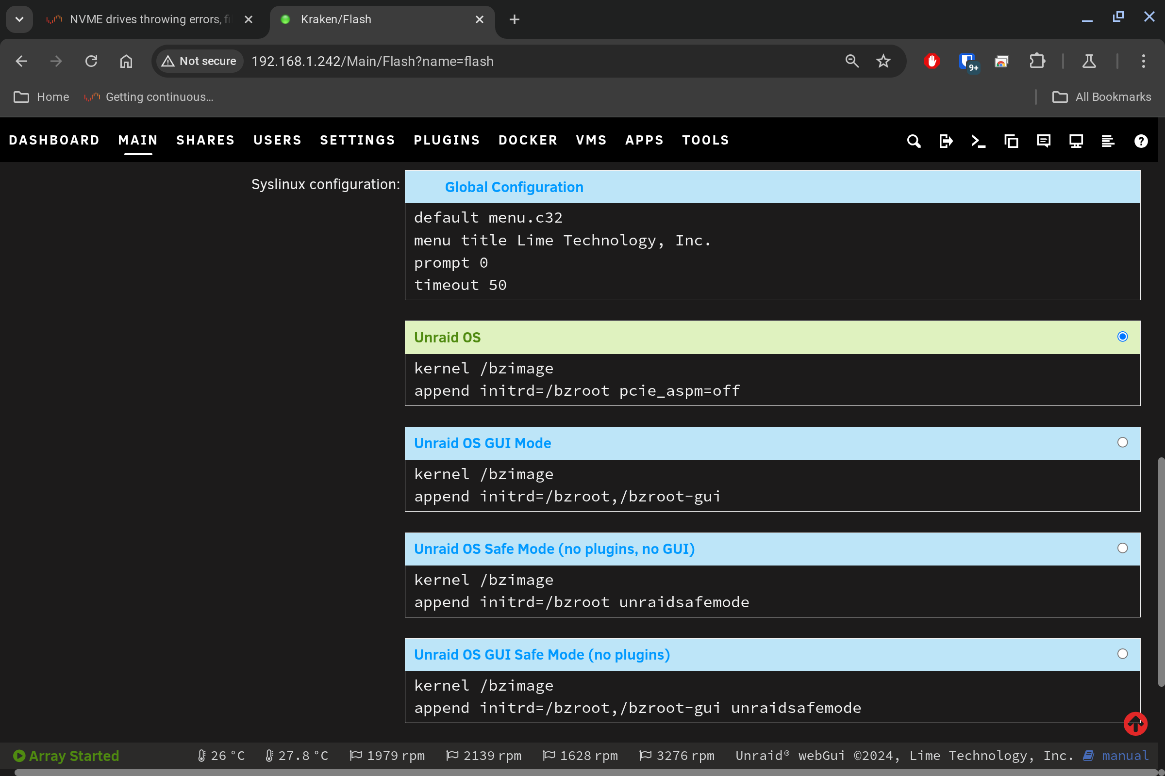

59 minutes ago, ctsdad said:
have never messed with the config file. So do I just go to the  unraid.config and add this at the bottom to it's on line.
You add it to the ‘append’ line for the boot options you want.   Options on the append line are space separated.
Hi sorry for the break in time (Health reasons)
After my parity rebuild I followed the instructions from the listed page and the two above moderators and added " pcie_aspm=off"
to the green append section as seen in the attached photo. Rebooted and the issue was solved.
Thanks to all involved
