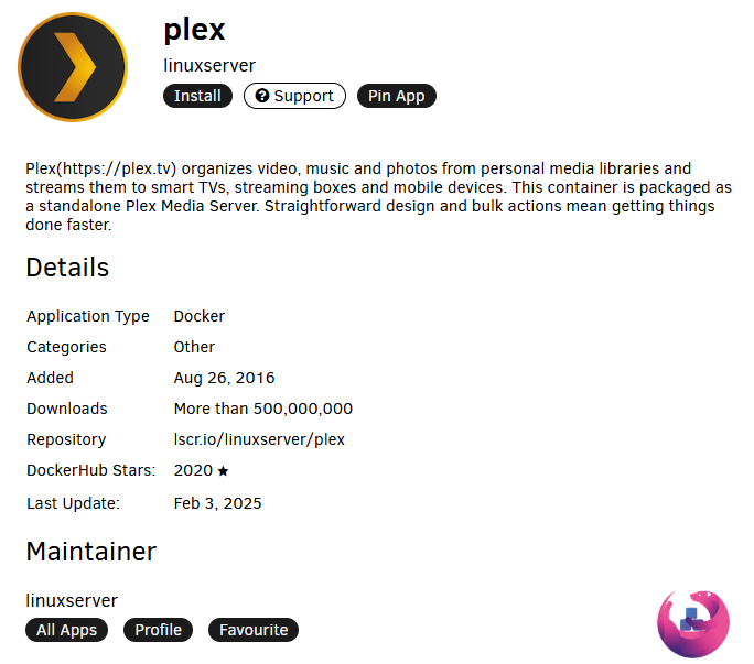

Plex -Linuxserver Docker

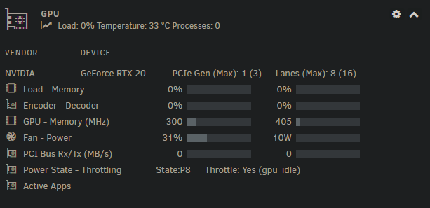

When i am watching a movie/show, and i choose to transcode down at all (convert a 15mbps movie to 10mbps) The above GPU stat will show 1 Process and show plex in the active app. Then it will suddenly go to 0 and the active apps will show nothing. This will result in nothing but spinning on the end trying to watch plex. I can only really direct stream to my pc's and devices in my house if i down scale at all it does this.

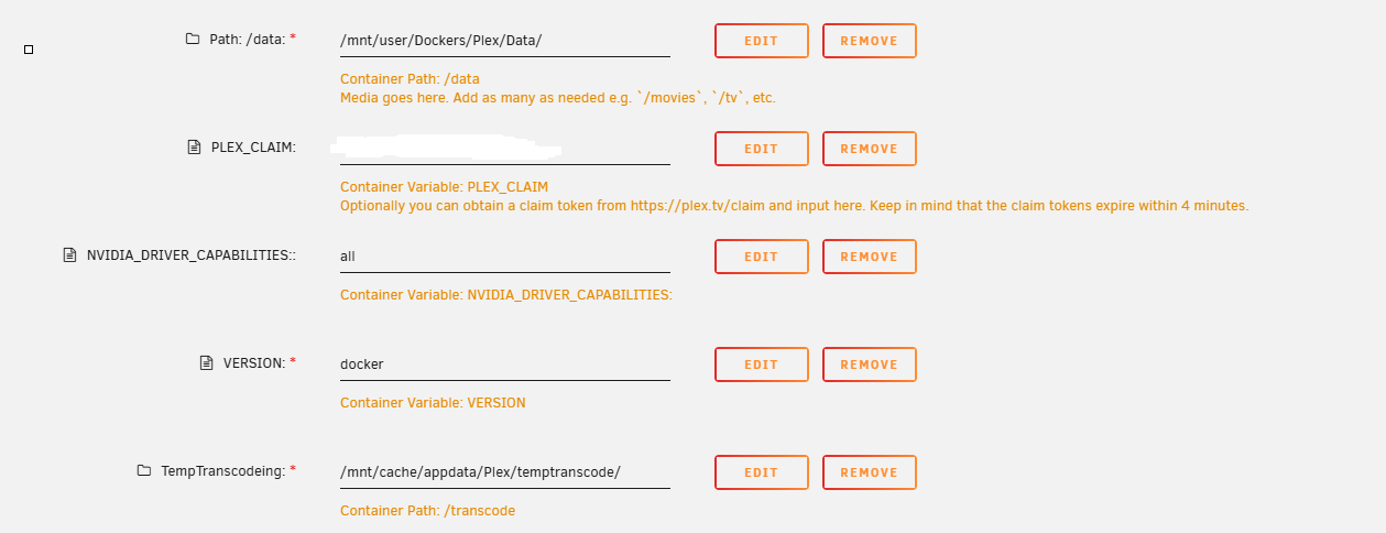

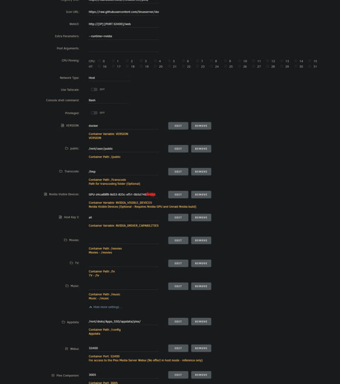

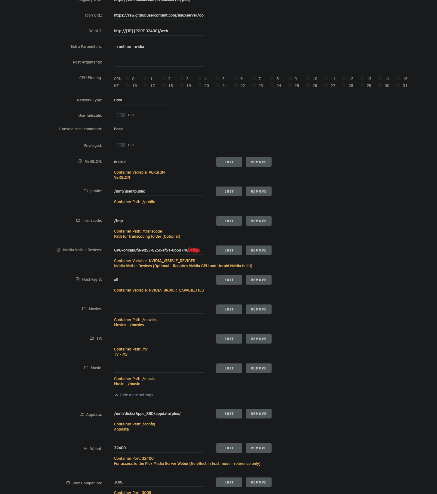

Docker settings look like thisimage.thumb.png.6a2c9eb84c9c45936c2ac36f598e651f.png
This worked for me for years. I have no idea what suddenly (i don't know how long its been doing this before I've noticed) made it do this. In the past this worked perfectly.  Im going literally insane, i cannot figure this out.

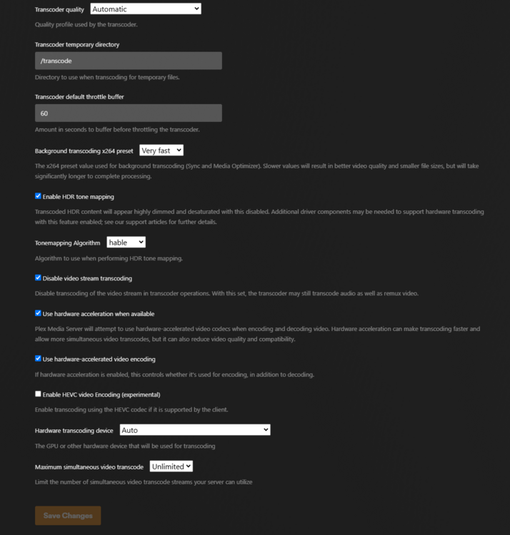

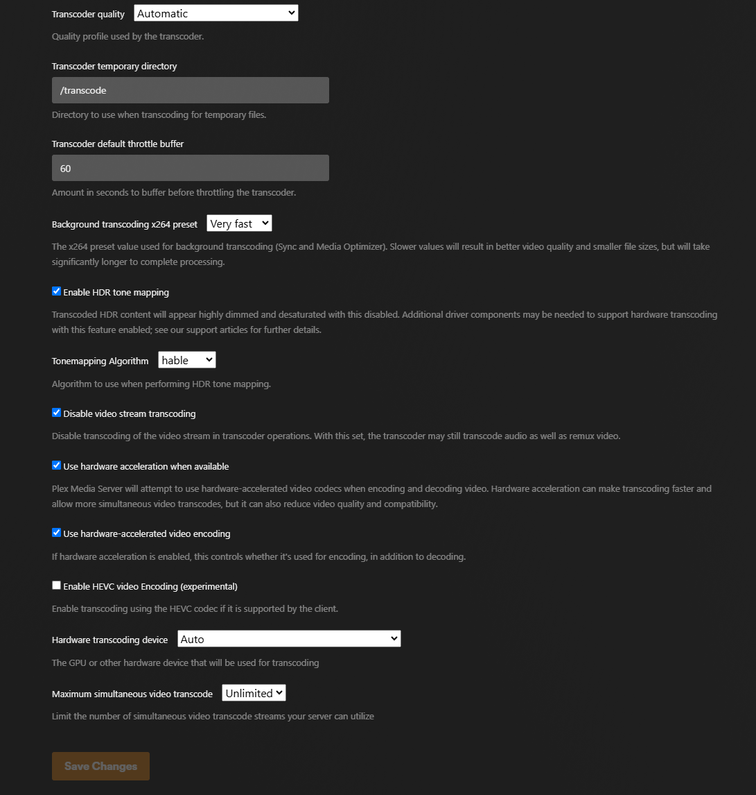

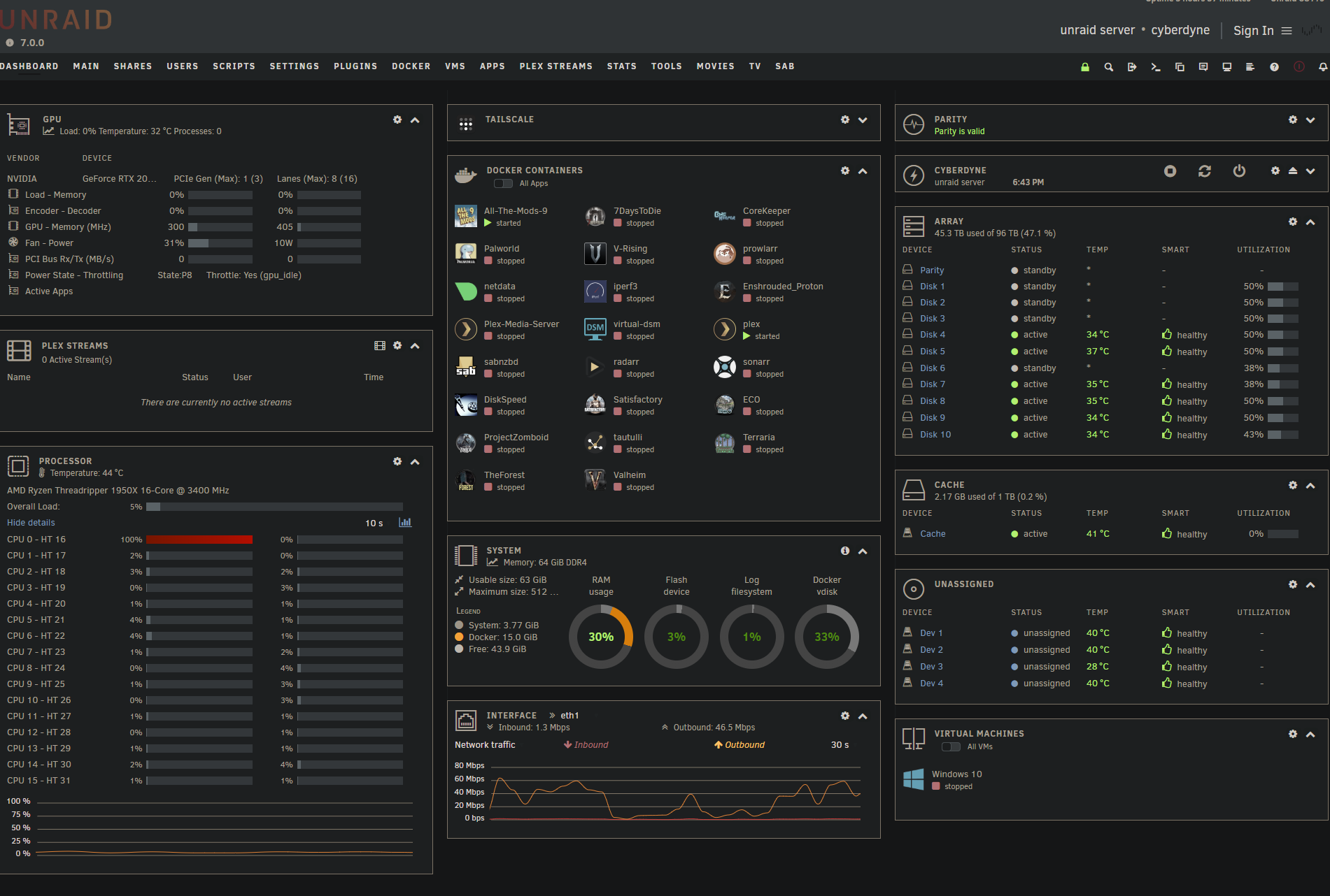

Dont know if this will help image.thumb.png.81117658ed2b9fee4665927c919ff145.png

First add a path to the docker:
Second, add this to the extra parm and see if its any better:
--runtime=nvidia --device=/dev/dri:/dev/dri
Will try and put --device=/dev/dri:/dev/dri   in the extra peram.  Already had the nvidia part. (this worked fine for me for years...)
Unless im looking at something wrong , as seen in the pictures, i already have a /transcode path defined.

I Personally use the LinuxServer IO Dockers. and when/with issues, I can easily move the docker repo to Plex Official Docker image...
I believe you have a plex setting causing some of that... as remote file will transcode regardless of the setting but local is told not to use the hardware...

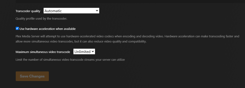

Double Check Settings:
Under plex Gear (Settings) Transcoder:
you may need to toggel "show advance"
and match or verify your settings above...

Docker Image - tags and Repo:
linuxserver/plex
or
plexinc/pms-docker
using linux Server Unraid Tempalte:
in the extra parm I add
with out issue see and have access to the nvdia g card for transcode.
Only thing left would be the docker image your using (as it needs the driver pre-packaged) or a plex misconfiguration.
As stated in start of topic, i have tried linux version of docker. Also the check mark you have next to Disable video stream transcoding..... Disables video stream transcoding option on clients end, and for the most part does what it says so it kinda is the opposite of what i want here. These settings did not work either.
but do you see the nvidia device in the drop down list? take it off auto and set it.
After verifying the above settings. and making sure the devce is detected and selcted with the options you want it to do...
it sounds like its doing what it needs to. As local is using direct play. to stream it remotely its transcoding to help video and buffering.

I have taken it off auto and set it to the gpu. It does not help. I have been using to to transcode for various reasons for years, the 3060ti can transcode all my media just fine.

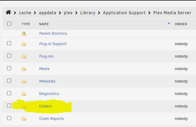

2. Delete the contents of you Codecs folder.  This has solved odd transcoding issues for many people in the past, even for those using hardware transcoding.  Your Plex server app will go out and re-populate the folder with a fresh set of codec files when you start the Plex docker.
Have tried deleting the codec folder. Still issue persists. Issue also persists on plexapp on all the pc's in the house.
