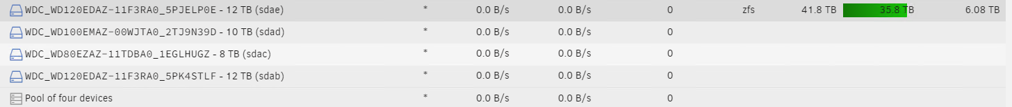

A zfs stripe will use all the capacity from different sized disks:
