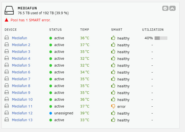

The two drives in question that have been problematic are still questionable to me.  ST18000NM000J-2TV103_ZR56RY07 is still showing in an error state, but is displaying a green indicator and a status of "active" which it was not before.  When I look at the logs from the latest diags it says SMART overall health assessment = PASSED. I acknowledged its error state and will monitor to see if it changes back to "standby mode: Spun Down"
ST24000NM000C-3WD103_ZXA08Y57 is still showing a status of Unassigned with a blue indicator. I stopped the array, selected this drive and chose "no-device". I then started the array so the drive would show "offline". I then stopped the array again, and assigned this drive to that slot and started the array again but the status hasn't changed. I'm not sure if that means this disk is actively being used in this zfs pool or not.

Reimport the pool, that should resolve the blue icon:
- on main click on the first device for that pool and then "remove pool"
- back on main, create a new pool with the same name and number of slots
- assign the pool devices, leave the filesystem set to auto
- start the array to import the pool
Then acknowledge the UDMA CRC errors for mediafun11, see that they don't keep increasing after.

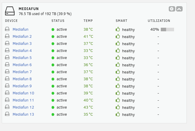

Easy Peasy - that worked like a charm. Thanks again so much for the help. Can a cable cause that much problem to the point where I can't start/stop the array? I had rebooted several times prior to changing the cable with no change. The only thing I did differently yesterday was completely unplug power (ie, flea power drain) before changing the cable.
Anyway, back to normal. I'll monitor mediafun11 to make sure errors stay under control. If not I've got a replacement ready to go.
Thanks again for your time, calling this one good
