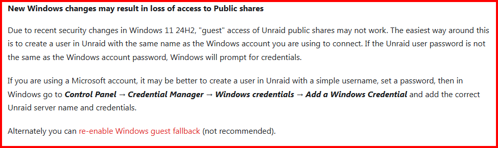

From the release notes for version 7:
This solution will fix  most permission problems.  (I have a single Share access user on Unraid and add a Windows Credential using Windows Credential manager for each computer to that user.  You need multiple users only if you want to restrict some users' access to certain shares.)

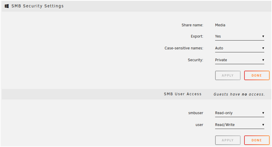

If you are using SMB, that is what the group and permissions have to be.  When you set up a Share Access user on Unraid,  that  user becomes a member of the group, 'users'.  (As a side point, 'nobody' is also a member of 'users'.)  When you go to access a share if you are not the owner of the resource, you will have to gain access using the group permissions.  (You DO NOT HAVE TO be the owner to gain access to a resource.  But you do have to be a member of the group-- 'users'!)   Understand that Unraid does not work quite the way that most other client operating system do when granting access to files.  Remember that it is server software and that it expects that many different user logins will want to have some type of access to the same set of files.  Some of them will have read-write access, some will have read-only access, and some will have no access at all.  Unraid provides for all of these scenarios.
Below is an example of what I mean:
Notice that there are three different owners of these files.  Yet, 'nobody', 'user', and 'smbuser' can all access these files using the permissions allotted to them using the SMB Share settings as shown below:
Since this Share is 'Private', 'nobody' has no access to this Share.   Think of 'nobody' as being a guest who does not have a log-in to the server but is still allowed access.
Hope this helps...
