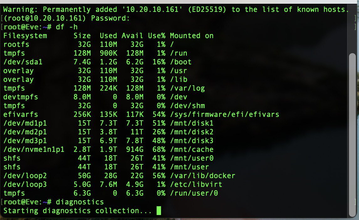

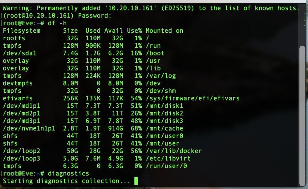

Now.... to get you help, i need diagnostics. But i can't get them. Command line is sooooo slow. Logging in root takes around 45 minutes to show up with password prompt. No webUI is working. No shares are available. External screen directly on my server stays blank. It has a IP, as i can see from my Router GUI, with little traffic. But the rest is just dead. Creating diagnostics is stuck for 2h now...

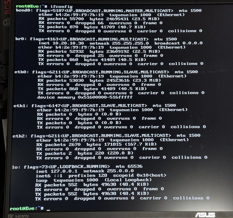

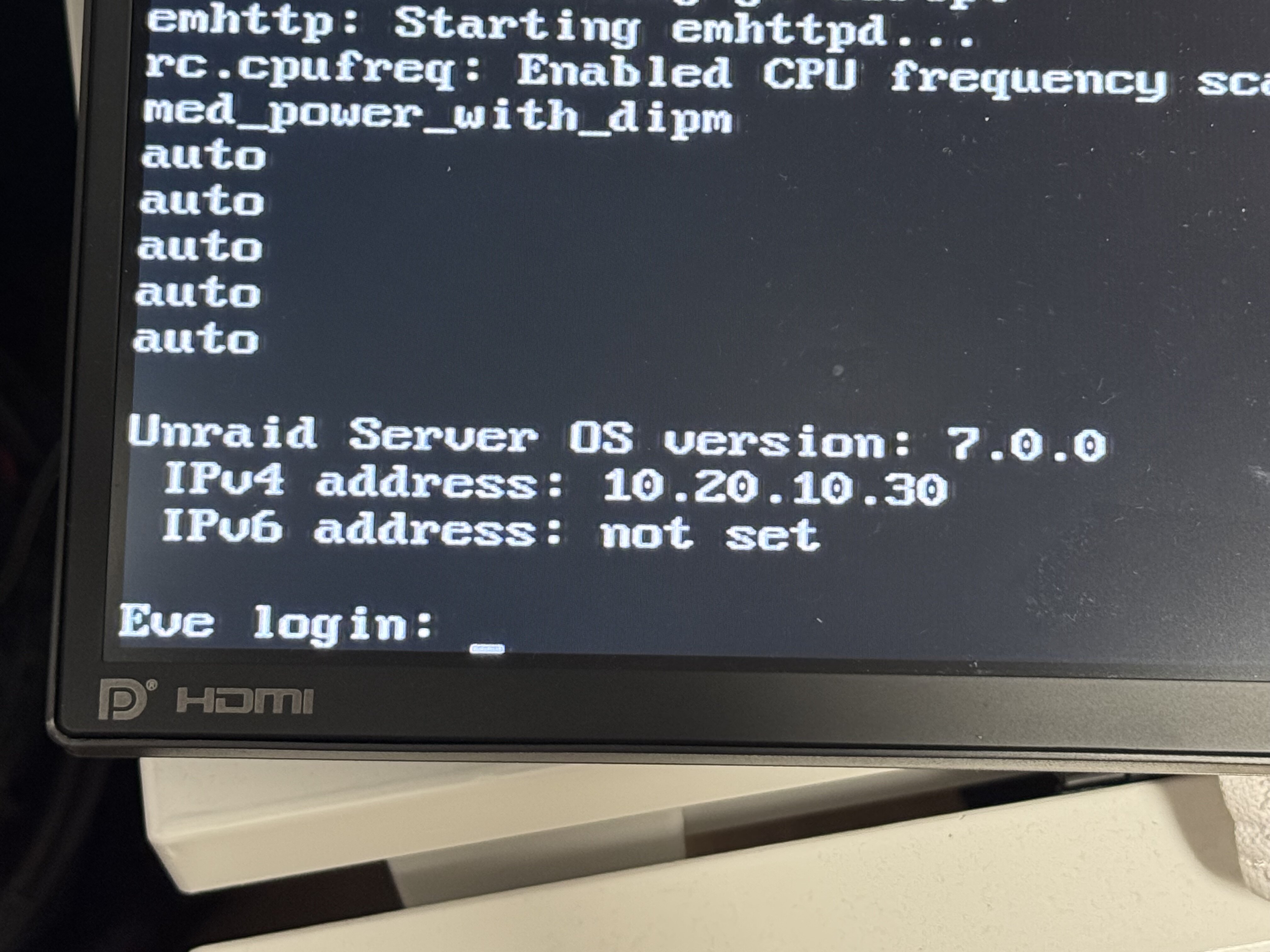

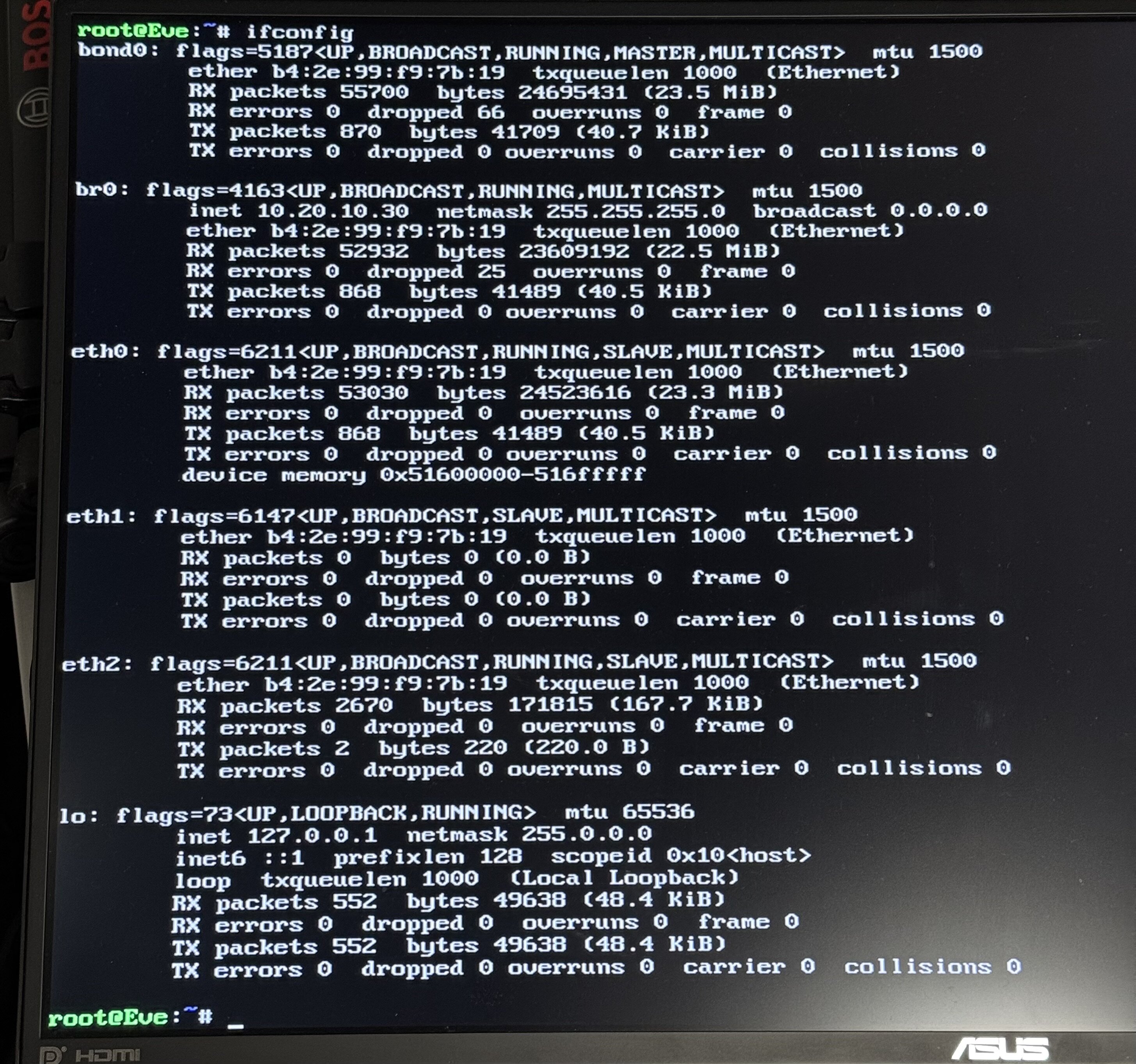

Can‘t log in anymore. Lost connection and all i can do in safe mode now is command line with monitor and keyboard. It tells me the ip address, but there is only timeout connection :(
Shouldn‘t there be a ipv4 address at eth0?
If it's losing the connection even in safe mode with docker and VM disabled, it may be an external issue, post new diags.

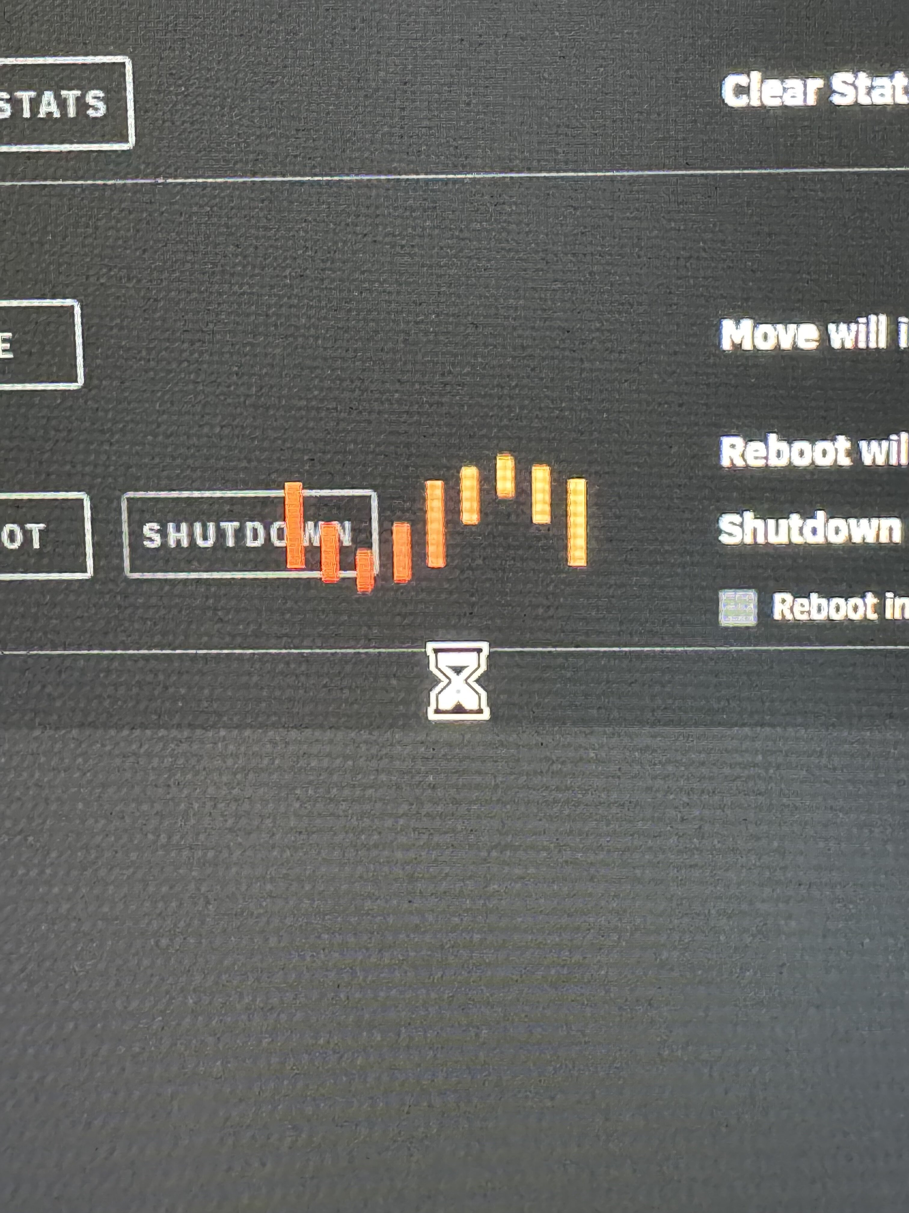

turned on the array. GUI working. Everything looks good (safe mode). Turned off array to change settings —> lost all connections and frozen gui. Power cycled the server. No luck. Restored flash drive from backup again. Gui is back running. But as soon as i change any setting, is looses connection and is stuck.
i‘m really clouless
Thats the last thing i see, no matter what change i make.
