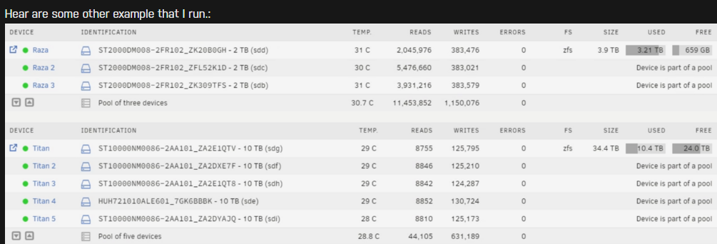

as example with a pools named raza and titan
Trying to use a nomenclator that fit the scenario.

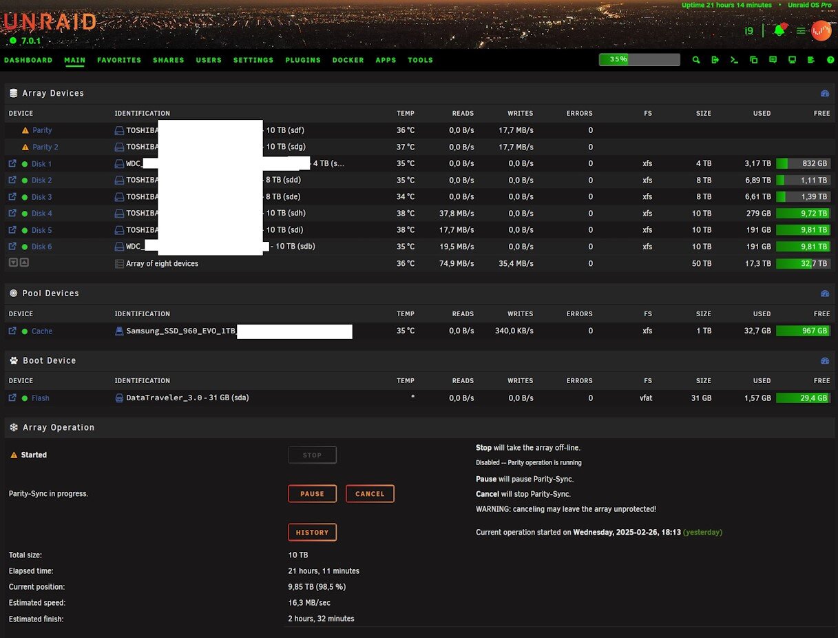

It was a long journey (more on that later) but In short, i ended up adding thle hba card (more on this later) and the disks and uses tools > new config, moved the 1 parity drive to storage and put 2 new ones as parity and add the other 2 as storage, formated the 3 new ones on the array and started the array.   Parity sync is almost done now 😄.  In all, this was the answer/steps I was looking for.  In the meantime I analyzed and concluded zfs was not the best for me.

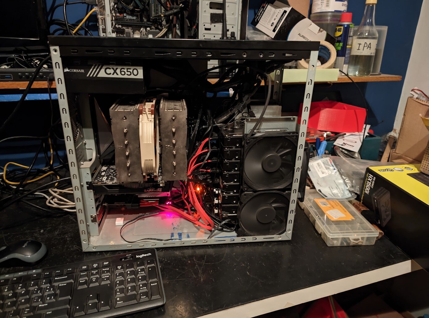

About the case, the one on the pic the cage for the drives could not hold more than 4, so after much looking around in the local market, bought one used for cheap, hdd cage had space for 9 hdds.  when it arrived and tried to move the mobo i realized that  despite fitting (it was atx after all) there were no holes nor reasonable space to route the sata cables from the 90º angled sata connectors of the mobo... so i took out the cages of both and swapped them. of course nothing is as straightforward.  Lets say I drilled the rivets and took the cages out.  Ok, so i have no screws/bolts to fix the 9 hdd cage on my case, and I realized the time came for me to buy rivets and the tool, another day passed.
in all the little monster ended up looking like that
