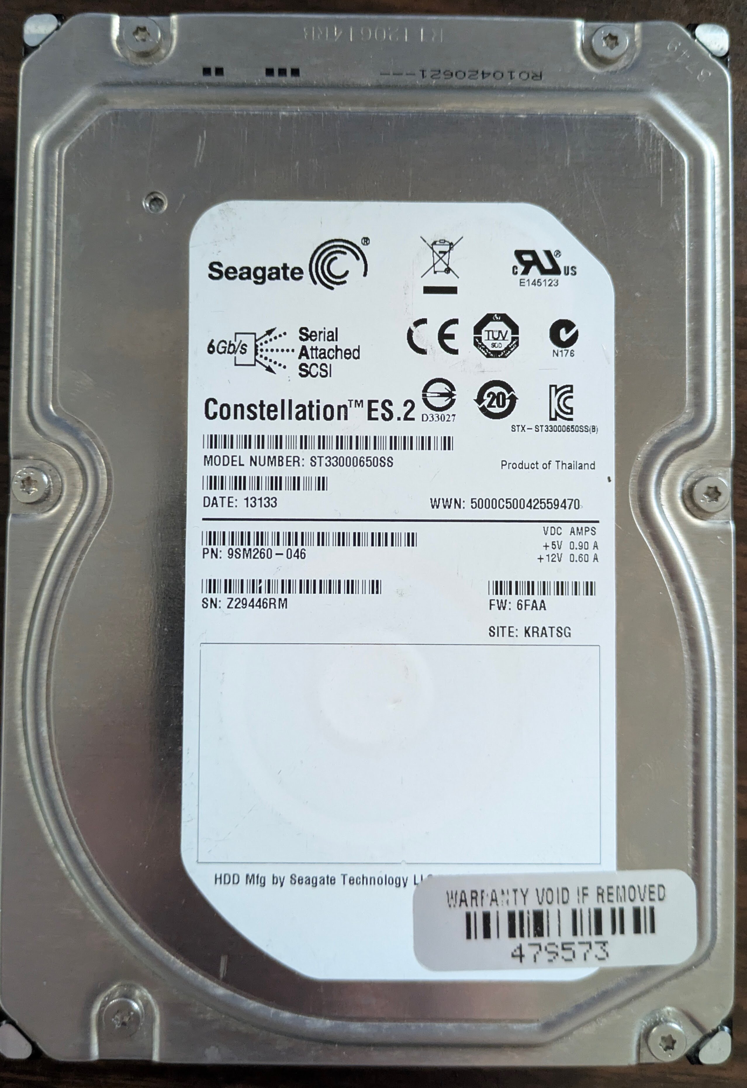

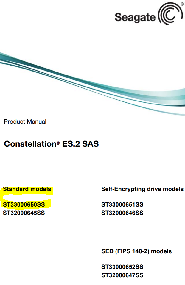

There is no PSID printed on the drive for me to pass to the SEDUTIL command:
All the google results tell me it would be printed in the empty box at the bottom of the label.
