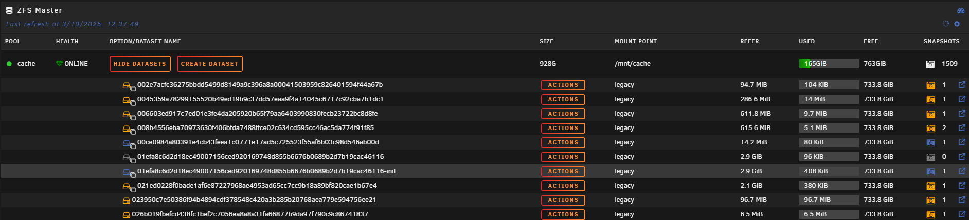

Is this number of snapshots logical? (zfs noob)
So, my cache disk is ZFS since before 7.X.
Is the number of snapshots normal to be so huge?
(note that I rebooted the server an hour ago - because of some firmware updates)
Also since I remember some discussion about zfs "mode" (or something) that UNRAID prefers (?) in version 7.X (I am in 7.0.1 now)... Where can I check that and what do is that I should see to be ok?
This pool now DOES NOT have appdata/domains/system any more (I moved those away, but MAYBE they left behind zfs residue?), it only has temp data for mover to move to array (plus few data that need to remain there).
How do I clean up my snapshots/datasets, how do I know what is really obsolete, how can I automate this clean up? (if needed to automate - I am not sure how UNRAID manages this thing itself)
I remembered one dataset and it was taken in 2023? (I don't even remember if I had switched to zfs so far back)
Note that most datasets have mount point "legacy"...
Help?

If you have Docker in folder mode and with the "native" driver option yes it'll do that, and it's not recommended on zfs drives.

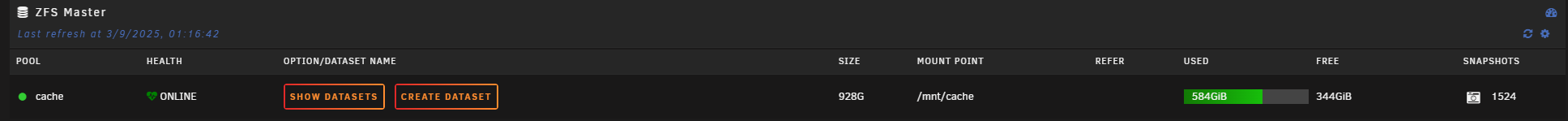

That said... my zfs cache pool still shows more than a thousand snapshots (now that appdata/system/domains are not in that pool).
Is there a way to clean this up or I shouldn't care?

Post the output from
zfs list -t all <pool name>
Yes shows this:
NAME    USED  AVAIL  REFER  MOUNTPOINT
cache   163G   737G  61.5G  /mnt/cache
But...
...this scrolls down forever
Edited by NLS
Sorry, you cannot use the pool name, just:
zfs list -t all
But if they are in the root pool, no way to delete them other them one by one.
that's not possible
(maybe a script? maybe just format it again in zfs or non zfs?)
see the output
https://pastebin.com/TZ9kdcEg
in between (and at the bottom) you will see the few existing mount points (in cache there are 11 folders and most are empty)...
all the others I don't know if they are needed in any way or how they were created and why
if I am going to be honest (and this is a general comment, not sure if it has anything to do with unraid's implementation), I don't really get in my case what benefit I have from this added complexity and what makes zfs so perfect and everybody loves it (all I see are new issues we never thought of having with a fs)
Edited by NLS
Yep, they are on the root pool, this means the docker folder wans't a dataset, for the easiest way to get rid of them, I would recommend backing up and reformatting the pool
