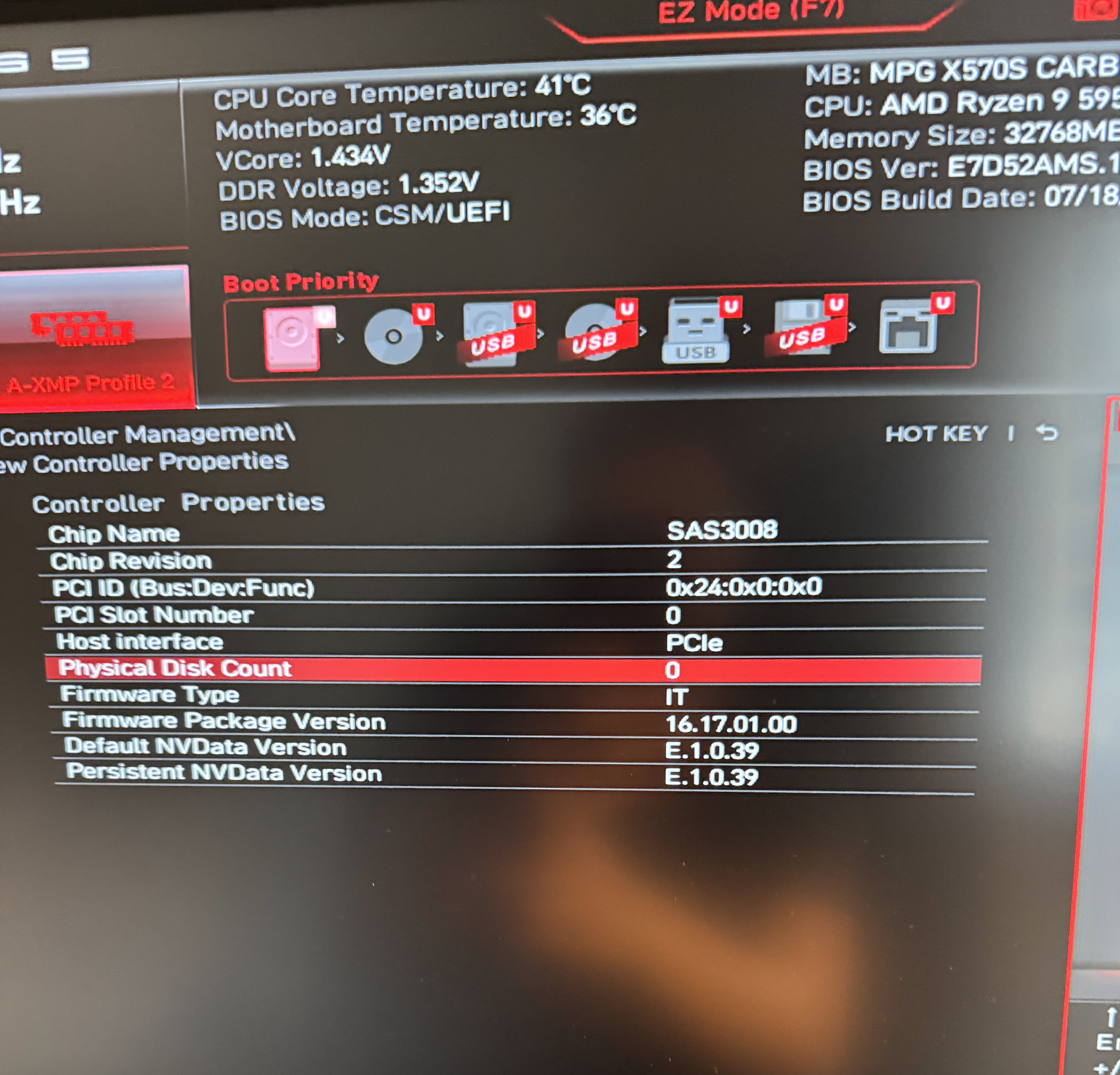

Both, Works with a Windows OTG usb stick detected as a Dell 12GBPS HBA and within my personal machine just in the PCIe slot...

Appreciate the searching. Resize BAR is off. I even toggled it on and didn't make a change.
The annoying part is that I have seen this card in the Unraid GUI. Like once, but it's disappeared ever since
I can see the drive is detected in the Dell BIOS and I have access to configure the HBA (Enable Legecy Mode or not) But it's detected by the bios...
The provide info said HBA won't work in Dell PC, but you said even it detect under Windows it still not show any disk. So, it likely the HBA also have problem.
