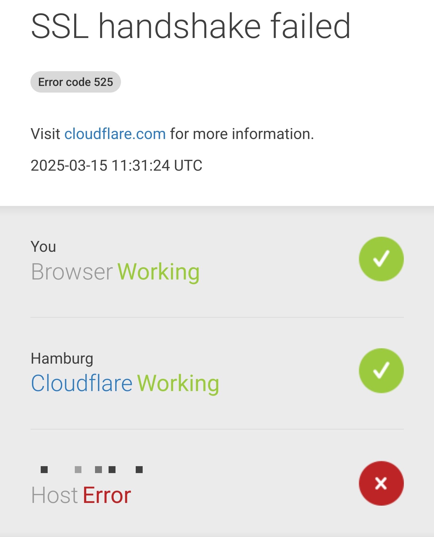

When trying to access my domain, I get the “SSL Handshake Failed” error with Error Code 525.

When I click my page in NPM it opens the cloudflare error landing page.
I have tried both in NPM, HTTP and HTTPS. Both result in the same error. The server time/date is correct. Screenshot_2025-03-15-12-34-31-28_3aea4af51f236e4932235fdada7d1643.thumb.jpg.5e577d840c04e15a42151c0ecebe9cf4.jpg

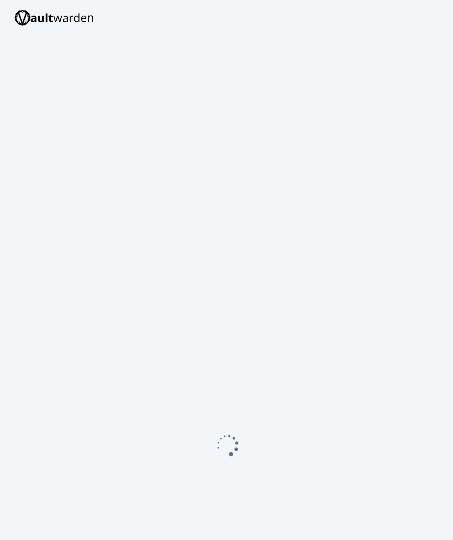

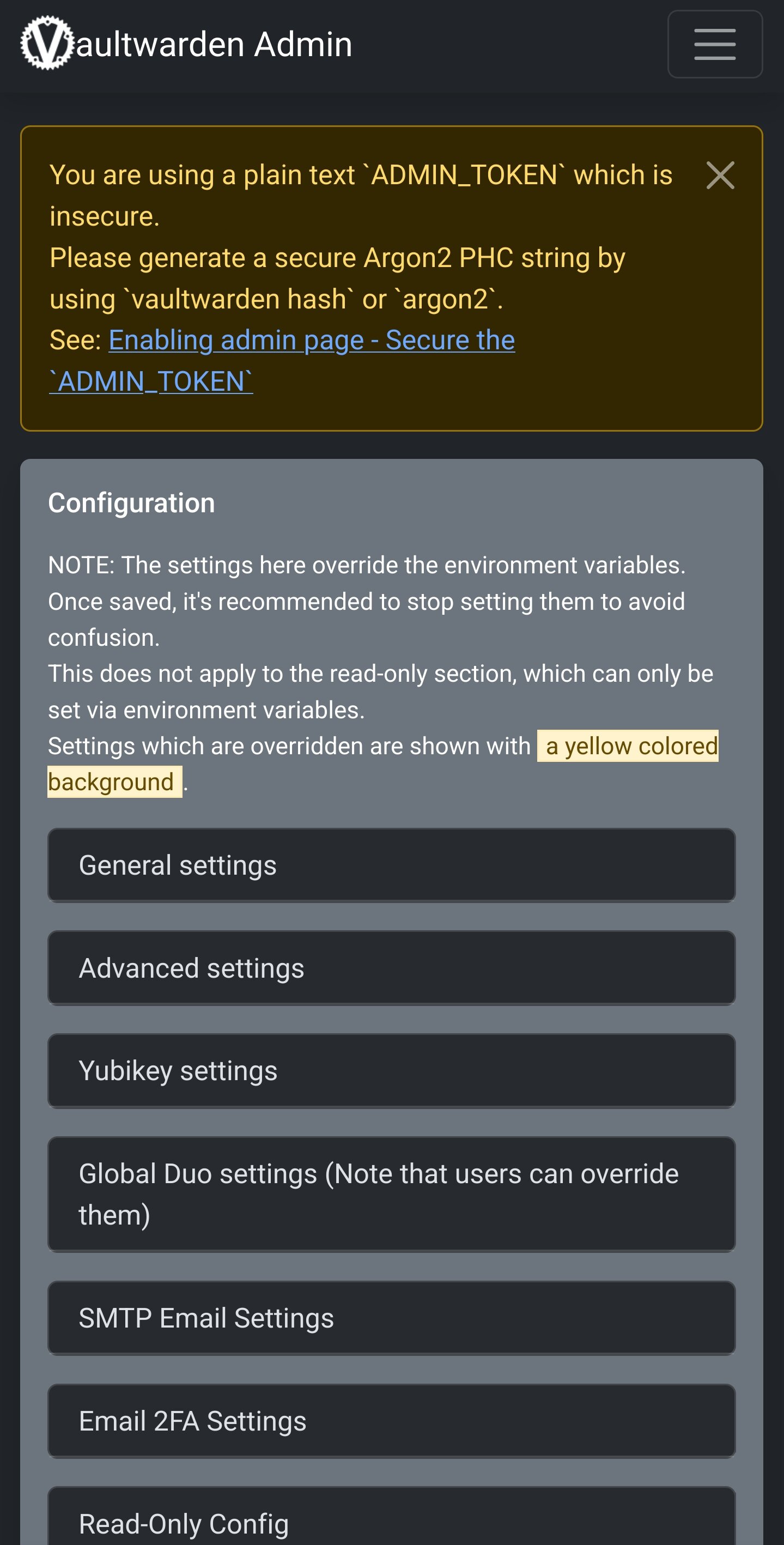

When I open the local page via http://x.x.x.x:4743 the page is loading forever but when I open http://x.x.x.x:4743/admin it opens the VaultWarden configuration site.
The same happens when a friend opens it from a different network.
Screenshot_2025-03-15-12-46-57-04_3aea4af51f236e4932235fdada7d1643.thumb.jpg.c1db6b1a213709295c341f1535b28f79.jpg
Screenshot_2025-03-15-12-50-45-12_3aea4af51f236e4932235fdada7d1643.thumb.jpg.0be1fdbfc90cc618c980f6937a993e72.jpg
In the admin General Settings did you enter your https cloudflare URL under Domain URL?
Yes, I did it for http and https.

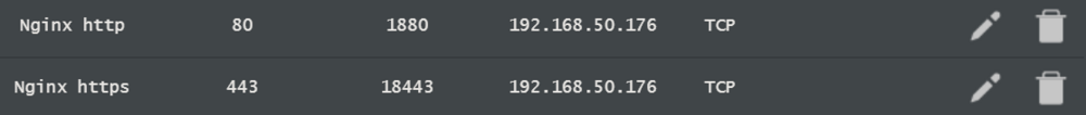

I don't understand. Can you tell me exactly what I need to change to make this work? Everything was fine until today. My redirects on the router look like this:
In Unraid, my settings are as follows:
I see that Nginx had some kind of update, so I generated new certificates, but it still isn't working.
