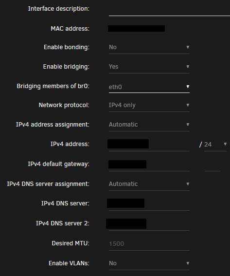

In the Network Settings:
You can have eth0 (Enable bonding: No AND Enable bridging: No)
You can have bond0 (Enable bonding: Yes)
You can have br0 (Enable bonding: No AND Enable bridging: Yes)
In the Docker settings:
You can have a Docker custom network type of ipvlan or macvlan.  This changes what type of network is created on eth0, br0 or bond0.
THIS DOES NOT CHANGE THE DEFAULT NETWORK TYPE WHEN USING
docker network create lan
You CAN create your own custom docker networks using ipvlan or macvlan and subnets and whatever.  But, under the hood, unraid does this for you.  Assuming you used the above command to create a network, it used the default bridge network driver.  Bridged docker networks do not give containers their own IPs that are exposed to your network, which you will need for the pihole container.
So, in your Docker settings, make sure you have "IPv4 custom network on interface eth0 (optional):" checked.
And in the pihole container, select "Custom : eth0"

This is my network setup:
And this is my docker setup:
(I left the 'Host access to custom networks' disabled , since I am running ipvlan and not macvlan)

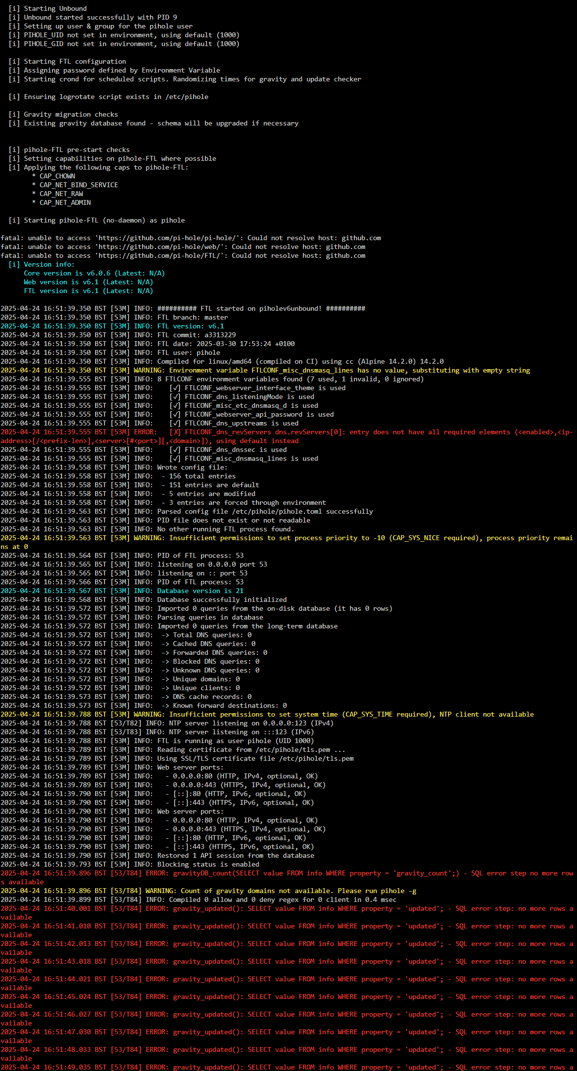

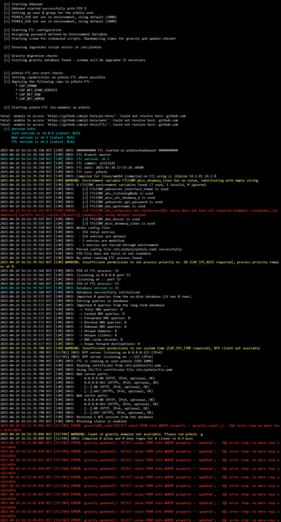

Hey so please go easy on me, I'm still very new to all this haha.
So basically was looking into Pi-hole and trying to set it up I've had nothing but issues and I have no idea if something is broken or if I'm doing something wrong.
I went to the "apps" tab and pressed install on the "pihole-v6-unbound" docker container, Changed the Network type to "Custom: br0" and assigned the Fixed IP to "192.168.1.5" and set the Web Password, Timezone and pressed apply. The container started and I couldn't open the WebUI so I waited 5 mins then restarted the container and I could access the WebUI fine.
So I logged in and in the top right under the "Domains on Lists" it just said "Error (-2)" and I just huh strange and clicked on it to see what that was about and a little box said I need to update my gravity list so I do that and just got "[✗] DNS resolution is currently unavailable" and " Waiting until DNS resolution is available" which I thought was strange so I clicked on the Docker contain in Unraid and pressed the handy dandy little "Logs" button to see what was going on.. aND HOLY SHI- I was met with this:Screenshot2025-04-24165648.thumb.png.113ffb39ca09e6ce95e4835c621f7b20.png
And then that basically goes on forever and keeps spitting that out.
What can I do? I've tried fully deleting the container, wiping any remails from the appdata share and reinstalling twice and I've tried changing the network type with no luck too and honestly I'm lost..

I actually fixed all the issues I was having and got it up and running now!
I went into the Tailscale plugin settings and set "Use Tailscale DNS settings" to No, then edited the Pi-hole container and changed "Rev Server" from false to true.
Loaded up the container, did the whole update gravity thing and everything stopped giving me errors! After that I edited the container again and set the "Rev Server" back to false and set the "Use Tailscale DNS settings back" to Yes and restarted the container and everything worked fine from there! No idea what part of them steps fixed it but I'm not complaining! :D Thanks for the replies and hope this update helps someone else in the future!

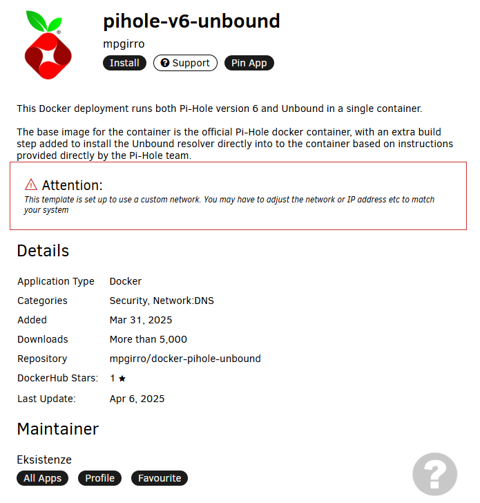

looks like a pihole v6
mpgirro/docker-pihole-unbound
finnaly hit the CA looks good.
@Alyred
as there are some major tempalte config changes... Zapyzap has yet to make and update a xml template for unraid CA.
This one works well and has the v6 ftlconf options.
