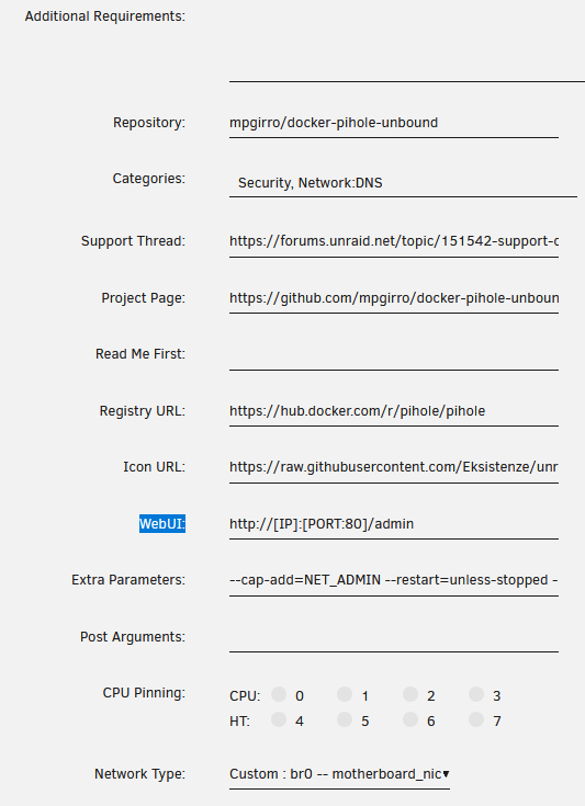

  4. @AnHero Very odd. The fact that you are able to log in on mobile implies that there is something going on with your computer. What I would do is clear your cookies and cache data and try it again. You browser may be holding on to old information so it's looking for something from that ip that it's not getting. Maybe also try from a different browser in private mode. Other than that, I got nothing.
  5. @AnHero I have no idea. At this point, I would verify that your pihole webserver is actually running inside the container but that's outside the scope of this template. Also, just to clarify, the WebUI: setting should be http://[IP]:[PORT:80]/admin and your HTTP: setting should be 80. Also, ensure you are going to /admin. Pihole does not offer a website on JUST the ip address. The /admin at the end is required. Example http://192.168.0.18/admin would work if that is still your address. http://192.168.0.18 would not and would give you a 403 access denied. Without knowing more about your settings or what error message you are actually getting, I don't know how to help you. @pmacdonald See this post for a breakdown on making sure your containers receive an IPV6 address. However, this is just the Unraid side. Your router would have to be properly setup as well.

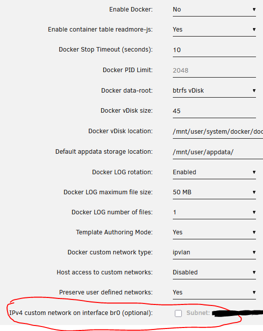

  8. Yes, the check mark is to tell Unraid to create the custom docker network when Docker is started. The Gateway is provided by your DHCP server, probably your router, and is normally the IP of the router itself. The DHCP pool is if you want Docker to only use a certain range of IPs. You can manually assign an IP to a container or you can allow Docker to do it and it will assign one in this range. This is normally accompanied by some setup on your router so that it does not give out those IPs to anything else. Your DHCP server will not assign an address to the Docker containers as Docker has its own DHCP. IMHO this is a much needed feature for Docker but it's just not how they have built it and I have yet to find any way of accomplishing this.
  9. Ahhhhh! Okay, I just replicated your settings and, if that option is not enabled, it doesn't show up with your docker service running. Set "Enable docker: No" and hit apply. The setting should then be available. You can then check that box and br0(since you have bridging enabled in your Network Settings) will be available(once you have started Docker again). If you are wondering what happens under the hood, since this is all just a GUI for the command line interface, these are just variables that the rc.docker script is looking for. The first thing it looks for is that box for the custom network creation. If that box isn't checked, it doesn't create a custom docker network at all, regardless of the type you have selected. It probably could be organized or documented better.

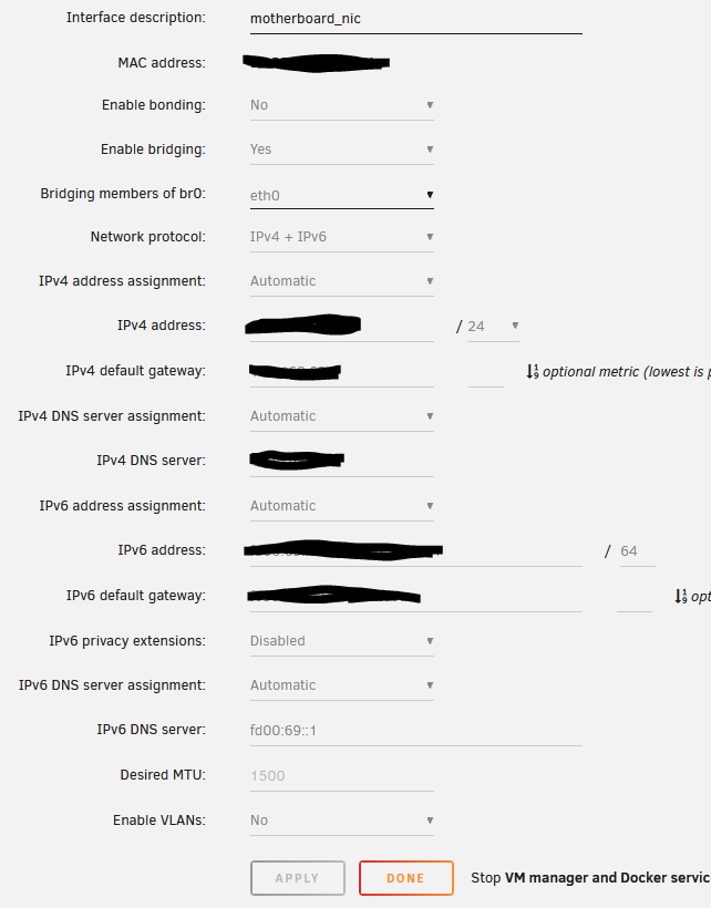

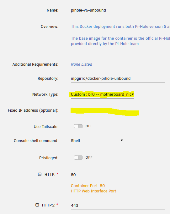

  10. br0 is not related to macvlan or ipvlan. In the Network Settings: You can have eth0 (Enable bonding: No AND Enable bridging: No) You can have bond0 (Enable bonding: Yes) You can have br0 (Enable bonding: No AND Enable bridging: Yes) In the Docker settings: You can have a Docker custom network type of ipvlan or macvlan. This changes what type of network is created on eth0, br0 or bond0. THIS DOES NOT CHANGE THE DEFAULT NETWORK TYPE WHEN USING docker network create lan You CAN create your own custom docker networks using ipvlan or macvlan and subnets and whatever. But, under the hood, unraid does this for you. Assuming you used the above command to create a network, it used the default bridge network driver. Bridged docker networks do not give containers their own IPs that are exposed to your network, which you will need for the pihole container. So, in your Docker settings, make sure you have "IPv4 custom network on interface eth0 (optional):" checked. And in the pihole container, select "Custom : eth0"
  11. Okay, Based on reading and my own experimentation, creating a custom docker network is just so that docker container(within the same docker network) can communicate with each other directly, as docker handles it internally, container to container. My example: bridge network subnet: 172.17.0.0/16 custom docker network subnet: 172.18.0.0/16 So all of my docker containers can talk to one another inside the unraid machine without hitting my router at all. When they DO need to enter/exit the unraid machine, they still do so using my unraid IP address assigned by whatever DHCP server I'm using. So if dnsmasq is using port 53 on your unraid machine, neither of these will work. I'm not sure how you have your network settings in Unraid. I will give a picture of mine. But Unraid itself will generate a custom network that allows you to set your own IP addresses within your network subnet. For me, this is br0. Then I can manually assign an IP for my pihole container. This is a separate IP address than my unraid machine and(hopefully) anything else on my network, which means all ports are available. This also means that any containers needing to communicate with pihole will exit my unraid machine, go through my router, and then back into my unraid machine to the pihole container. Additionally, you will probably need to do something in your router so that it does not assign your custom IP address. Without knowing what your setup is, I have no idea what that might be. I assigned the IP address to the MAC of the container as I am running a MACVLAN network. ***TLDR*** Use br0 or bond0 or eth0(depending on your unraid network settings and what it generates) and assign a Fixed IP address to your pihole container.
  12. You are correct, the default Bridge network does use the host IP address and you assign ports to different docker containers. There are problems with assigning port 53 in Unraid. I'm not sure of your particular setup but it seems to be related to VMs and Libvirt running dnsmasq on that port. What I do (and what I have in the template) is run the container on network br0. This will allow you to assign a "Fixed IP address (optional):" right below the network type. As for getting a dhcp assigned address, I have worked LONG and HARD trying to get that working for Docker containers. And I am positive there is a solution out there but I couldn't find it. Docker doesn't work like that out of the box. You would need to install a custom docker network driver and I broke my unraid setup trying to get this to work. Lemme know if that doesn't work for you.
