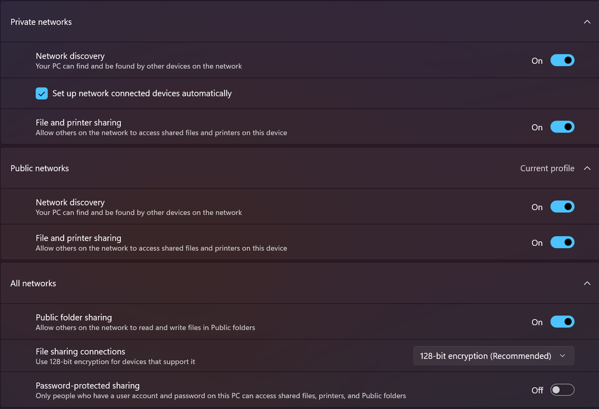

  • Set PC sharing settings as follows:
pc sharing settings
Adapter keeps saying "unidentified network" and cannot access Unraid GUI through the browser - "unable to connect".
Probably being stupid or missing something obvious, any ideas?

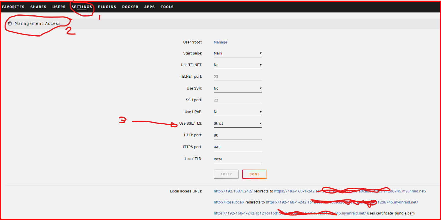

What does this say and what are settings:
Be sure to click on the 'Use SSL/TLS" to get the 'Help' for that item...
If you can't connect to your Unraid Shares via SMB, you will need a new Windows credential for that new Unraid server's  IP address to the Share Access user that you set up for this PC.
EDIT:  Remember that DHCP is not available using a direct connection, so you have to use IP addresses for all access!
Edited by Frank1940

Use SSL/TLS is set to No. Is that what I'd want for direct connection?
I set the static IP in the unraid network.cfg file the same IP as what the server usually gets assigned via DHCP that I use to login normally (and that is the IP that is saved under windows credentials (which has the username and password that I set up in Unraid).
I had set both windows and unraid to have static IP's in the same subnet, so unless the SSL/TLS should be set to something other than NO, I'm still not sure what I'm missing.

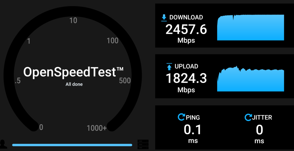

So downloaded the latest driver for my motherboard RTL8125B Nic from realtek website and installed on windows pc. Retested - slight improvement at 1.85G up.
Found THIS thread, suggested to update Unraid (I was on 7 but now on 7.01). Also installed the Realtek RTL8125(B) plugin in Unraid. Rebooted both server and PC. Ran OST again. Results:
Open Speed Test
Do you think it's worth spending out ~£35 to buy an i226 intel NIC to put in PCIe slot in motherboard to avoid using the Realtek motherboard NIC? do you think that would give me the full bandwidth in both directions, or is this more likely a settings configuration issue? what about stuff like MTU / jumbo frames, interrupt moderation and other stuff mentioned in THIS guide?

There was a suggestion in the linked reddit thread that it may help fix bandwidth in both directions. Thought it was worth a shot. Also changed MTU to 9000 and Jumbo Frames in windows to 9014, disabled interrupt moderation but maxing out at 1.85G up.
Oh well, will keep playing / searching.
Thanks all, for your help. If I get any joy I will post back.
It just dawned on me that the NIC in my Linux client is also an i226 intel. OST results are 2.5g down and 2.0G up.
So I dont think it's related solely to the realtek nic. Got to be a setting somewhere. Or it couldn't be related to an old GPU I have installed in the Unraid server could it?
Try setting all the MTU settings to 1500 and turning off Jumbo frames.  (They have caused problems in the past...)
