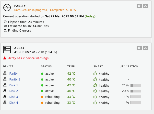

Now in the moment i have returned the x2 2.5" SSD which were removed before, and after start on the array it has started itself with Data Rebuild, but on those disks there was nothing. They were empty.
