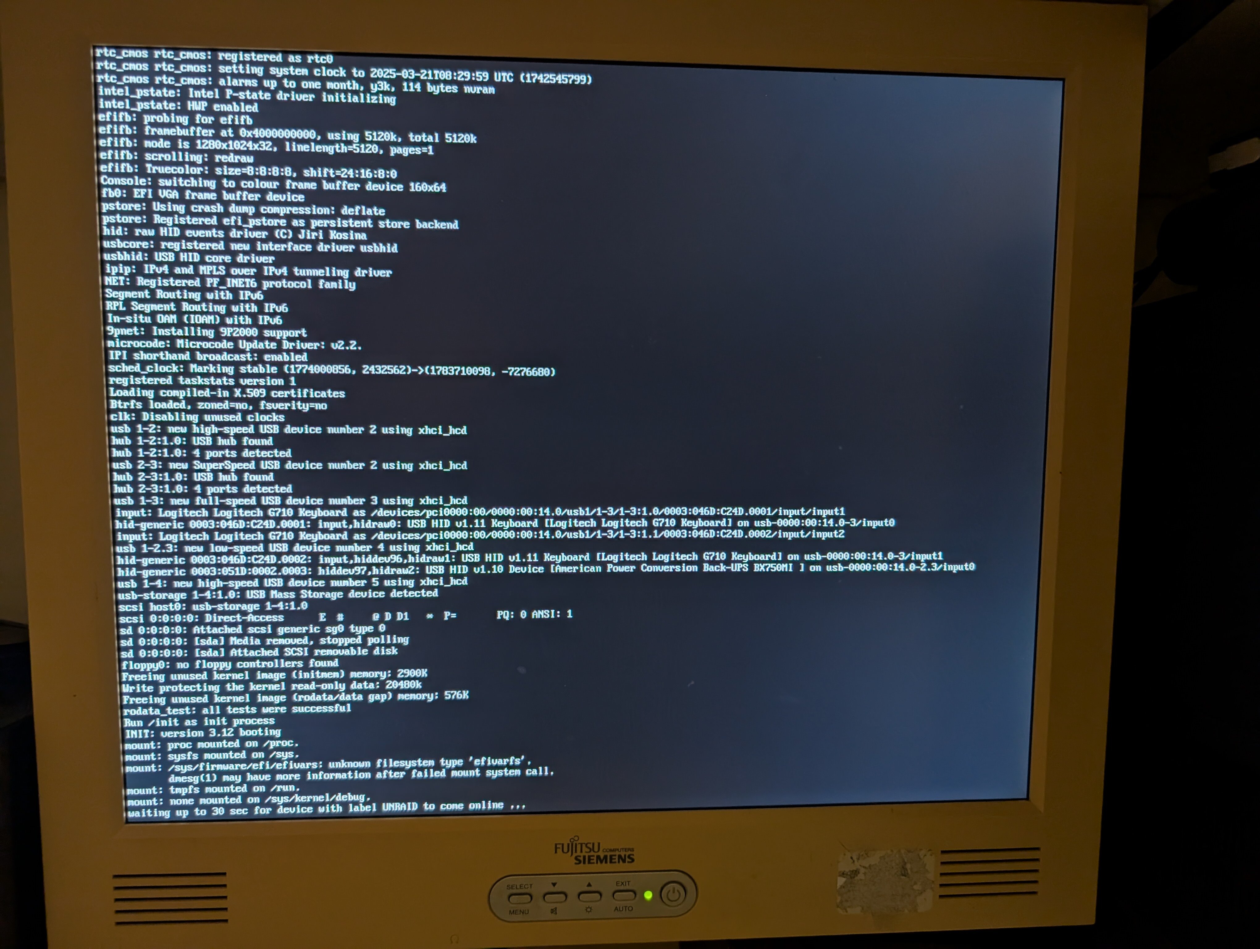

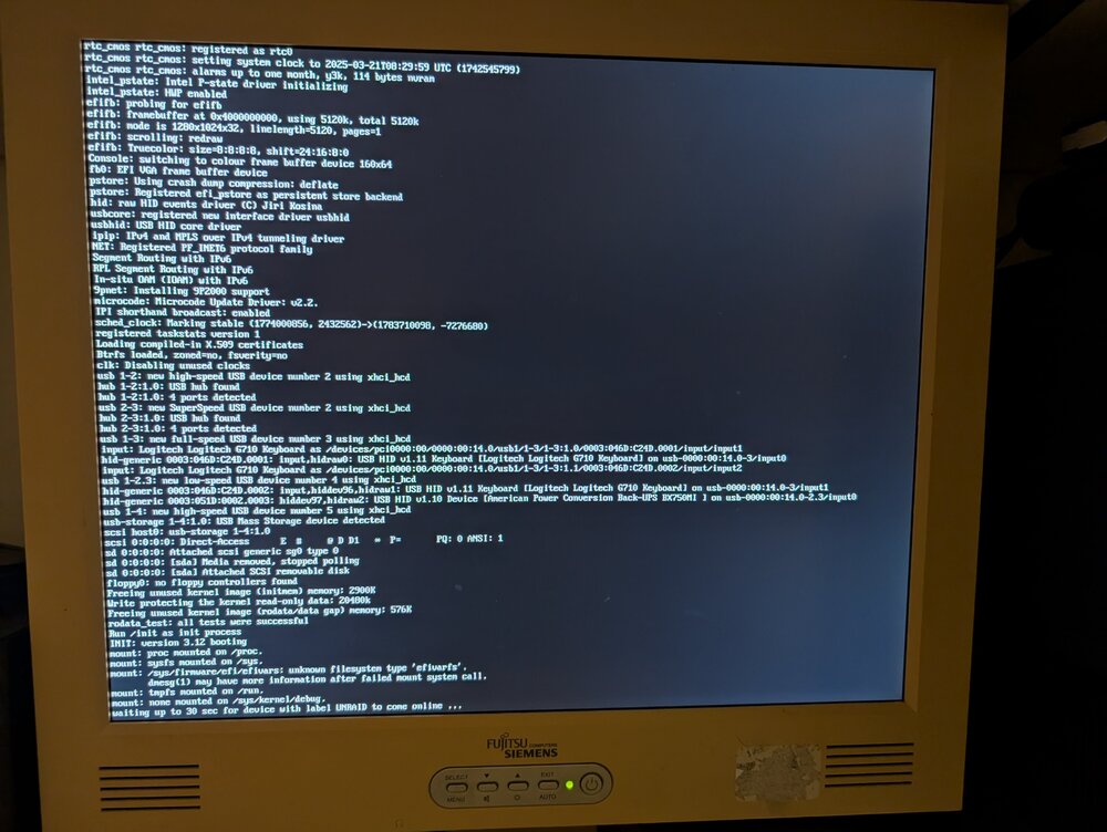

Edit: Screenshot from booting. It seems it is ejecting the usb-device: sd 0:0:0:0: [sda] Media removed, stopped polling

If there are only 10 devices it suggests it's not the same issue, post a screenshot of the screen after it stops.

The flash drive is being detected as sda, the 1st device, so unrelated to the issue being discussed on this thread:

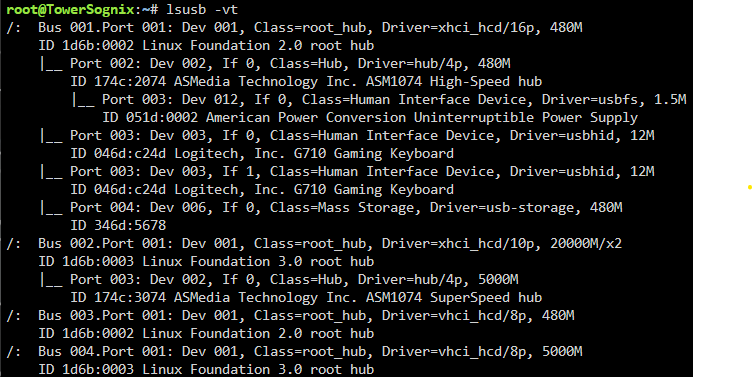

lsusb -vt:

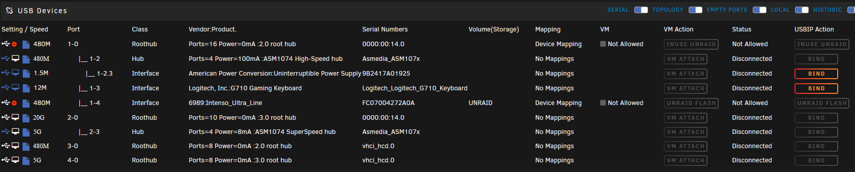

I also have installed the USB-Manager Plugin, if this gonna help:

Not seeing the flash drive on lsusb, or is this it?
During the lsusb the Unraid USB-Drive was the only active drive which was attached via USB. So yes, it has to be that one. It es an Intensio 32 GB USB 3.0 Stick, just 2 weeks old. The Stick before was also an Intensio and worked very well with Unraid 6. Changing to Unraid 7 the problems began, with the old one (as I already said, I thought maybe the stick was dying so I changed) and with the new one.
You can also see it on the 2nd screenshot in Port 1-4, which should be in lsusb Bus 001 Port 004.

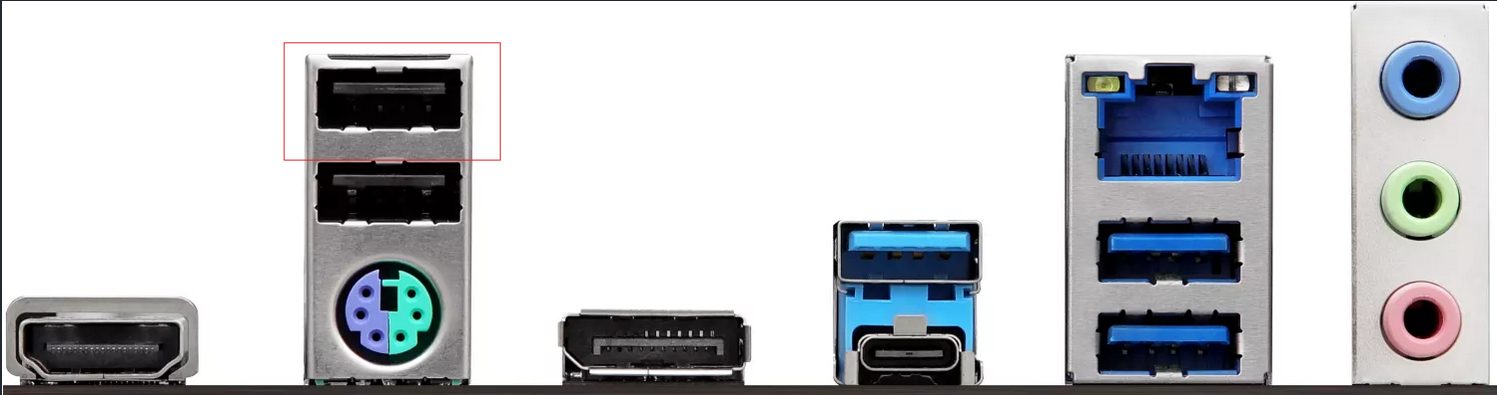

The Stick is in this port:
In the neighbouring port is the Keyboard, the USB-C and neighbour are free and in the USB 3.0 ports next to the LAN are a turned off external USB-Drive, and the USB-Connection to my UPS. I also tried the other ports, but it's the same.
Try booting with a different flash drive, no key needed, then post the lsusb -vt output from that, P.S. going to move this all to a new thread, since it's not related to this issue.
