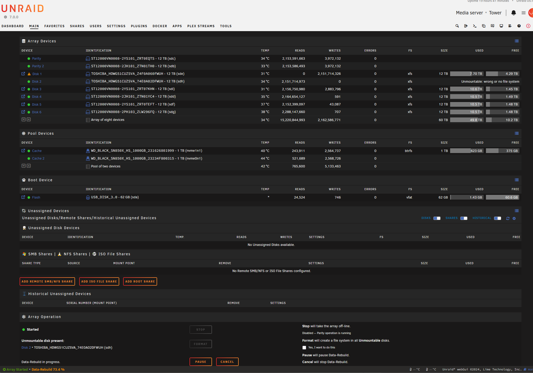

After Swapping Drive, Previous Drive says Unmountable: Wrong or no file system
I recently rebuilt/upgraded a 4TB drive to 12TB without issues and am doing the same thing with an 8TB drive to 12TB, but after assigning the new drive and starting the array, the previous drive says "Unmountable: wrong or no file system". Wondering on next steps as the new drive is being re-built and the Array Operation section says Unmountable disk present: Disk 2 and gives me the option to Format. I believe my best option is waiting for the re-build to finish on the new disk, then format the "Unmountable" disk which was just re-built last week but looking for options and what this really means and why it might have happened.
Prior to adding the newest disk, the newly built disk had no issues.

First check filesystem on disk1, since there are errors spamming the log, then reboot and post new diags after array start.
Disk 1 is the one being rebuilt from 8TB to 12TB currently - has a couple more days til it's finished before I can reboot. I can wait til then, then post the logs and determine next steps.

NO! You must not format any disk that has data you want to keep.
Emulated disk1 does have some corruption that will have to be repaired, but it is mounted and shows 7.1TB data.
Disk2 is too corrupt to mount so we will have to try to repair it to make it mountable.
Since you rebooted before getting diagnostics can't see what happened before boot.
Might actually be better to stop rebuild since you are rebuilding the corrupt filesystem on emulated disk1.

If Disk 1 finishes rebuilding, can't Disk 2 (Rebuilt last week) be rebuilt again without issue?
Should I replace the new disk with the old one and let a parity check happen, then try replacing it again?
Rebuild won't fix filesystem corruption. It needs to have filesystem repair. Click the check filesystem link.

So, My steps would be to:
- Stop Current Rebuild
- Perform File System Check
- Upload new Diagnostics
I'm also a bit thrown off that Disk 2 became corrupt when it was rebuilt/replaced last week and I only touched Disk 1 last night to replace it.
I do still have the option to replace Disk 1 with the old 8TB drive if that helps my scenario.

ok - Cancelling Rebuild and will do a File System Check
How long should I expect the FileSystem Check to take?
Currently it's been over 90 minutes.

Out of curiosity, I ran a FileSystem Check on Disk 1 and received the following output - is this expected since I stopped the data rebuild on this disk? or is this a different issue? Should I run a Fix on this as well?
