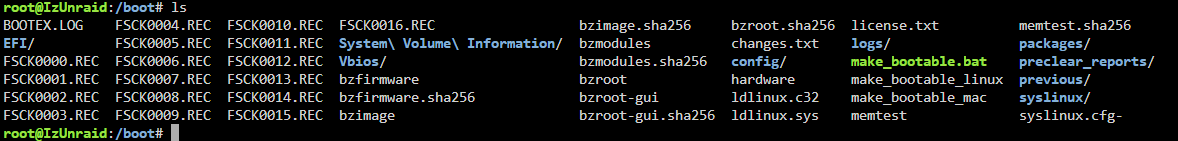

I appreciate you taking the time to reply. Looking into the boot folder, I find  no folder named "extras"
So I have no idea where to find this "extras" folder, or if I am looking in the wrong area. Also, yes, I am aware that "Python for unraid" will do as you said, but instead, it will keep track of updates and make it easier for me to uninstall Python if need be, as I currently need to uninstall Python.

ooh, sorry, my fault... its /boot/extra (without "s" at the end).
But I see from your listing that you do not have this either.
You have the non-standard "packages" folder. whats in there???
(dunno where it may belong too)
AAAH! just looked it up... its a leftover from the not-anymore-existing plugin "nerd-tools". Obviously it is still honored at reboot time. So I would guess you will find your python here. Clean it up and reboot (also clean up everything else in this folder, because nerd-tools are gone and no updates will happen anymore. If there is "needed" stuff you have to find a new way to install it (like python which now has its own plugin))

I looked into that "packages" folder, which is used by "Dynamix File Integrity."
I used the command
"grep boot/packages /boot/config/plugins/*plg"
I found it from this Forum post: "https://forums.unraid.net/topic/44333-packages-in-bootpackages/" General Support—Unraid. You are correct; I did have nerd-tools initially installed. I deleted that folder from /boot/config/plugins.
