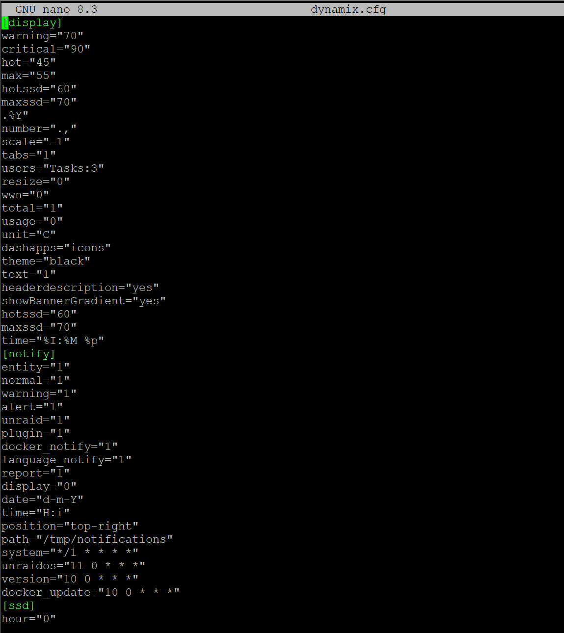

Apr  6 12:38:42 Kevflix root: Fix Common Problems: Error: /boot/config/plugins/dynamix/dynamix.cfg corrupted
17 hours ago, trurl said:
Maybe related to this:
Ohhh it does look like that would do it.
I do not have a backup of the file guessing the below has something wrong with it somewhere, guessing after maxssd.
You can delete that file to see if helps, will need to reconfigure some GUI settings, since they will go back to defaults.
