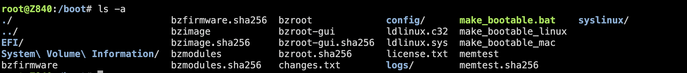

I attempted to locate the /boot/extra directory, but it is missing. I presume that this was a directory in previous version of unRAID and no longer available over my version. When I navigate to the boot directory, this is what I see (see attached image).
