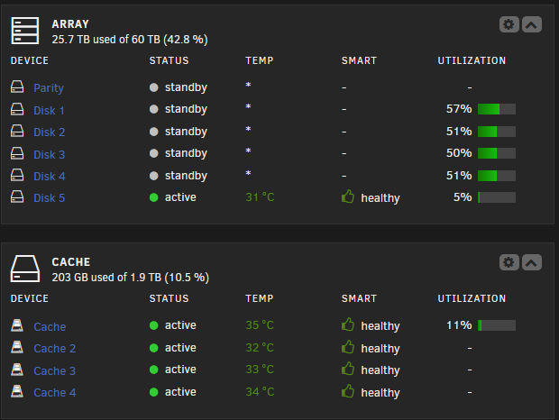

Writing data to a POOL outside of the array should prevent your issues. That's how 99% of us use unraid. See my own server setup below:
My ingress is straight to my Cache pool which is dual mirrored. Cache and Cache2 are mirrored and Cache3 and Cache4 are mirrored and then the two mirrors are RAID0 together for speed and resiliency. After this my data is sent to the array each week at night when server activity is low. No bottlenecks even if Sabnzbd is downloading and unpacking files.

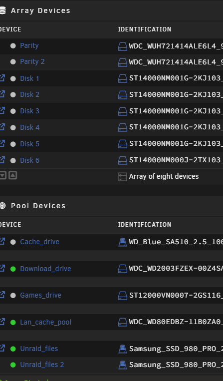

so my drives are like this in the pic..  but i still find is slow as molasses  even if you play a video off the array  it can be slow even if the drives are spinning and not sleeping
so i have 1 drive for Cache sata,  1 drive for Lan Cache, as my internet slow less then 5megbit so i use a lanche..  a download drive for misc downloads  and then i move to array
games drive i was playing with for network share  so you only have to install game 1 location but have a dual boot windows 10 11 and point to it   was playing with it
and then i have dual 2tb nvms  for my unraid files..  iso, vms, appdata  as i found plex was always slow and still slow at times...
i using a Asus ROG STRIX X570-E motherboard so only has 2 nvmes  on there
your setup i take it ur using 4 nvmes?   and if so how do you do it...
There's a lot to unpack here, this post is kinda all over the place so bear with me as I try to organize my thoughts based on the information you've provided. We got different things going on here now.
Let's start with the initial concern... To me based on the iperf3 test it sent a total of 10GBytes of data at a speed of 9.15Gbps indicated by the results you've provided. You got your 10Gb/s. We know it works.
To transfer data to unraid at that speed to a disk drive, you will need to be writing that data to an NVME drive exclusively. Any single disk connected to a SATA port will not be able to hit those speeds. HDDs cap out at around 250MB/s and Sata SSDs cap out at around 500MB/s both well below 1250MB/s (10Gbps) Also keep in mind that to hit 10Gbps it will need to be a single large file transfer with sequential writes. Transferring a bunch of small files will kill the speeds. Just how it works.
For the second portion, you're talking about plex being slow, not really sure I can help you with just that tiny bit of information.  What does "being slow" mean? Media playback off an HDD doesn't need a whole lot of bandwidth even for 4K remuxes (full fat 4K non-encoded media). You can easily stream a few 4K remuxes off an HDD and be nowhere near maxing out the bandwidth of the drive.
Hopefully your plex metadata is in your unraid_files pool as that's where thumbnails and stuff area loaded from.
11 hours ago, comet424 said:
and ya its so annoying  when you copy a file  it will even stop the video  or  it wont even allow a video to start in vlc  it will just keep running that yellow line for loading and it may stay stuck 5 min...   till the copying is stuck.. is that all due to the copying straight to the array..
You shouldn't be copying files to the array directly. If you're doing this, you're going to be fighting parity calculating (reading and writing to two disks) while you're also doing reads, this will cause hiccups for media playback. All your incoming newly written data should be hitting the cache pools first. Mover should handle moving data from cache pools to the array, and you should have this scheduled for a time when server activity is low.
Also Im noticing you have HDDs as some of your pools, while there isn't anything wrong with that, you need to keep in mind the speed limits of HDDs. 250MB/s max speeds but only when doing large sequential writes it will be much slower if you're doing something like downloading and unpacking archives.
NVMe drives aren't capped at 500MB/s they typically are around 3000MB/s but can be much higher depending on the generation of PCIe. PCIe Gen 5 NVMe speeds can hit nearly 7500MB/s reading and 5000MB/s writing.
I think your "issue" is maybe part misunderstanding how unraid works and a misalignment of expectations. I can't really see a physical issue here other than I think you just need to optimize where you're writing data to first.
Here's how I would arrange things. Use the two NVMe drives (unraid_files) for both appdata and file-transfers/downloads from LAN devices.
Use the  "cache_drive" pool drive for downloads from the internet if you're downloading from usenet or torrents. Make this your new download_drive.
Keep the HDD pools and your array mostly as they are except for the "download_drive" don't use that one for file downloads because it's going to severely limit your speed. Either find a different purpose for it or maybe consider adding it to the unraid array.
Lastly, if you want to add more NVMe drives, you will need to get a PCIe add-in-card that houses NVME drives and you also need to make sure bifurcation is supported in the BIOS and set it to "x4 x4 x4 x4" mode. This will be required to occupy the top PCIe x16 slot (closest to the CPU). This will allow you to add in up to 4 NVME drives and they each get x4 slot allocation.
