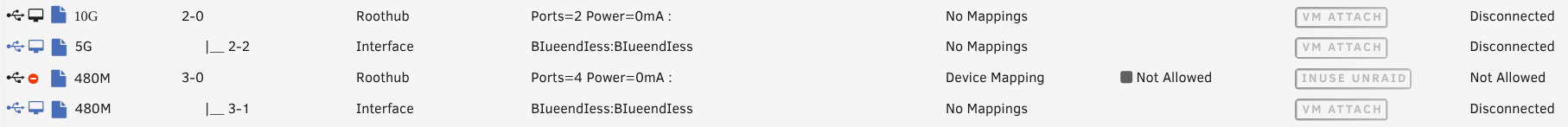

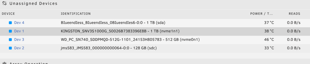

I'm new here and currently reviewing unraid with a trial license. But want to purchase it if its functionality checks out. Anyway I see my external nvme enclosure in system devices but i dont see the disks in the main tab.
Any suggestions? Happy to upload my diagnostics.
Thanks in advance...

List of USB devices from an app
I'm not referring to only those drives. Your other drives are also USB

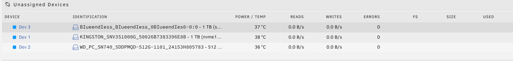

Nope i only plan to use the following + the sdb thats not showing up. So 2 internal drives and 2 external drives

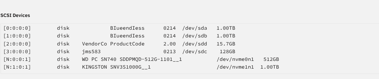

Apr 19 16:13:55 Tower emhttpd: device /dev/sdb problem getting id
The problem is that both devices from that enclosure show as with the same name and serial, Unraid requires that all devices have a unique ID, this is a common issue with some USB enclosures, and one of the reasons they are not recommended, but some do work correctly, and there are users using them.
