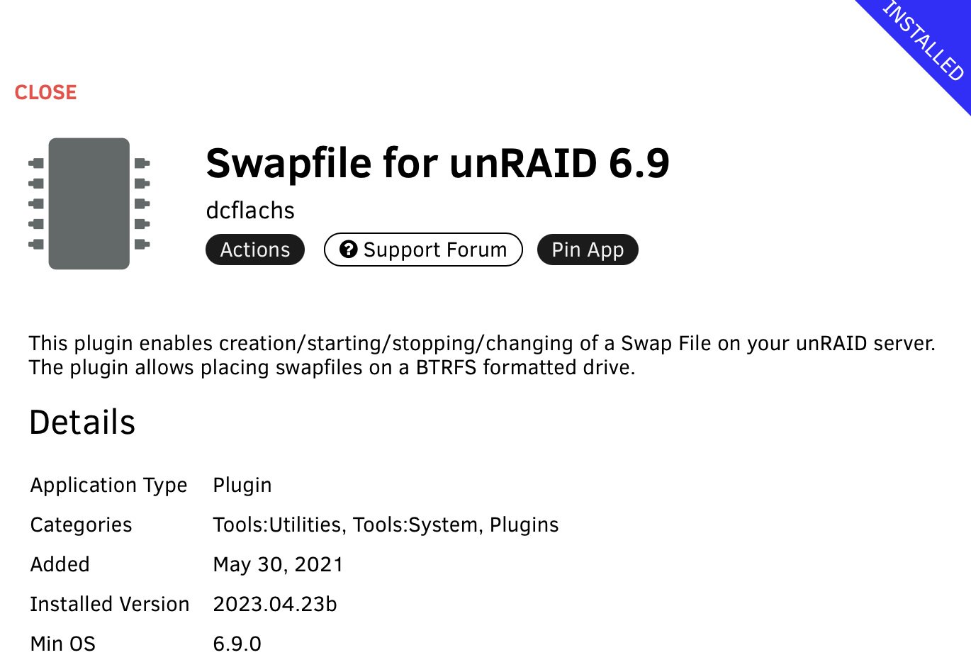

I resolved sporadic OOM errors with the swapfile plugin.
My swap location is a simple single-drive XFS mount so I can't say how well it works with more complex setups but for me it's worked perfectly. Set-and-forget.
Could you tell me more about this? Sure I could google it but I'm a bit distracted right now
The plugin creates a swap file on the disk to act as extra "memory."
I set mine to 25% of total RAM. Nothing more to add really - just works.
There's more detail in the support thread.
