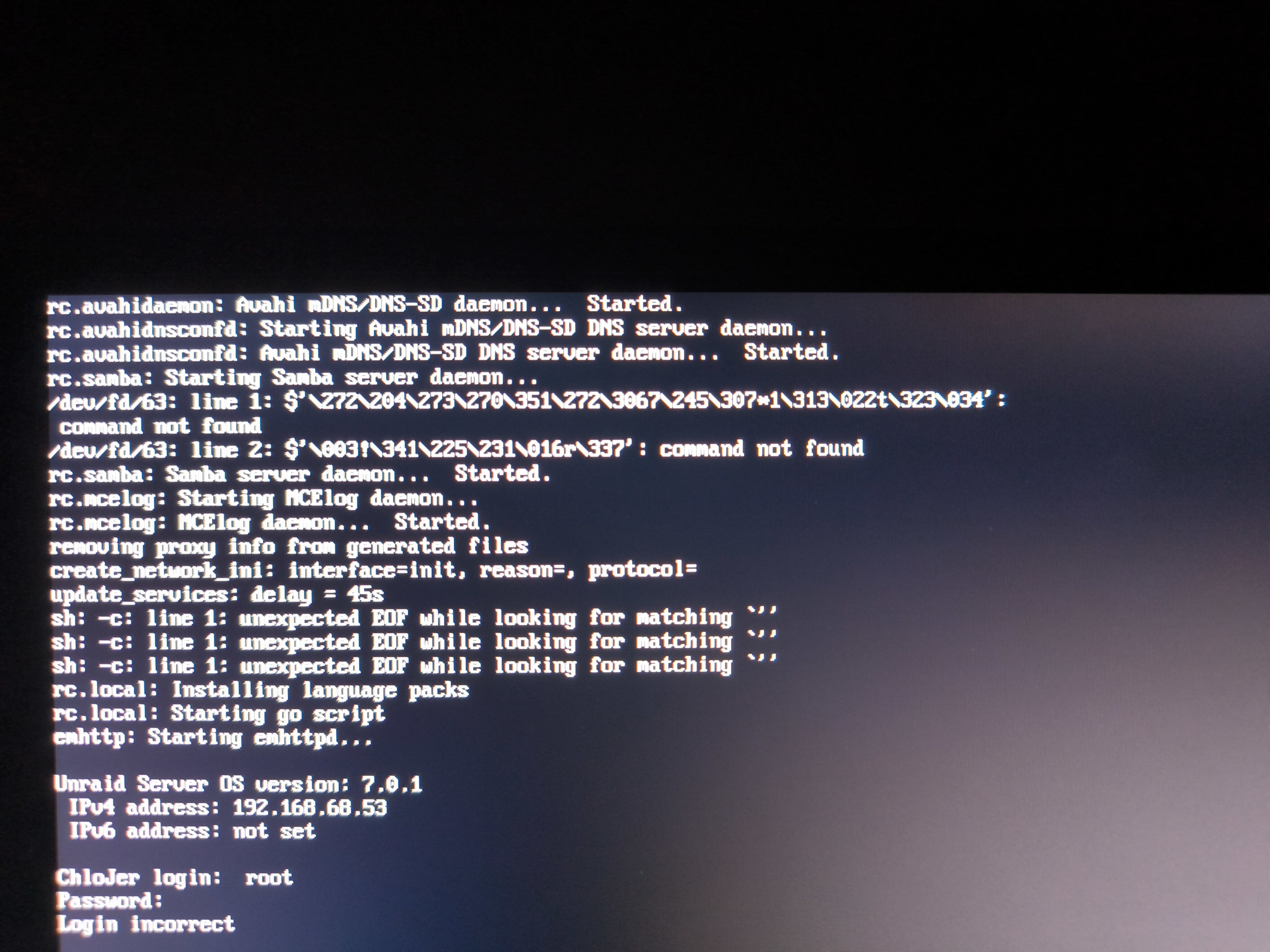

It wasn't until now that I found a quite moment to plug in a monitor & keyboard, and to my surprise, I was met with the indication that the server is up and running (see picture attached/below) yet, through the new IP nor the local address, I was able to connect, getting http 500 errors.
Any idea as to what is happening, how to solve it and how to prevent it for the future?
Additional info: I wasn't able to install unraid connect, or backup my flash, gather diagnostics,... Luckily I didn't have any important info stored yet.
If you can access the command line from the attached keyboard and monitor then you can try to get Diagnostics. Click the link for instructions.

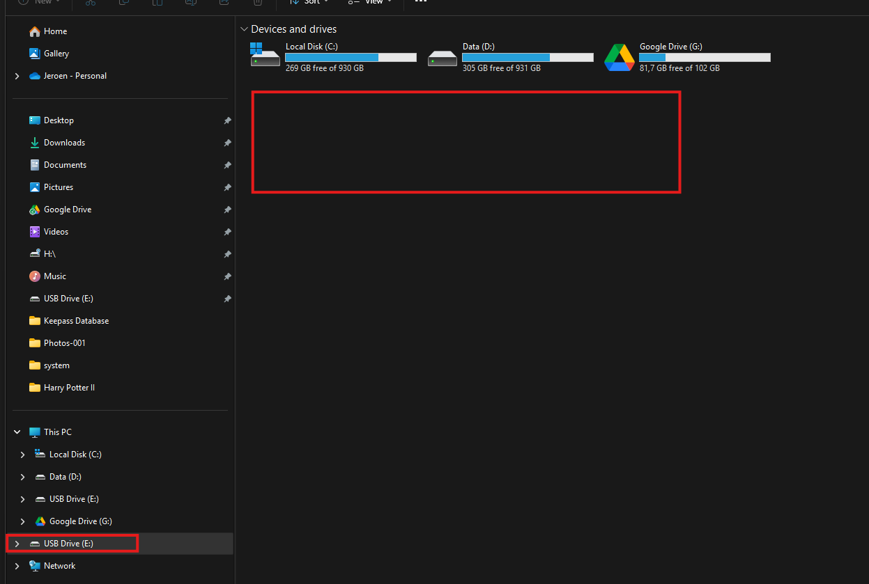

I ran the "diagnostics" command, but I'm unable to retrieve the zip, as the USB is not even showing up in Windows properly.

In windows it was impossible to get dskchk to work on the USB.

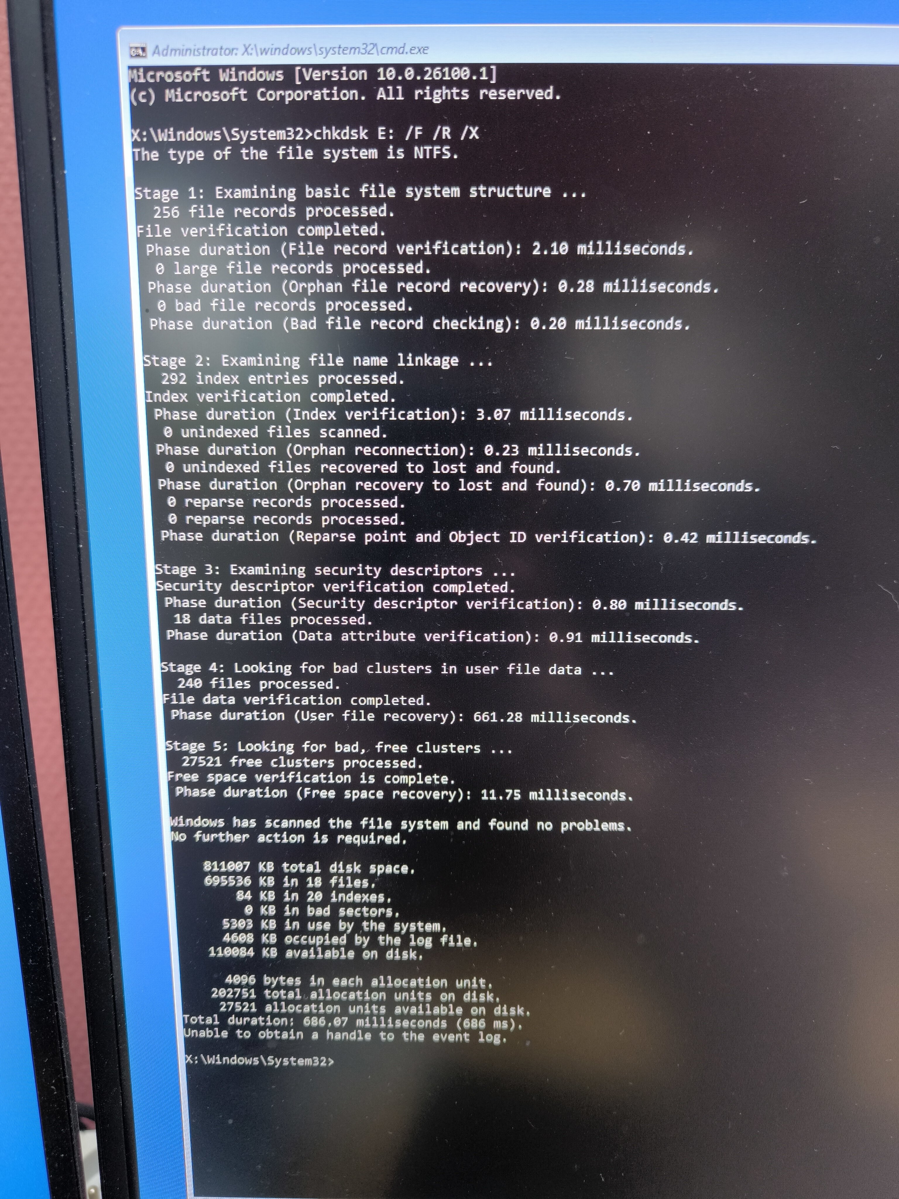

In the end I managed to do it in recovery mode (see image) but after rebooting, the drive still wasn't accessible, disk management still failed to properly load and checkdisk in cmd didn't do anything.
Also noticed that my computer didn't want to shutdown or reboot if the drive was inserted. Diskpart only ran without the device plugged in.
I fear this drive is a lost cause and I'll need to buy a new, better one
seems so
