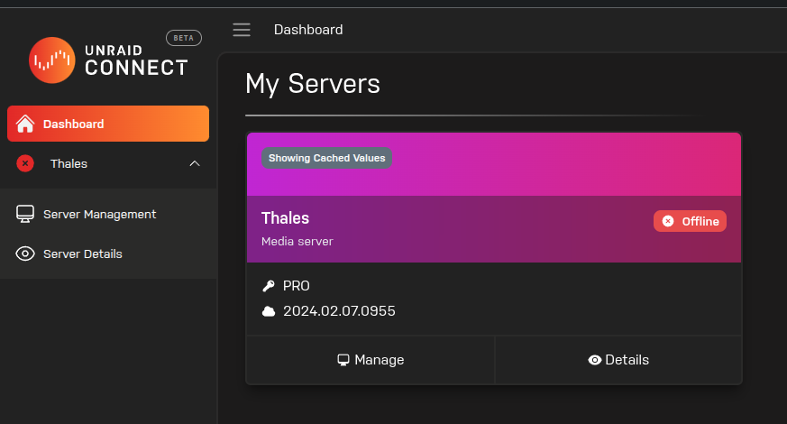

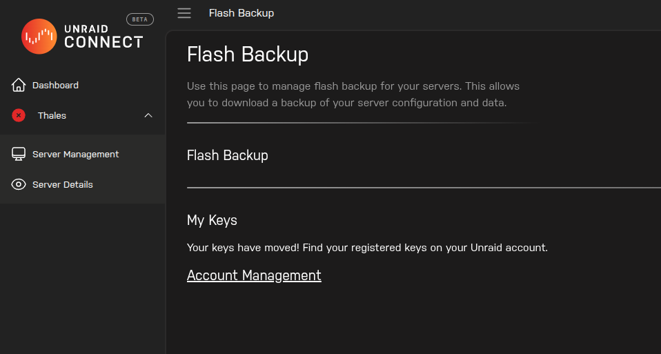

My flash drive has failed and the my unraid server cannot boot. The problem is that I don't have a backup and my situation is a bit complicated. Normally I have the My Servers plugin keep a flash backup on connect.myunraid.net. A couple of months ago I downloaded unraid for a test server and I connected it to my account to get a trial key, which I ended up not using. The problem starts from the fact that somehow procedure messed up both my accounts at conect.myunraid.net and account.myunraid.net. On the first site I see my server (as offline) by there is no flash backup.
ksnip_20250426-163511.png.4b839a6438816dd1fc7cbb6f49da2b75.pngksnip_20250426-163536.png.b5e4ab1b0b303e2a5b7089f903d5a336.png

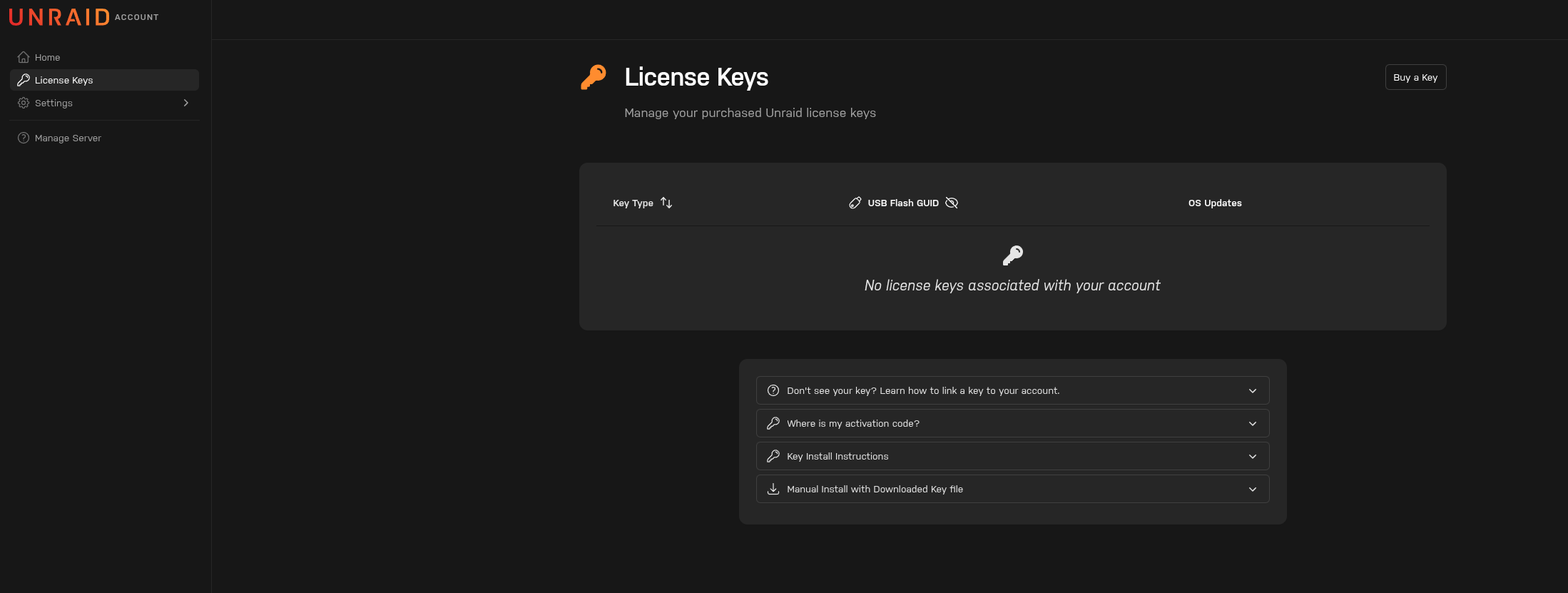

When I click the link to get my key on the second site it shows that I have no license keys!ksnip_20250426-163558.thumb.png.4c6bbe9fb6ea706d4962c3e15f8b2d53.png

On a separate note I think the safest procedure would be to create a new flash drive using Unraid's USB Creator, overwrite the config folder from the opiginal flash drive and attempt a boot with that. Right ?
And one more question. As I understand it the license is linked to the GUID of the specific flash drive. I have the the original email by Limetech, from when I bought the pro license for Unraid. How do I go about moving that lecense to the new flash drive?
Thanks for your time...
Vassilis
Success!
So, the server is up and running again. I created a new flash drive using Unraid USB Creator, copied the config folder to it from my original flash drive. After the server booted up I was able to assign my lisense to the GUID of the new flash drive and everything looks great.
