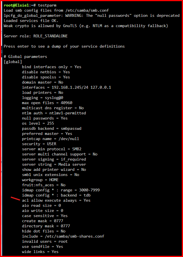

Here's the [global] output from 'testparm' run in the root terminal shell in the Unraid WebUI:
[global]
bind interfaces only = Yes
disable netbios = Yes
disable spoolss = Yes
interfaces = 192.168.68.102/24 127.0.0.1
load printers = No
logging = syslog@0
map to guest = Bad User
max open files = 40960
multicast dns register = No
ntlm auth = ntlmv1-permitted
null passwords = Yes
passdb backend = smbpasswd
printcap name = /dev/null
security = USER
server min protocol = SMB2
server signing = if_required
server string = NAS
show add printer wizard = No
smb1 unix extensions = No
fruit:nfs_aces = No
idmap config * : range = 3000-7999
idmap config * : backend = tdb
acl allow execute always = Yes
aio read size = 0
aio write size = 0
create mask = 0777
directory mask = 0777
hide dot files = No
include = /etc/samba/smb-shares.conf
invalid users = root
map archive = No
use sendfile = Yes
wide links = Yes

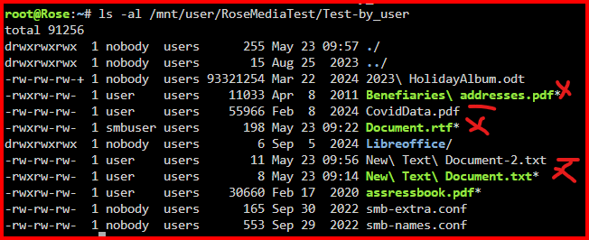

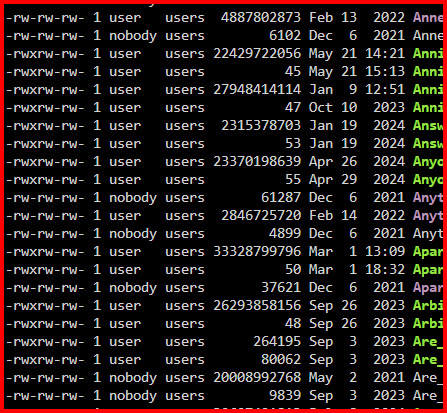

I decided to have a look at my File system (because in the back of my mind was this feeling that I had seen something vaguely familiar). Here is what I found:
Notice that the Execute bit is set for the Owner an many of these files. Notice that they are mostly newer files.
Let me further state that my Networking environment is strictly a Windows one. The principle involved in transferring these files to my Unraid server are running Windows 11 Pro (23H2 and 24H2 for the time involved for the execute bit being set). Here is portion of my testparm output:

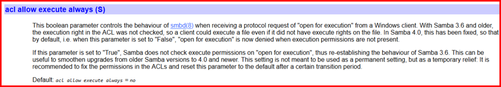

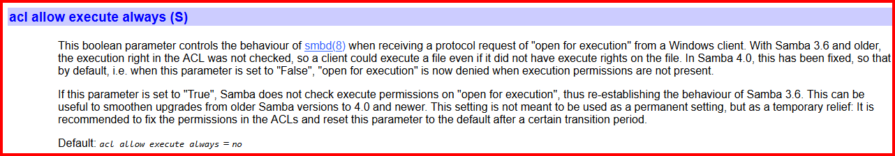

Notice the parameter I have marked. Here is the description of what it does:
Observe that the default is 'no' but for some reason Limetech has chosen to set it to 'yes'. (The short testparm output shows only those parameters which have been changed from the default.)
The point I am making is that is not only Mac OS problem but it exists in the Windows-only environment, too. I know that I would ignored it when I first noticed because Windows uses the file extension to determine if a file is executable or not.
Here is the link to the Samba document for the above screenshot:
https://www.samba.org/samba/docs/current/man-html/smb.conf.5.html
