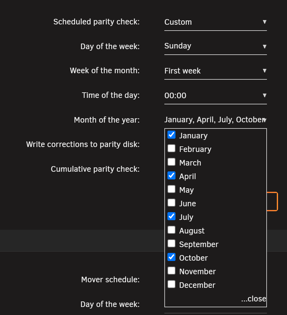

Good morning, I've been having a problem for about a week now that I can't solve. Unraid checks my parity daily at 00:01, but I actually have it set to check every two months.
I don't know what's going on here; here's the configuration:

That screen shot shows that during the selected months you will check every day - not what you want I think?

That is because you have it set to run every day/week during the selected months.   The settings you have set are incompatible with what you want.    I have a feeling the only way to get it to work like you want is to not have the Day and Week settings set to be "every"

Looking at it, I think you're right. That every day runs the entire first week of each month... I've set it to run on the Sunday of the first week of the month (every 3 months) to see how that works. I think 3 months is fine to check parity? Or any other advice here?

I think that there is a good case for the "Every Day" and "Every Week" options to be removed from the GUI as both of these are far more frequently than is required.
