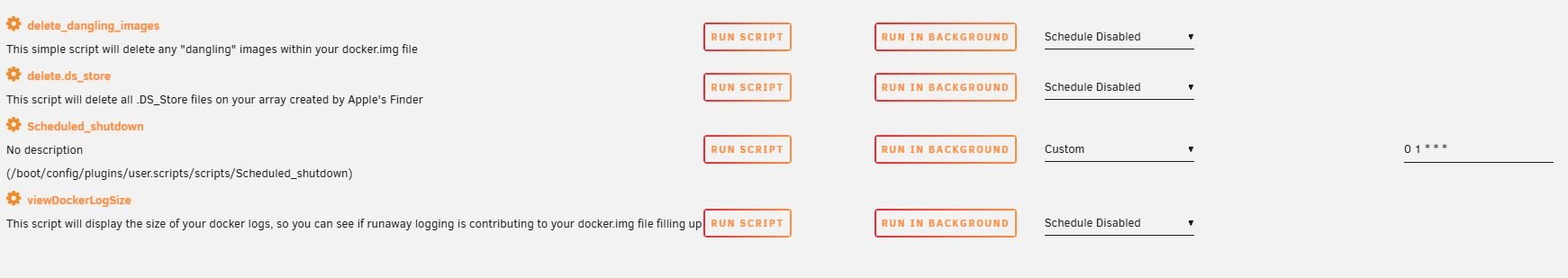

Post a screenshot from the user scripts plugin page.
This is what I have
But I think I forgot to click on "Apply" then "Done" yesterday, so will see tonight (tomorrow morning actually) how it works
Edited by French-Guy
Looks like it works.....I can't guarantee it shutdown at 1:00am, but it was off this morning
