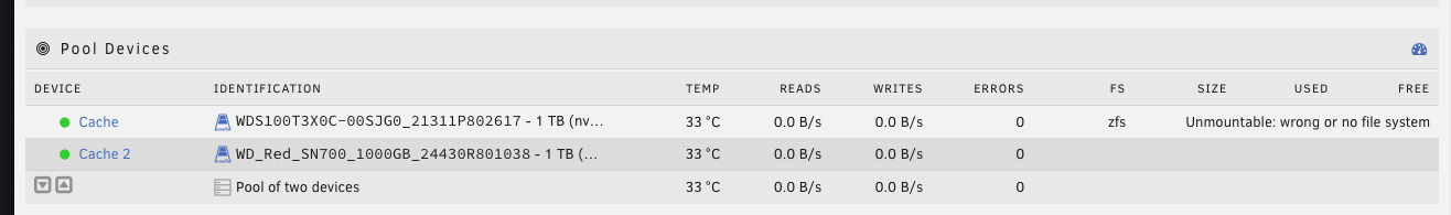

Unable to mount ZFS Cache Pool after upgrade from 7.0.1 to7.1.2
I installed the unraid upgrade from 7.0.1 to 7.1.2, after the reboot the cache pool shows as: "Unmountable: wrong or no file system".

How can I get the cache back online? It's a pretty bad situation as the docker service files are stored on the cache and therefore docker does not run.
Thanks for your help.
