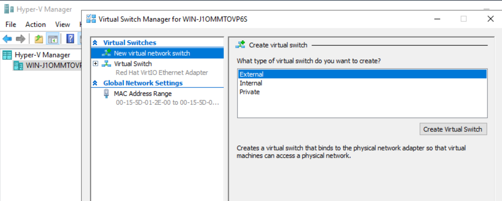

I'm trying to install a Hyper-V Server VM which should host other VMs.
My Hyper-V Server is working (network access), but underlying VMs aren't.
I saw that for a nested Hyper-V you should enable MAC Address Spoofing for the VMs, but unfortunately isn't working.
To be noticed that the Hyper-V VM is using a custom network which is on a VLAN, and I'm using MACVLAN (because I need that my Docker have a fixed reacheable IP Address).

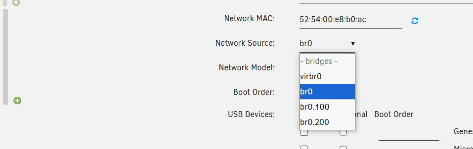

When using macvlan the interface type is normally vhost rather than a bridge.
This is my XML.
    <interface type='bridge'>
      <mac address='52:54:00:d5:b6:c5'/>
      <source bridge='br0'/>
      <target dev='vnet0'/>
      <model type='virtio-net'/>
      <alias name='net0'/>
    </interface>

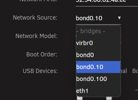

Try setting network to vhost0.10 in for the network in the vm template for the network source. You should have vhost0.10 as an option.
Hello0,

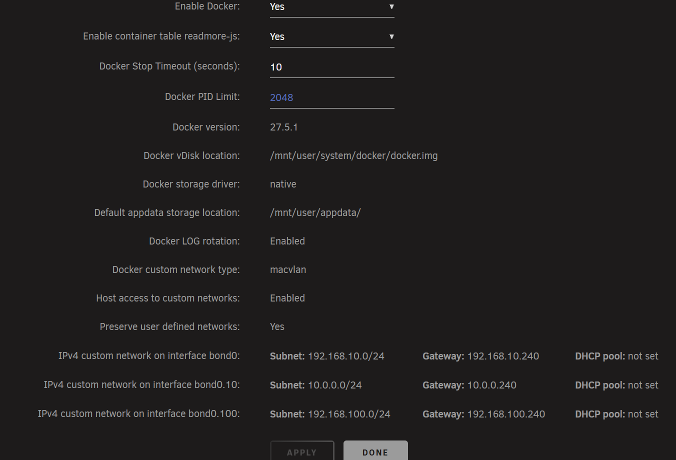

I'm having something like you (it's called bond because in the beginning it was a bounded network)
image.png.fc1f7897a189b6b0c6a24e75b9a2b3a2.pngimage.png.9eb8f034507ec061a6d347d9035661c6.png

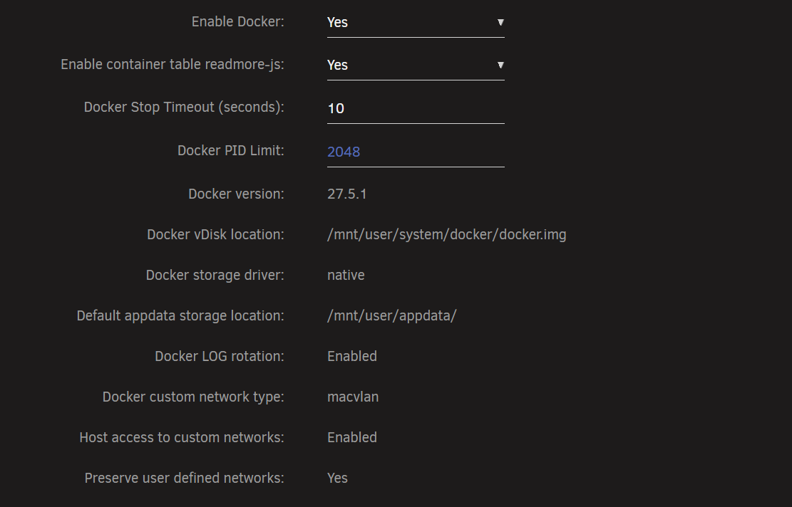

Under docker it's indeed MACVLAN:
With bridging disabled Unraid uses macvtap interface for VMs (in this case bond0.10). This is correctly configured.
For nested VMs it is advised to let the host VM pass the interface as a 'regular' interface (pass thru) to them.

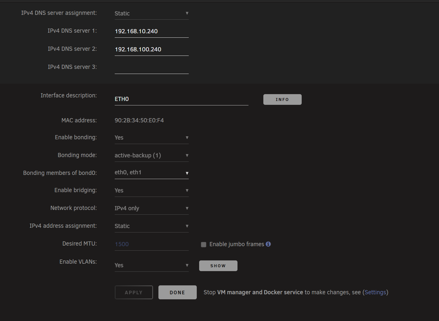

I had to made a modification to the Network configuration for the server since I noticed that Active-Backup was actually missing the 2nd Ethernet card.
So I added the missing one in the bond, and also enabled BRIDGING.
Under Docker I still see MACVLAN:
Is this still a "correct" configuration?
Also you with "pass trough",  you mean that I should attach the "physical" network, and then INSIDE the VM configuring the VLAN Tag?
