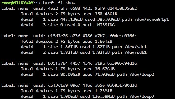

Post the output from
btrfs fi show

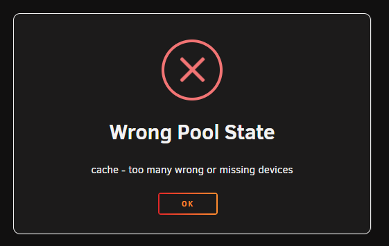

It will not let me start the Array with the second (1TB) device in slot 2 of the pool.
My bad, we have to remove the missing device and reimport the pool, unassign that device, start the array, then type:
btrfs dev remove missing /mnt/cache
Then stop the array and reimport the pool again, same steps as above, but it should now reimport as a single device pool, then add the other device.
I think I understand, but are you saying basically to stop the array, remove the second device, reimport the pool, then...  actually I'm not exactly sure what I am supposed to do.  I don't want to screw this up.  I apologize for the confusion!
I tried just removing the second device and starting the array and it says too many missing or unassigned devices.  I am guessing maybe I have to drop teh number of devices on the pool back down to 1 for now?

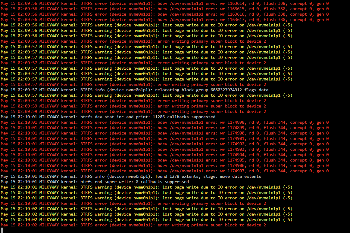

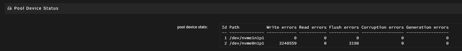

I believe I followed the instructions correctly, and I seemed to get a lot of errors while it was adding the second larger drive.  I have included diagnostics and a screenshot of the cache pool info.  I think it is running the balance now, but I am concerned with all of the errors that I saw when it added the second drive.
Edit: These errors continue to show up in the logs as it runs the balancing operation I think.  The number of write errors under pool device stats continues to go up as well.

The new NVMe device dropped offline, is this a new device?
May 15 02:01:35 MILKYWAY kernel: nvme nvme1: Device not ready; aborting reset, CSTS=0x1
May 15 02:01:35 MILKYWAY kernel: nvme nvme1: Abort status: 0x371
### [PREVIOUS LINE REPEATED 2 TIMES] ###
May 15 02:03:43 MILKYWAY kernel: nvme nvme1: Device not ready; aborting reset, CSTS=0x1
May 15 02:03:43 MILKYWAY kernel: nvme nvme1: Disabling device after reset failure: -19
You can reboot and try again.

Diags are missing some data, post the output from
btrfs fi usage -T /mnt/cache
This is with the 1 drive showing as missing.
Thank you for all of your help!

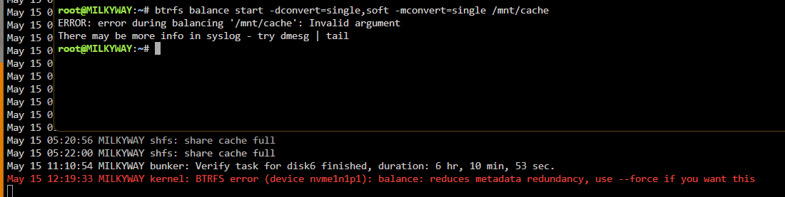

With the array still running type:
btrfs balance start -dconvert=single,soft -mconvert=single /mnt/cache
When that's done, you can remove the missing device with
And then reimport the pool again.
Putting in the first command this is what it says, and this showed up in the logs.  Do I want to force it by adding something?
Yes, forgot about that, use:
btrfs balance start -f -dconvert=single,soft -mconvert=single /mnt/cache
Ok, that worked!  So here is the current state.  The array is started and only the one cache drive is showing up.

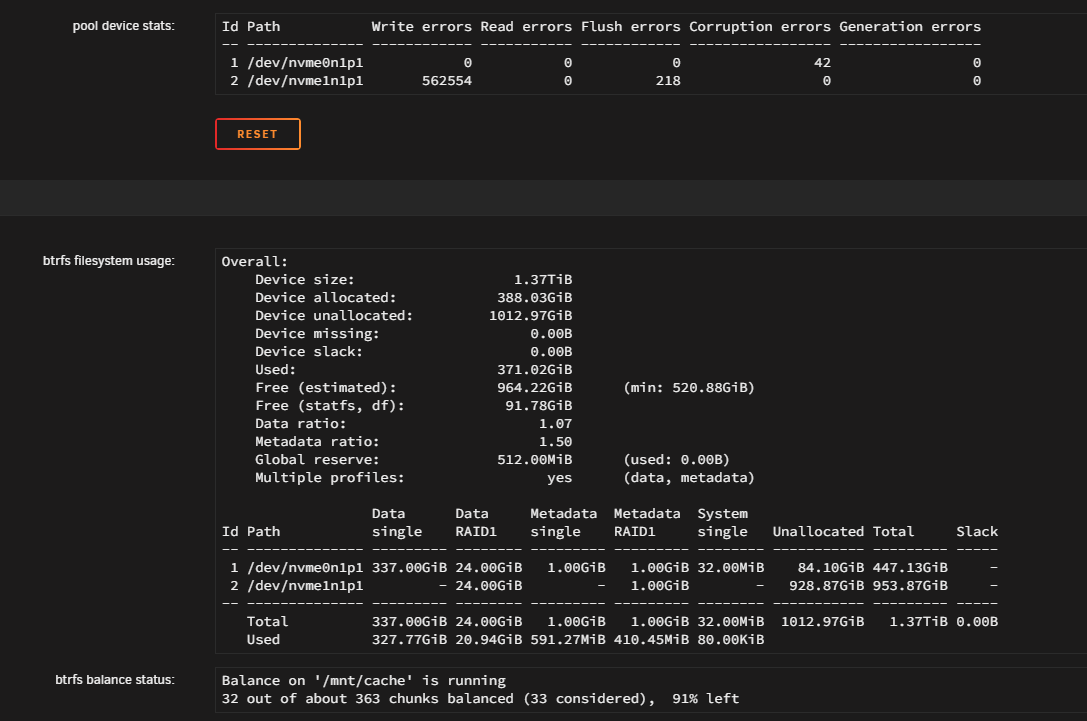

I did this and seem to be getting a lot of write errors in the logs.  It looks like the btrfs process is running on the UI, but tons of errors are going through the logs.  The drive is a brand new drive so I highly doubt it is an issue with the new one.  Although last time I tried this the btrfs process did not really run, so maybe this is what is supposed to happen?
milkyway-diagnostics-20250516-0137.zip
Edited by Rhuarc
The process finished, the stop button is now available.  There were a ton of errors in the logs.  Any way to confirm that the cache pool is correct now and I can start replacing the second drive?
Edit:  This is what is currently showing on the cache pool status.
milkyway-diagnostics-20250516-0211.zip
Edited by Rhuarc
