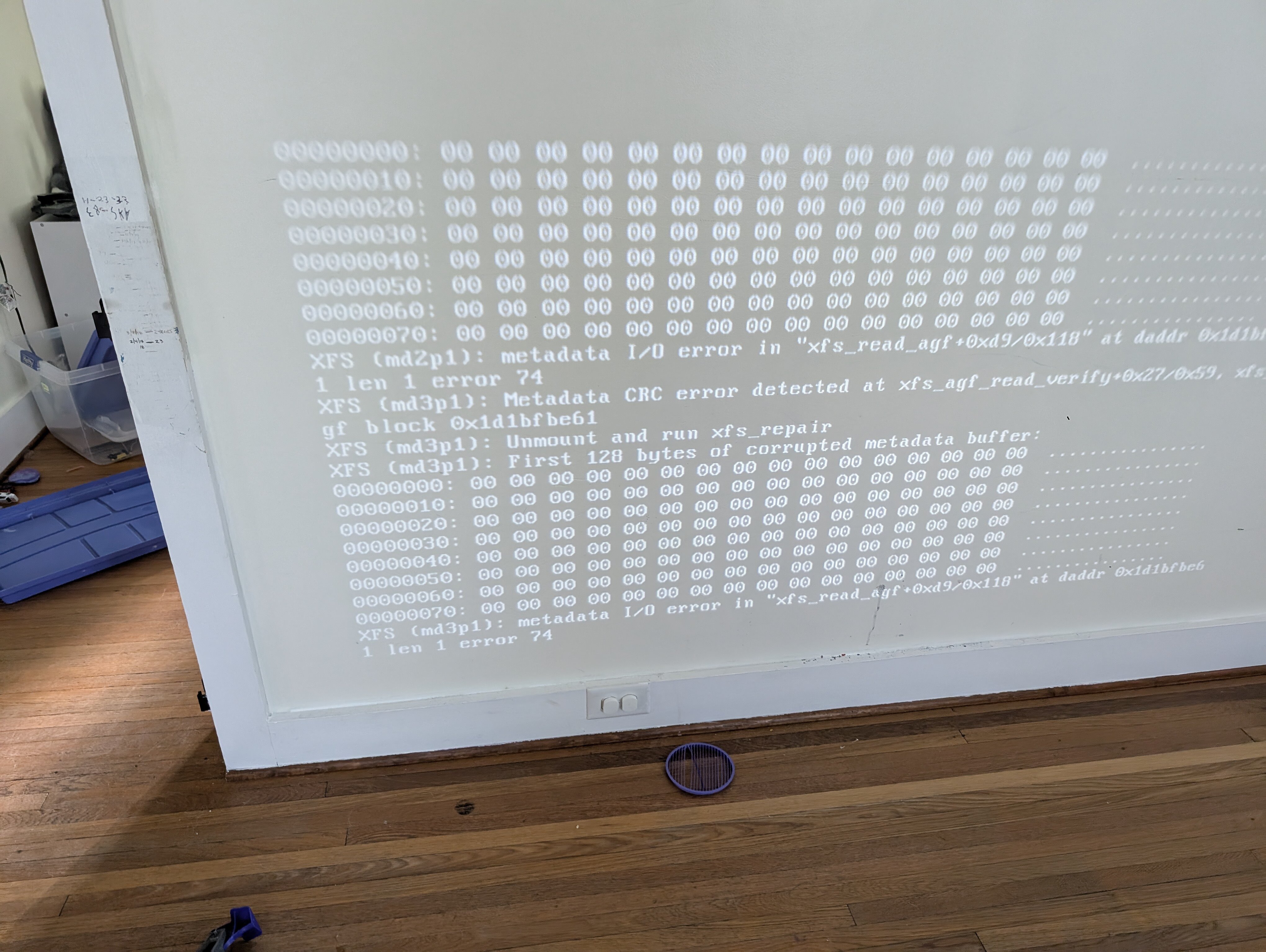

I upgraded hardware and had all sorts of issues with my xfs shares Everytime I reboot. It keeps saying unmountable and I have to maint mode, run xfs-repair to get them mountable. All data is present once I do that.
I think that's the issue with the attached image but I haven't gotten to troubleshooting it

That photo shows that you need to check filesystem on disk2
Looks like disk3 also
That was my assumption also, but I have no reason to believe why?
The server ran for 3-4years without issue, I moved the drives to a new box and this just started happening. Regardless if they are defunct I shall replace them.
I got it back up, moved the data off the failing drives, awaiting parity to finish.
We mentioned filesystem issues, nothing for now suggests a disk problem, but would also need the diagnostics to see that.
