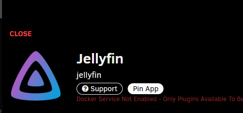

Update: went to install a docker image and the installs are disabled.

Post a screenshot from the docker page showing the not running
Here is the Docker Tab (service not running):
Dashboard (Emby container running):
App installer (no Install button):
Thanks, it's not the first time I've seen this issue, so there may be something in the last update affecting some users at least, I've reported the issue to LT.
