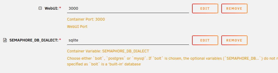

If you are having issues with this container, It's because they dropped support for "bolt" so you have to set the database dialect to sqlite which they replaced bolt with.
No further adjustments needed, sad that it has not been updated.

3. Update the template variables:
SEMAPHORE_DB_DIALECT
sqlite
SEMAPHORE_DB or SEMAPHORE_DB_HOST
/etc/semaphore/database.sqlite (keeps the DB inside the mounted config path)
