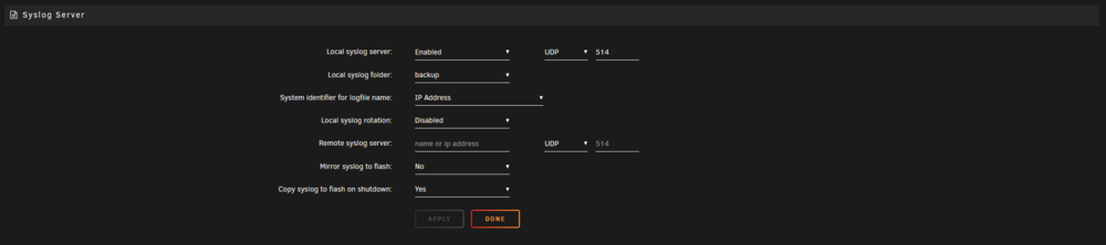

Hm, it seems that one is already enabled (at least it looks like it in the screenshot?)
In the share "backup", which is set as syslog folder, I don't see anything that resembles Logs tho :(
You need to fill up the local server IP in the Remote syslog field, see the instructions.

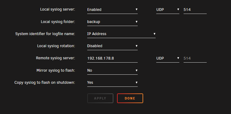

Ok, I have it now setup like this (IP is the local one for the server). Anything else? And where do they get saved then?
To the folder you have specified (‘backup’ in your case).
Ah, now a log-file started appearing there :) really confusing, haha :) but then I'm hopefully settled for the next crash, if it happens.
