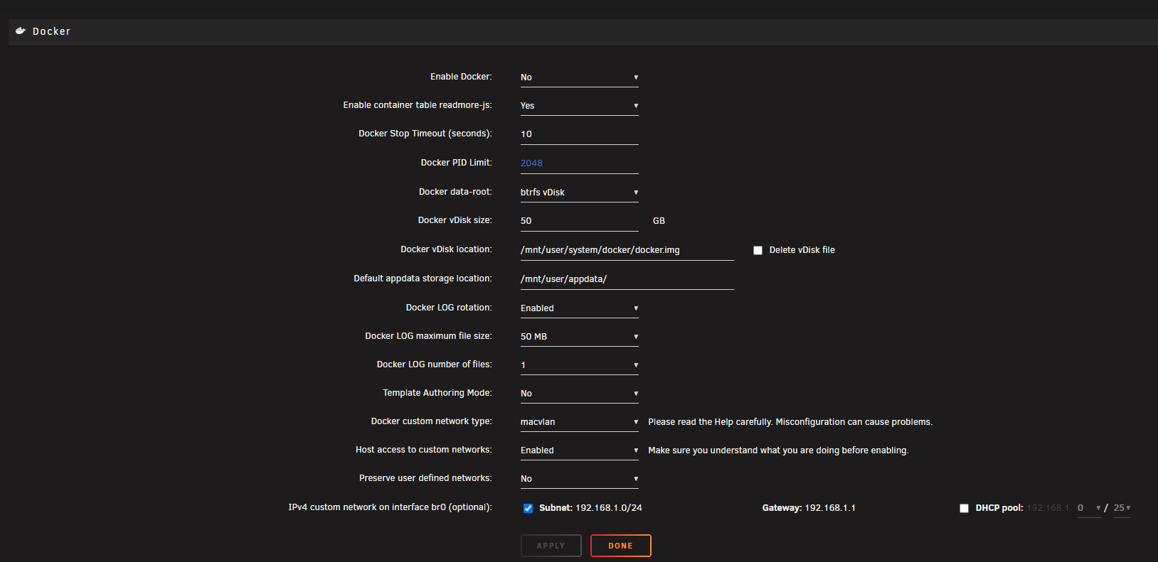

I read some instructions and watched a few videos on Youtube regarding the issue and increased the size of the Docker image to 50GB and rebooted - the same issue happened again.

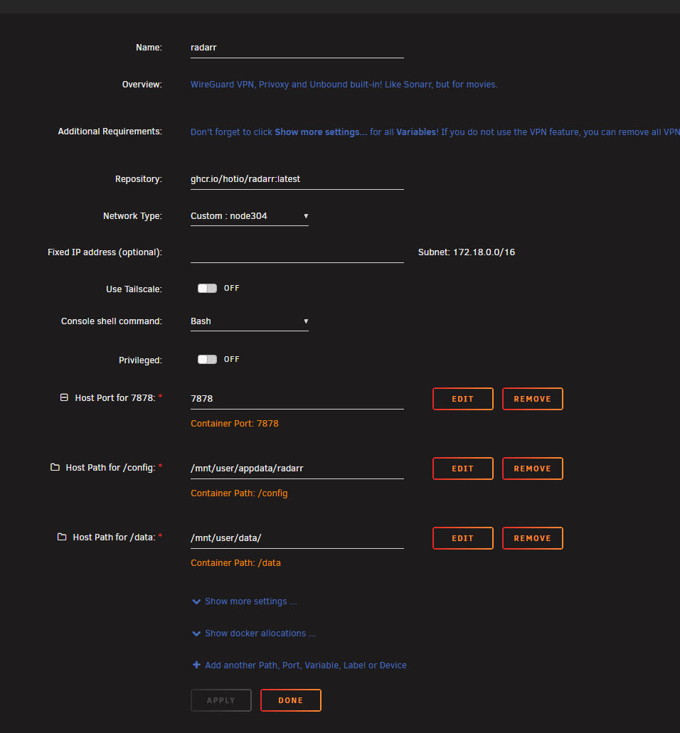

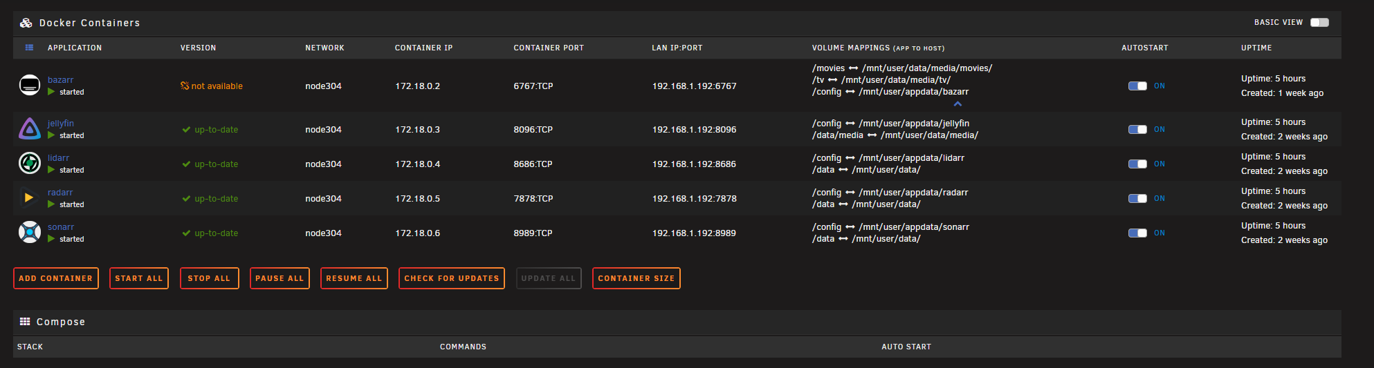

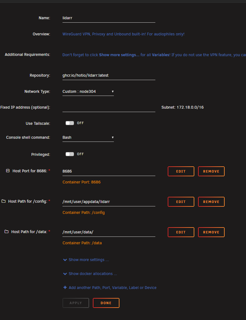

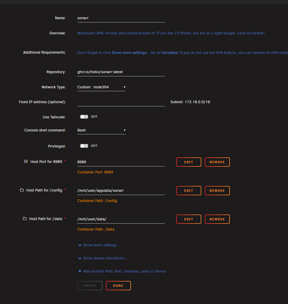

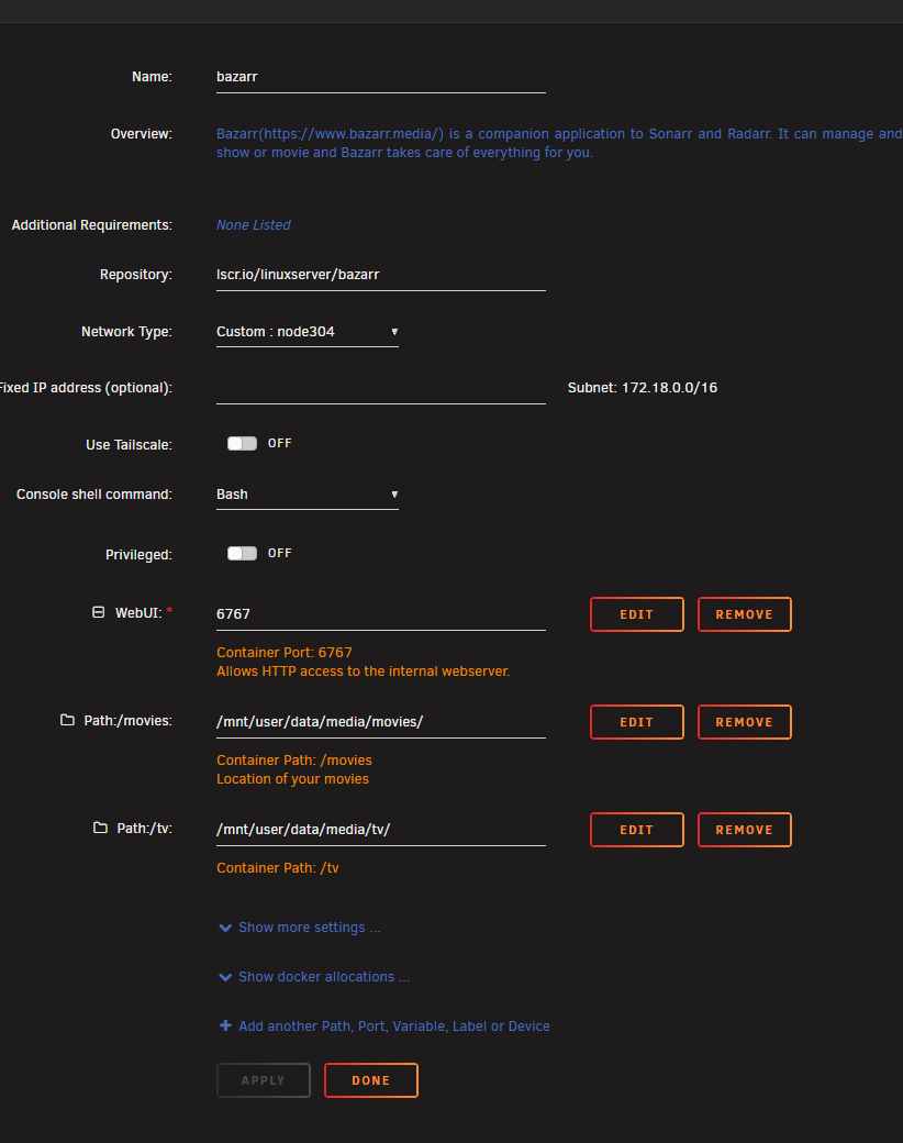

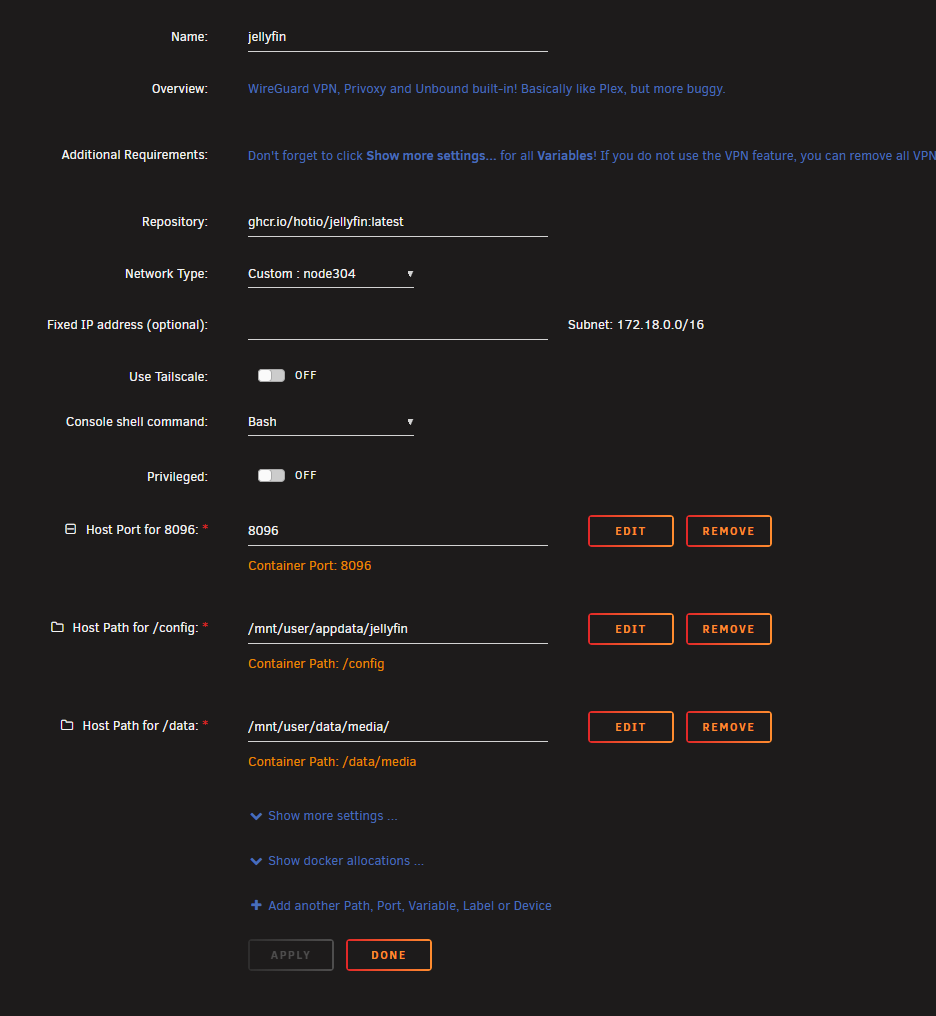

I've attached some screenshots which might be helpful which contain some paths in the containers.

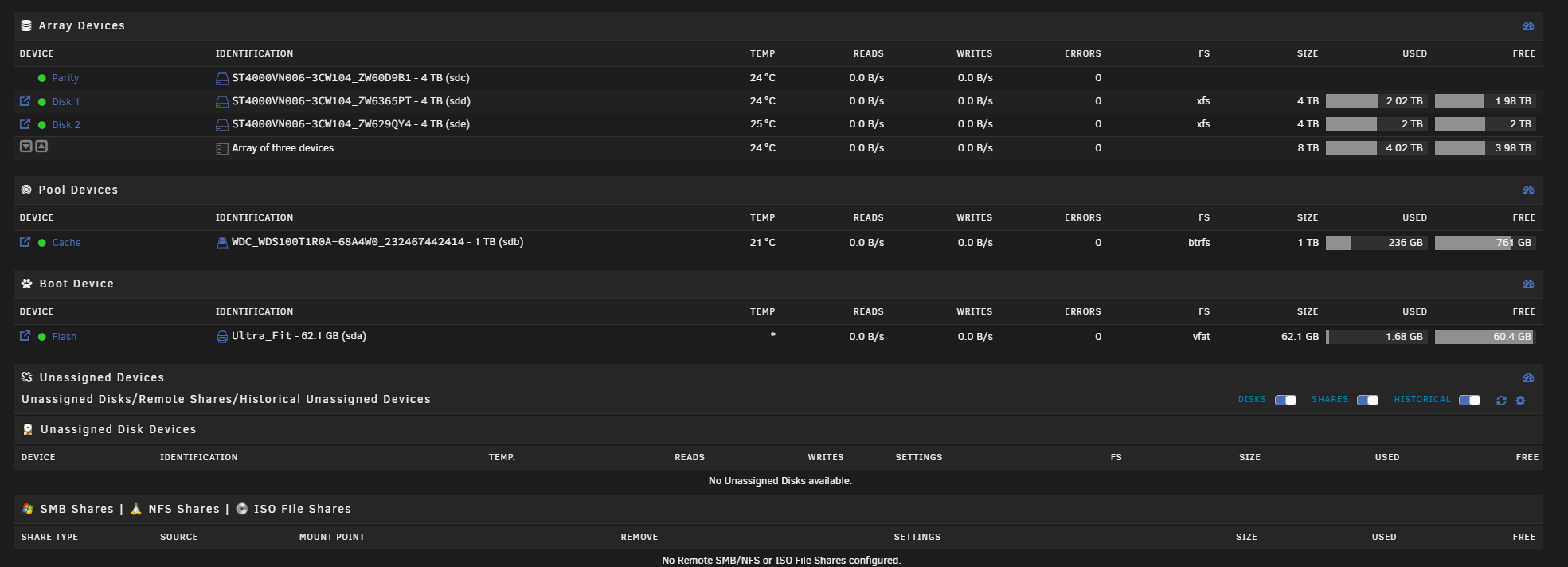

I've got a 1TB WD SSD as the cache drive, I was previously using version 7.0.1. I've attached a screenshot the array as well.

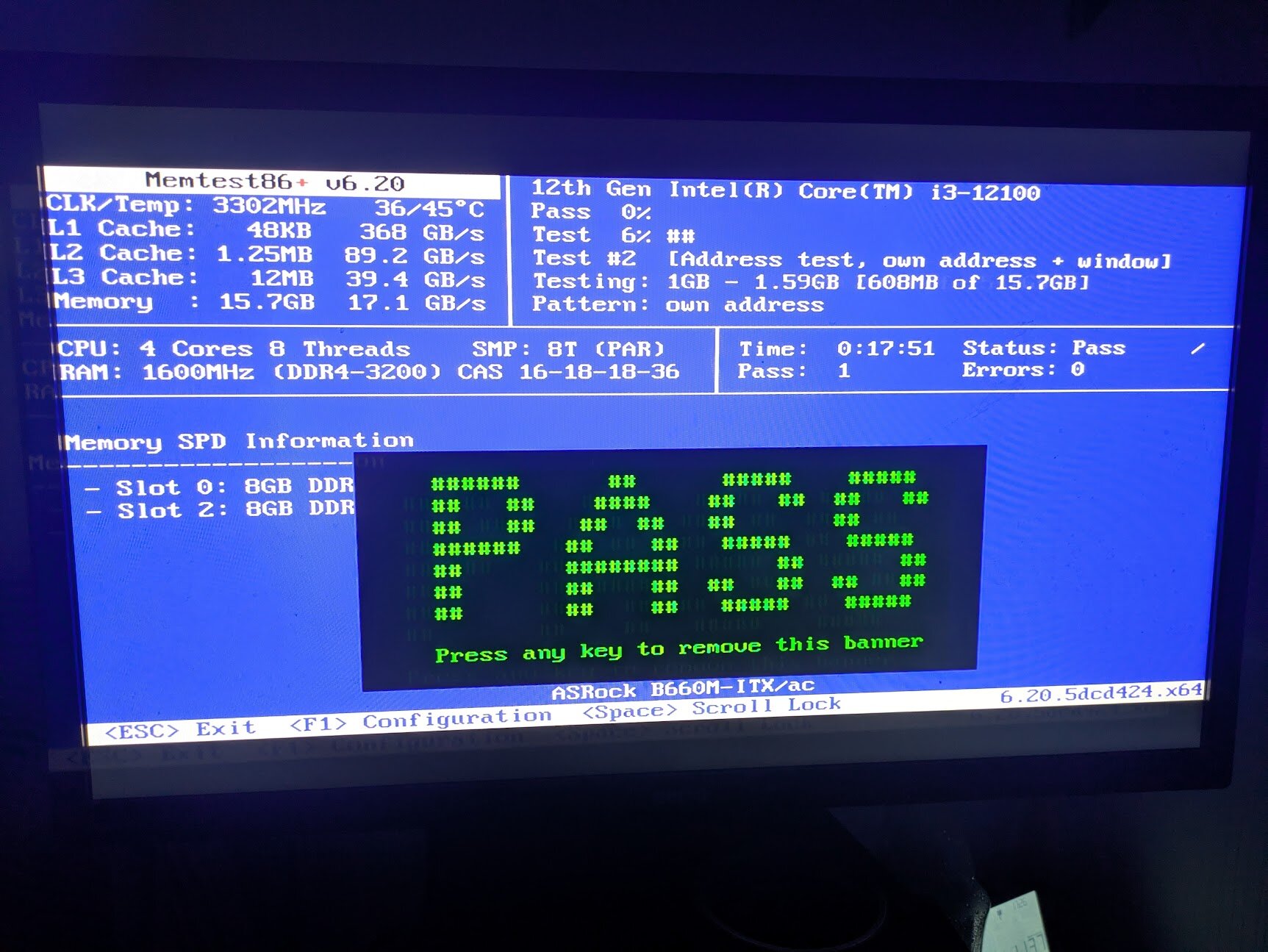

Okay, well I went in an upgraded the Motherboard bios, ran memtest a couple of times and got passes each time.

Since the docker service is technically running at the moment, I've included a screenshot of the volume mappings in case it is helpful. I can't open any of the containers, the web ui's just don't load atm.
