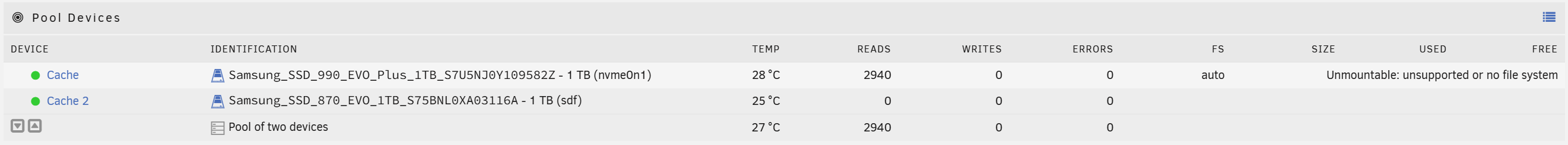

I now have replaced the bad drive with a new one. The old one was a 2 TB SSD and the secondary cache drive was a 1 TB nvme. I have replaced the bad drive with a new 1 TB SSD. Now I have:
Cache is the old Cache 2.
I have also tried to:
  • Remove all disks from the Cache Pool and restarting array with no cache drives and got an "unmatched" warning
  • Deleting the original Pool and creating a new one with two slots...still unmountable

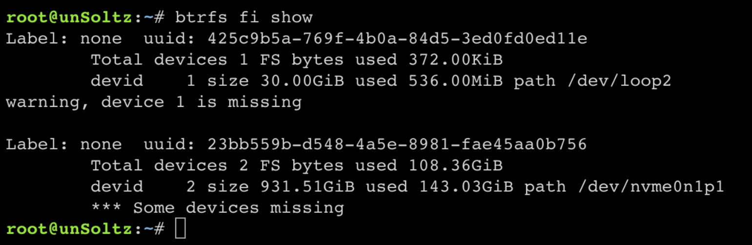

Was the pool btrfs or zfs? If you don't know, post the output from btrfs fi show and zpool import

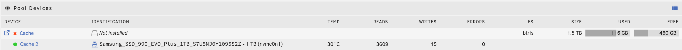

OK, I created a new pool and removed the old one, creating the new pool with one slot and using the nvme drive. It seems to have mounted and and now, for the first time, not seeing the unmountable error. It looks like it is looking for the removed drive:

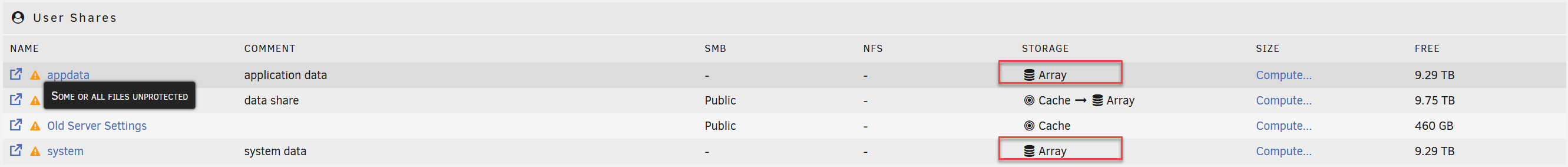

The shares all seem to be back but I am getting an "unprotected" warning:

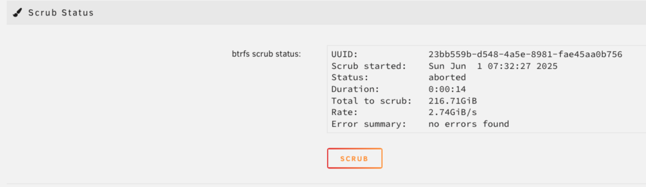

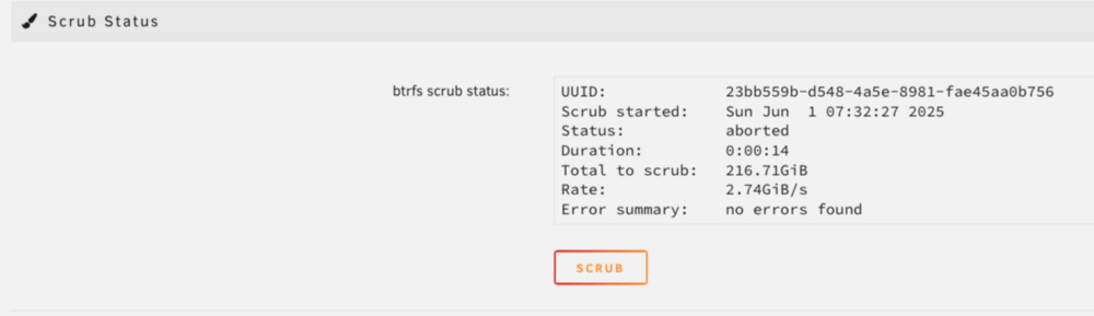

As a first step, scrub the pool and post the results from the GUI.
@JorgeB Results:

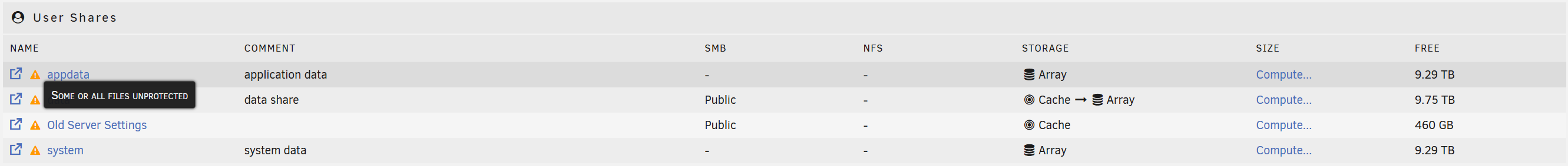

I also noticed that appdata and system are now located on Array?

The scrub is aborting, meaning there are other issues with the pool, I would recommend backing up and recreating it.
