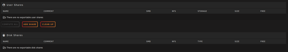

I rebooted the server and the shares didn't get mounted. I put the array in maintenance mode again, ran the xfs_repair, it pointed to log divergences again. I proceed to run xfs_repairwith the -L flag. And got the output in the attached file.
This time, I disabled docker before rebooting. Did the reboot. The array started, the shares were mounted.

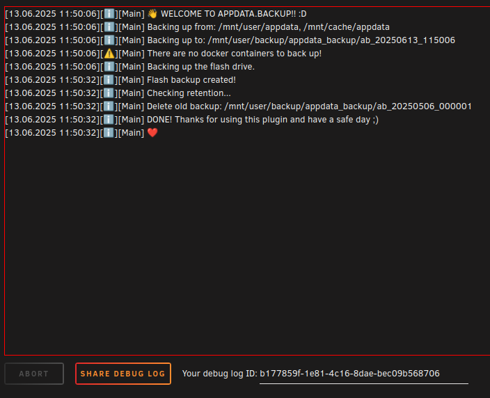

Opened the Settings > User Utilities > Backup/Restore Appdata and started a manual backup:

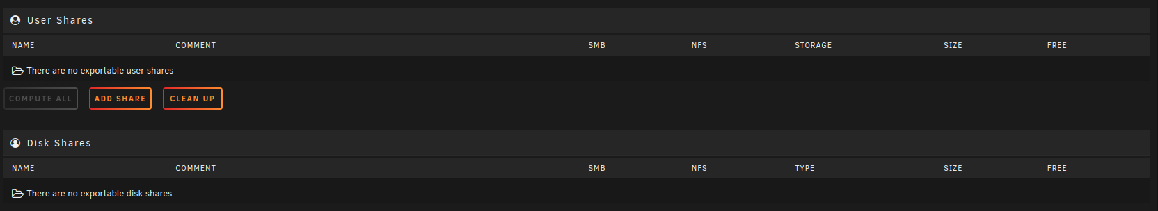

After the backup, I came back to the Shares view and they got unmounted:
Seems to me that the shares break in the first writes to the array. I think maybe some plugin or script is misbehaving and affecting the shares links? I will be grateful for any help on diagnosing this. Thanks.
