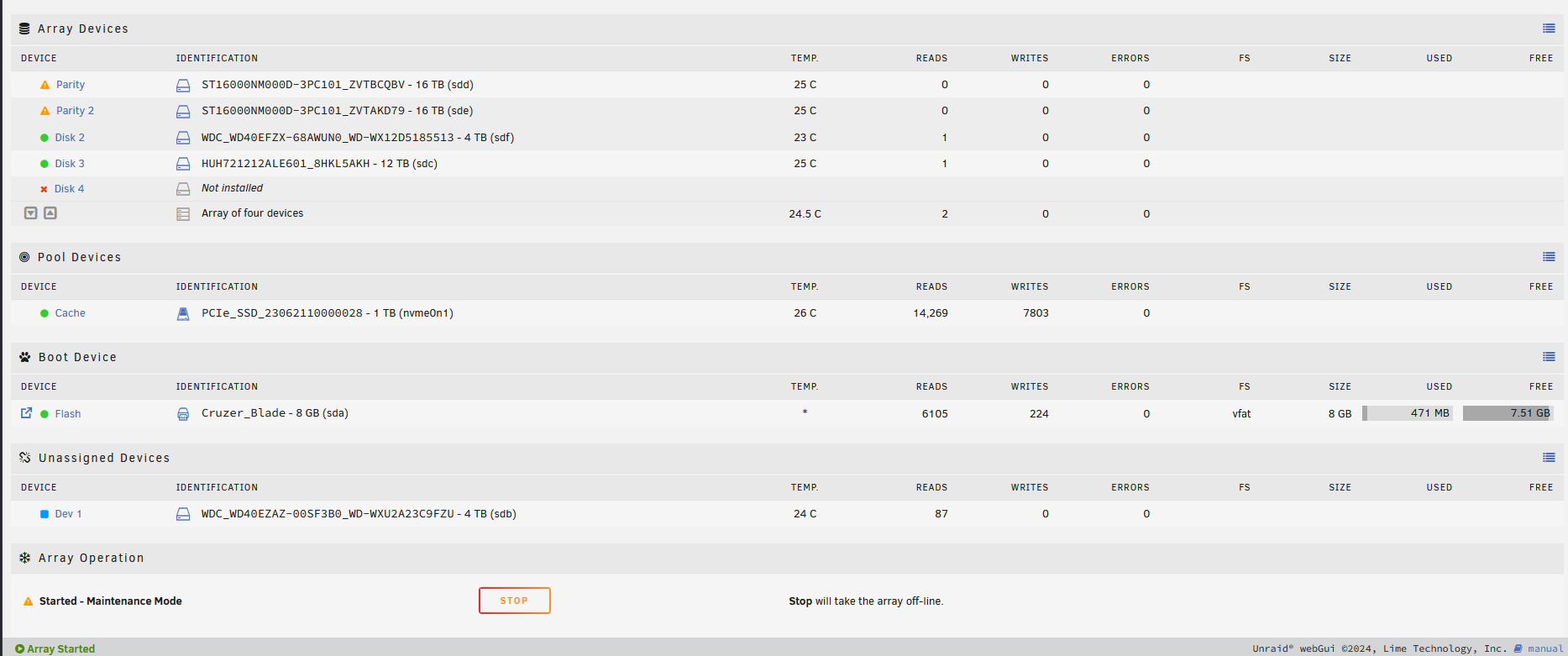

Post a screenshot of main.

Screenshot of main attached.

There are 3 invalid disks, hence why the emulated disk4 cannot be checked, I assume this was disk 4?
If yes, install the UD plugin and see if it mounts with it.
Correct, that is disk 4.
